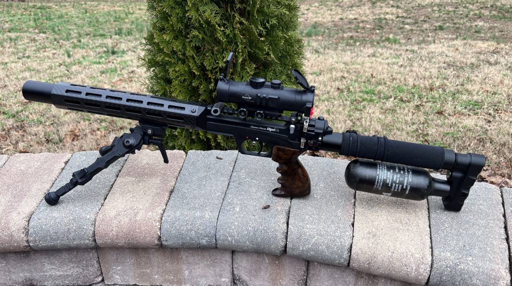

The 350mm barrel is definitely the way to go, especially if noise is a concern. I find the Ronin to be a very large silencer, and it does make the gun longer. I purchased mine from Edgun West with a Huma Mod40 and the short aluminum handguard. The advantage to the Huma Mod40, along with it being quiet, is that it is modular, and so one can swap out the modules, tailoring the length of the gun and the amount of suppression to get what you want.
I initially had some pellet clipping issues with my DonnyFL expansion chamber with the ronin,
I wonder if your DonnyFL is defective. I assume they are CNC. Maybe it’s slightly out of tolerance. In the installation video, it said to look through the barrel from back to see if any of the edges occlude the view. Have you tried that to check for alignment?

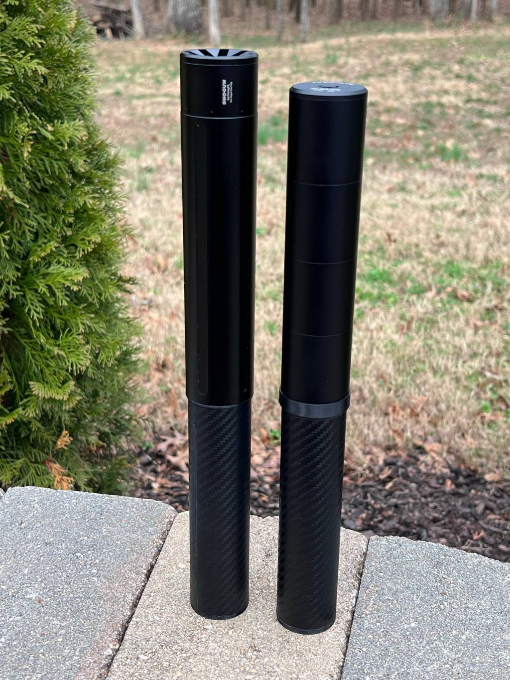

Jack Kwan makes blowback shrouds that are an expansion chamber and an air stripper. He has models designed specifically for the Huma or Donny moderators. I like the carbon handguard, so I have tested both the Huma and Donny versions that fit in the handguard (Mod40 and Shogun). Both are quite good. I personally prefer the Huma.
How does Jack's shroud attach?
I ended up buying barrels and cylinders for both .22 and .30 in both 250mm and 350mm. .22 for plinking and getting use to the gun mostly in my back yard. .30 for using the rife as a more effective tool. Quiet is very important to me in both cases.
For .22, I found the 250 barrel with 250 moderator and the short Silent Thunder Ordnance (STO) insert was perfect for plinking in the backyard. With the regulator set at 100 BAR, it is more than quiet enough to not concern the neighbors. I get about 5-6 mags between refills on a 350cc tank and .22 ammo is cheap and available. Expect quarter size patterns at 25 yards with this setup.
The shroud slips over the barrel and is sealed via an oring to the barrel. The forward portion of the shroud threads onto the 14mm threads of the barrel.
