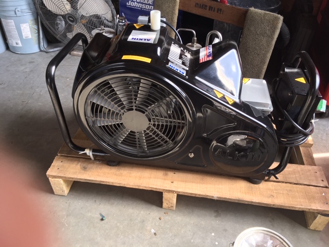

I sold my AV and Tuxing Compressors and a few other items and got an Alkin W31. It is a dedicated dive quality air compressor and will top a 100 liter bottle in 6 minutes from 2500 PSI to 4500 PSI. Air Cooled and can run from freezing temps up to over 100 degrees F. I use mine to keep my 900 plus cu/ft cylinder bank fill station ready to go.
I would at least get a $2500 Coltri MCH6 or the $3000 Alkin based on reliability. Anything cheaper it would only be a pair of Yong Hengs one for a spare both from Wal-Mart with 4 year extended warranties and nothing else.

If wifey is offering to pay for half, go with the suggestions on the Alkin. If you’re the type that takes a mile if handed an inch, get the vertical model, too, lol. If not, the horizontal model will suffice as a few hundred less. Regardless, that compressor will outlive you and provide you endless, worry free fill ups and whoever it gets handed down to.

If you can spend $2,000 the best current option is a Daystate LC-110. At $1000 the best compressor option is an Air Venturi EC-3000 sold by Pyramyd Air and Airgun Depot. For $2500 the best compressor is the Coltri MCH-6. For $3100 the best value is the Alkin W31.
