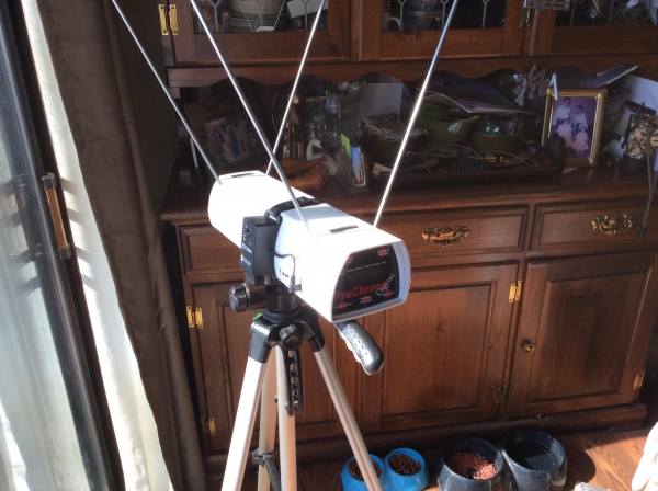

My ProChrono arrived last night after I had left for work, so when I got in this morning I unboxed everything and checked it out. All was good except the light kit had no AC adapter or wiring harness, I already contacted Amazon and have a return label printed and a replacement should be on it's way soon.

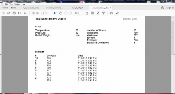

When I got up today I discovered I had no batteries (I think my wife hides them from me) so off to town to pick some up. After returning I installed batteries in the digital Link and in the chrono and powered them up along with my Kindle that I had already installed the necessary app on. It only took a minute or so for everything to pair and another couple minutes configuring the app. Since I don't have a tripod yet I just set the unit on the handrail of my porch and shot from about three feet away. Out of 50 or so shots there were two errors and they were my fault, I was shooting too low.
So far I'm pleased, it's easy to set up, seems to have a pretty large shooting window and the app is easy to use. I shot four strings using my RWS 34 with a Vortek kit in .177. The four strings were named and e mailed to my self, then saved in a folder with all of my other information on the 34. My initial impression is good, but the jury will be out until next summer when I can put it to good use. I have loads to develop for my 260 and I'm curious how fast my 22-250 is pushing it's favorite bullet.
