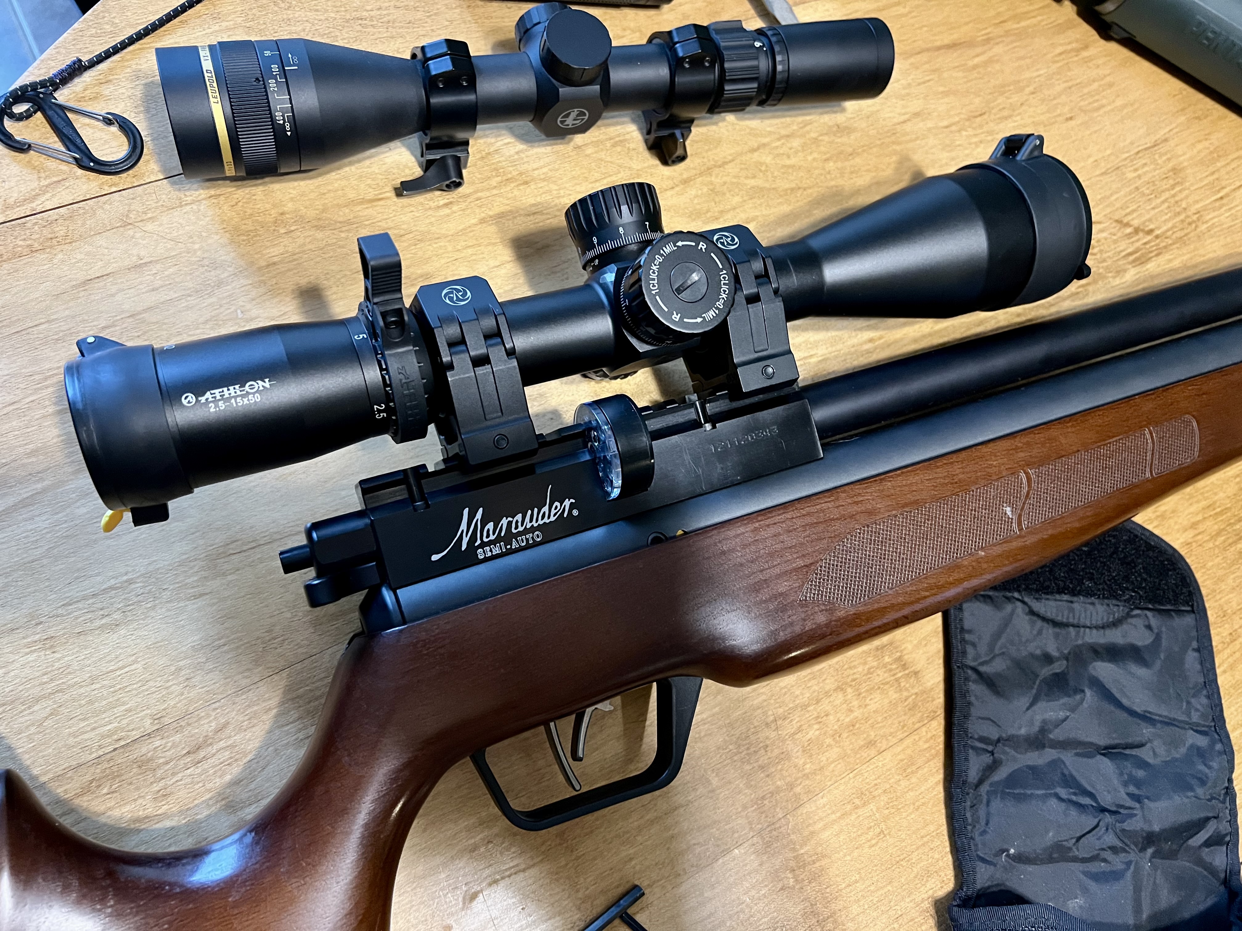

I have a Benjamin Marauder SAM .22 shooting 16gr pellets at 800fps. I want to effectively kill ground squirrels out to 100-125yds. Will a .25 cal Marauder do it better, or stick with the .22?

I got a 2-12 Helos, but the center dot too big for these little critters. Can you believe the FOV of the Leupold 3-9X33 Freedom air scope is bigger than the Athlon Ares!?
The dot is too big, must be closer to 100 yards?
