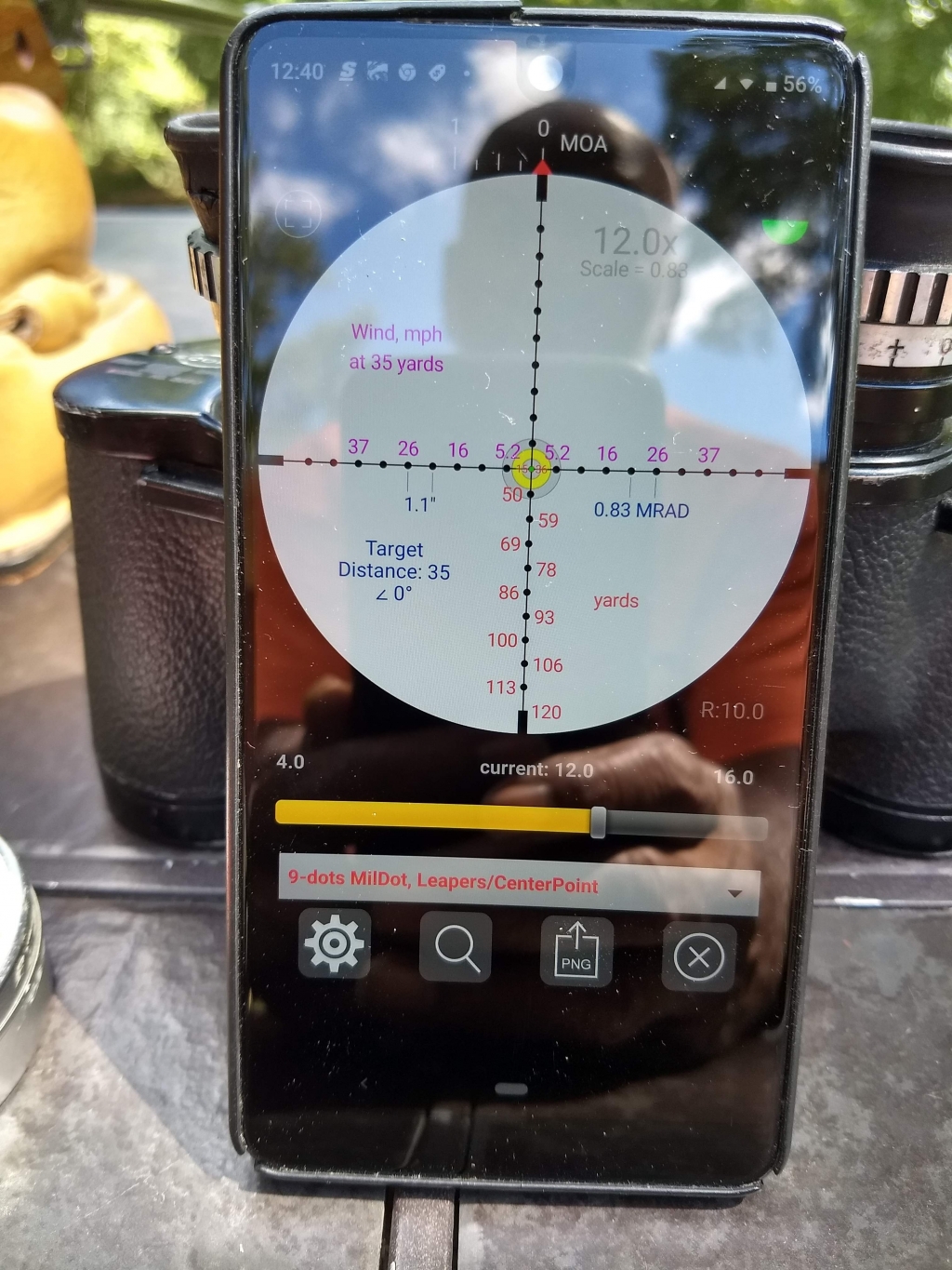

Mike (Centercut) helped me yesterday with StrelokPro while hunting and what a great app. Takes maybe 5 minutes to set up each rifle as long as you know FPS and scope height. We were shooting up hill and it also calibrates for that. Either click the turret or look at the retinal picture showing hold over.
