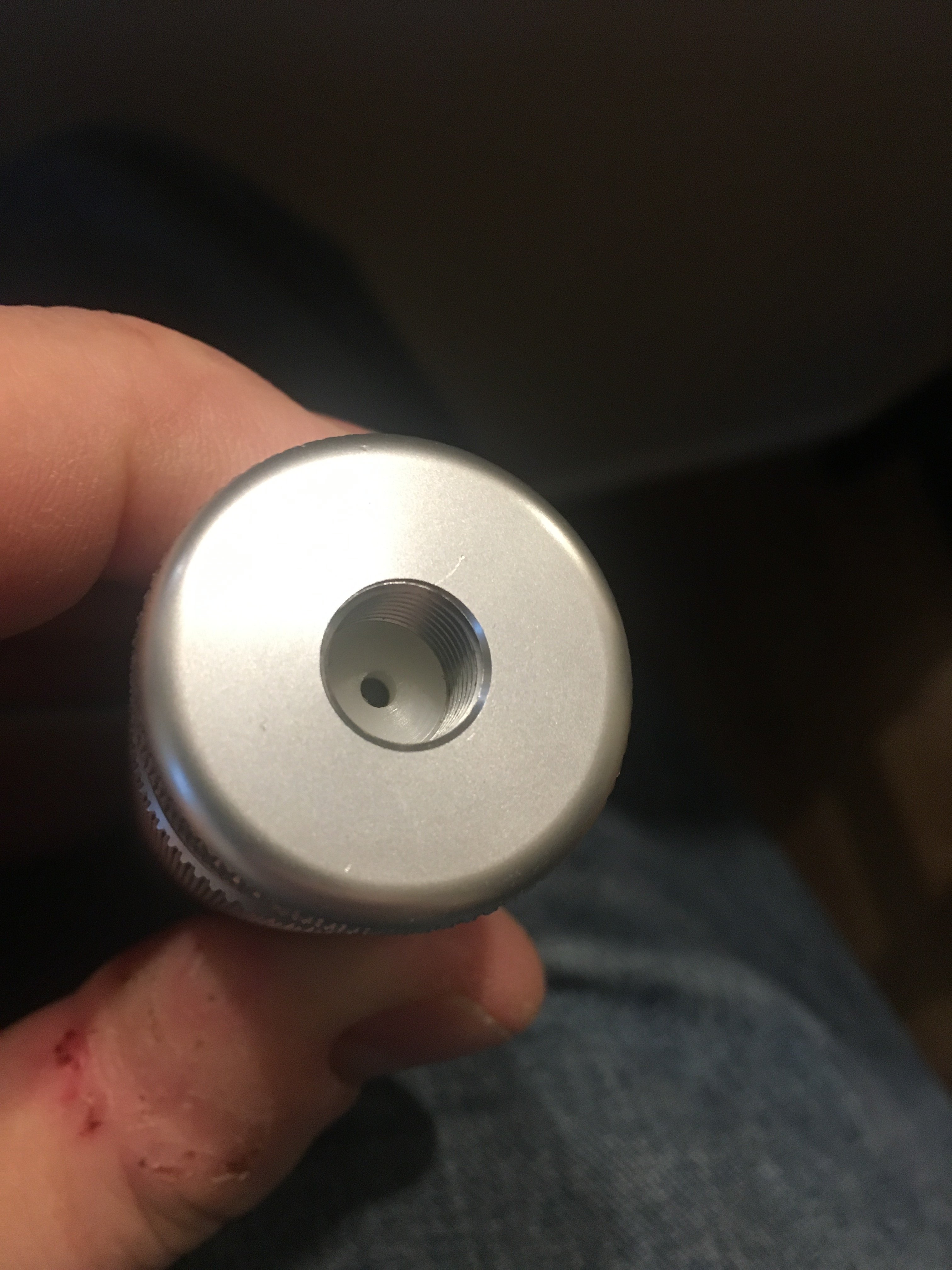

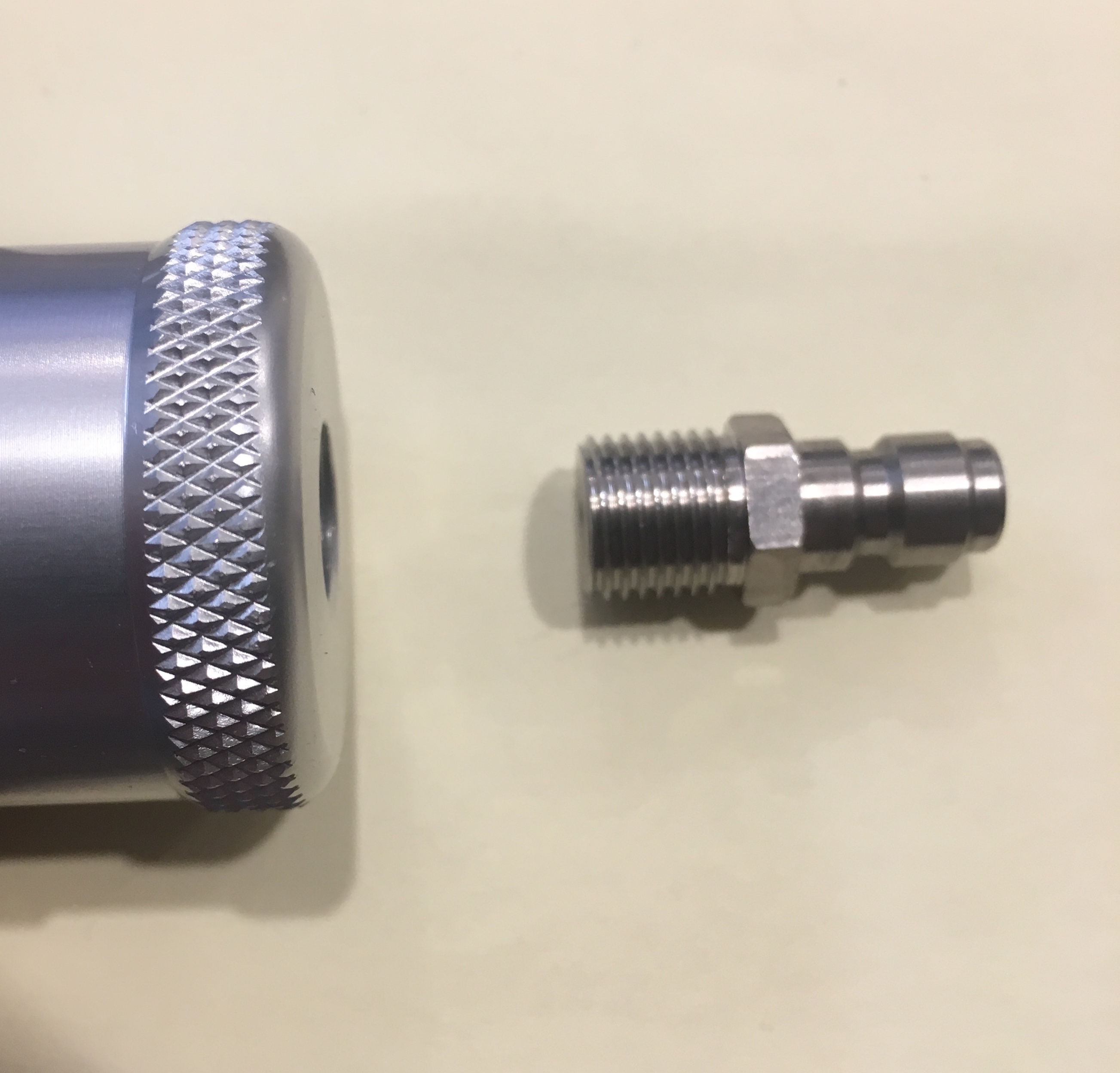

Where to buy male Foster?
Huma air has one too. Has an oring and a screw inside to control airflow in either direction if desired. I’m positive it can be removed completely.

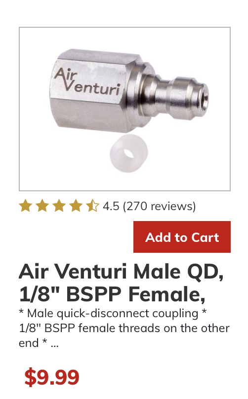

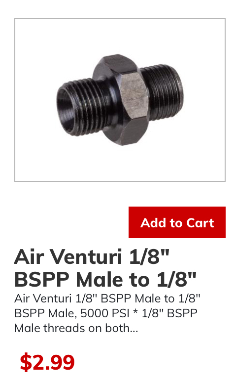

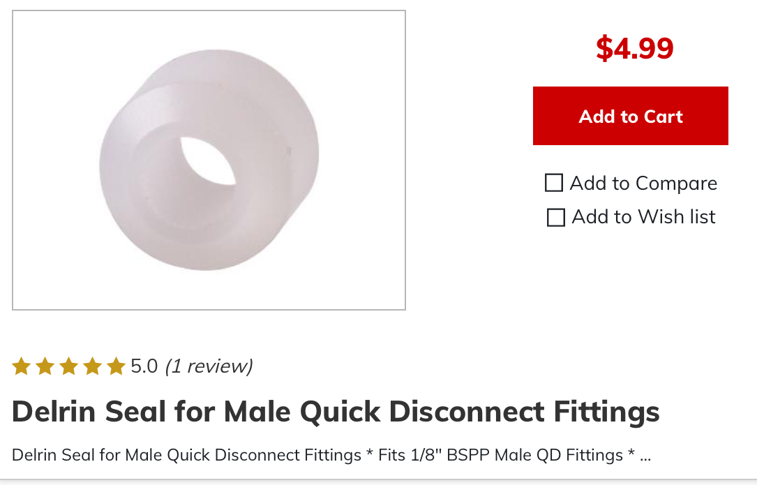

PA sells a double male BSPP that you could use with the foster that has the female BSPP. IT’s only $2.99 but it’s going to be longer than just a foster x male BSPP once assembled. You will need the little delrin gaskets on each side, they’re $5 each (rip off).

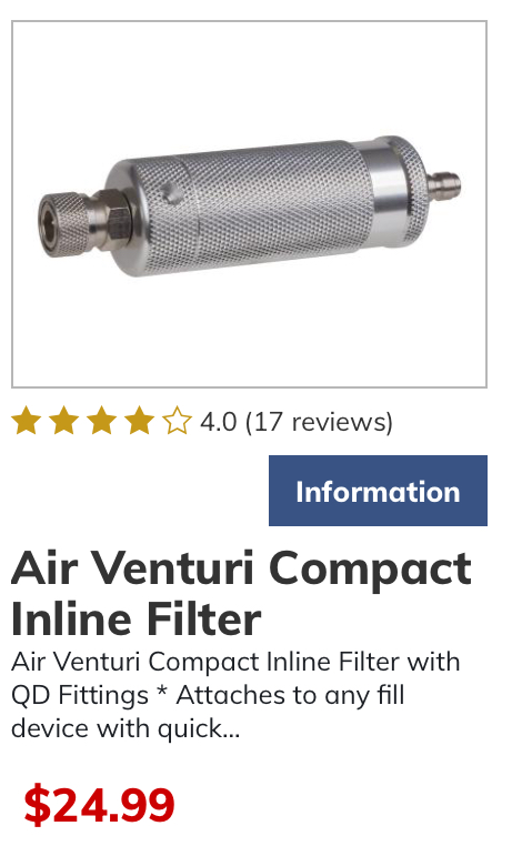

Or, you can buy a Air Venturi Compact Inline Filter. It has a male foster with 1/8BSPP male on it. I know, I have one and unscrewed it to see. It will have the delrin gasket in it but it way not come out once it’s crushed to make the seal when it was assembled. $30, plus maybe a delrin gasket ($5). But it will give you the fitting you need.
I like to use the minimum amount of fittings. Fewer joints, fewer possible leak paths, so personally I would go the AV inline filter route. But of course is up to you and your budget. Who knows, maybe PA can get one from AV since they’re the same ownership.
