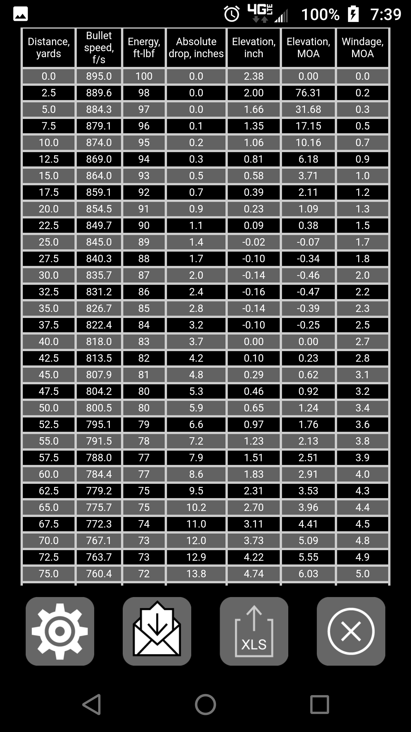

This is my newest dope chart from Strelok Pro app for the ZAN 56 grain pellets that shows my 40 yard zero. It is also has a second zero at 24 yards, and in between at 32.5 yards has half a pellet's thickness of hold under. This yardage works great for hunting in the woods, and is close to what zero I would use if in a Field Target competition because it creates a long trajectory window where ranging error misses are smaller. Keep in mind that shooting pellets slower would create a more arcing trajectory and that is why a lot of guy's have a slightly closer zero yardage to achieve the same results.
