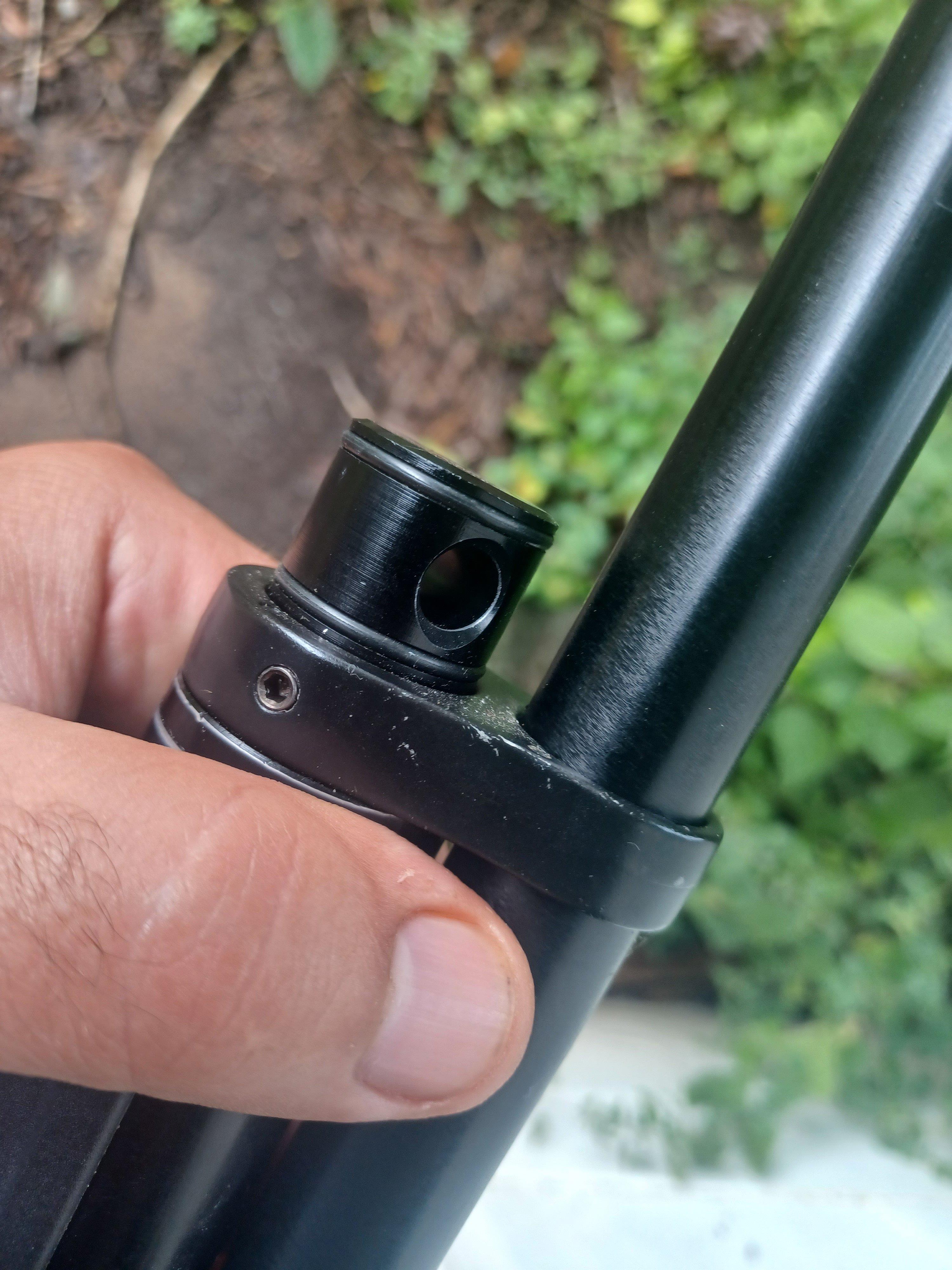

Dust cap covers the fill port and is longer on the NP03 than the guns that use a band. You remove the dust cover on all the tube guns to access the band. The bottom of the band is the same size as the fill port with the dust cover removed and mounted behind it. Your dust cover has to be shortened in order to work on the NP03.

Dust cap covers the fill port and is longer on the NP03 than the guns that use a band. You remove the dust cover on all the tube guns to access the band. The bottom of the band is the same size as the fill port with the dust cover removed and mounted behind it. Your dust cover has to be shortened in order to work on the NP03. View attachment 286276
Thank you Troy, much appreciated! I will need to 3D print myself or have it 3D printed. As it is a new gun, and I'm loving it, I don't want to subtract any parts from the gun yet.

The factory barrel band is appropriately sized with an internal orings on the barrel retaining side and uses two set screws for the band. I think it's a much better option over a 3D printed version. With the shortened dust cover you still have full functionality and it's anodised aluminum and much stronger.
hi Troy, yes, it seems the factory barrel band would be much better for function, quality and and look than any 3D printed bands. I can not seem to find anyone who sells a shortened dust cap, and I have no access to a lathe. Do you sell it by any chance?
Also is the function of the dust cap purely to keep dirt out of the fill hole? If so, could I use a 9mm rubber plug instead of the dust cap (it would look pretty ugly though).
