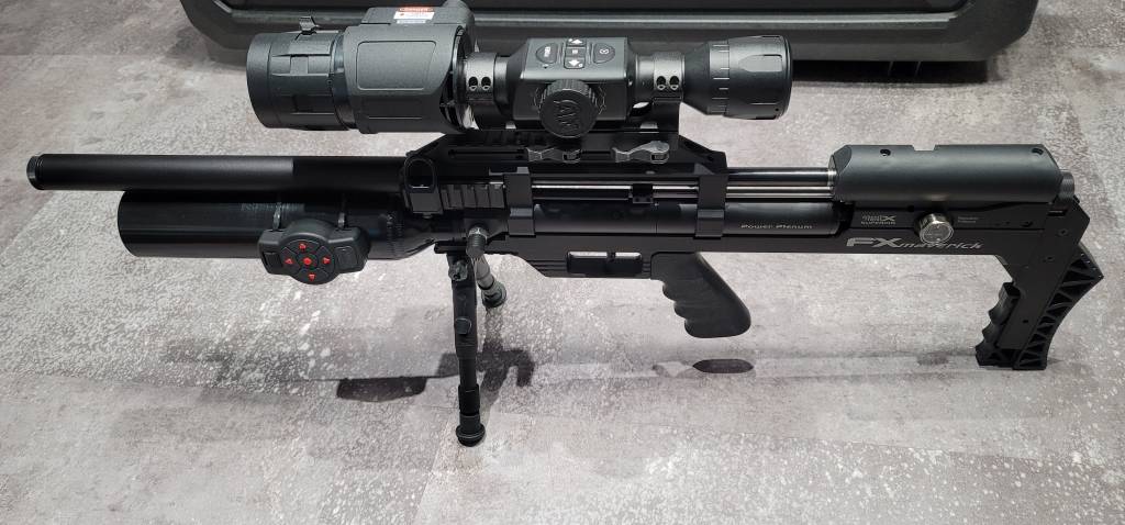

I want to add Magpul connector to my Maverick so I can add a sling for a safari style carry option. I can add a Magpul pic rail adapter onto the side front rail (or just run the current loop hook I have in place now), but what can I do towards the rear of the gun?

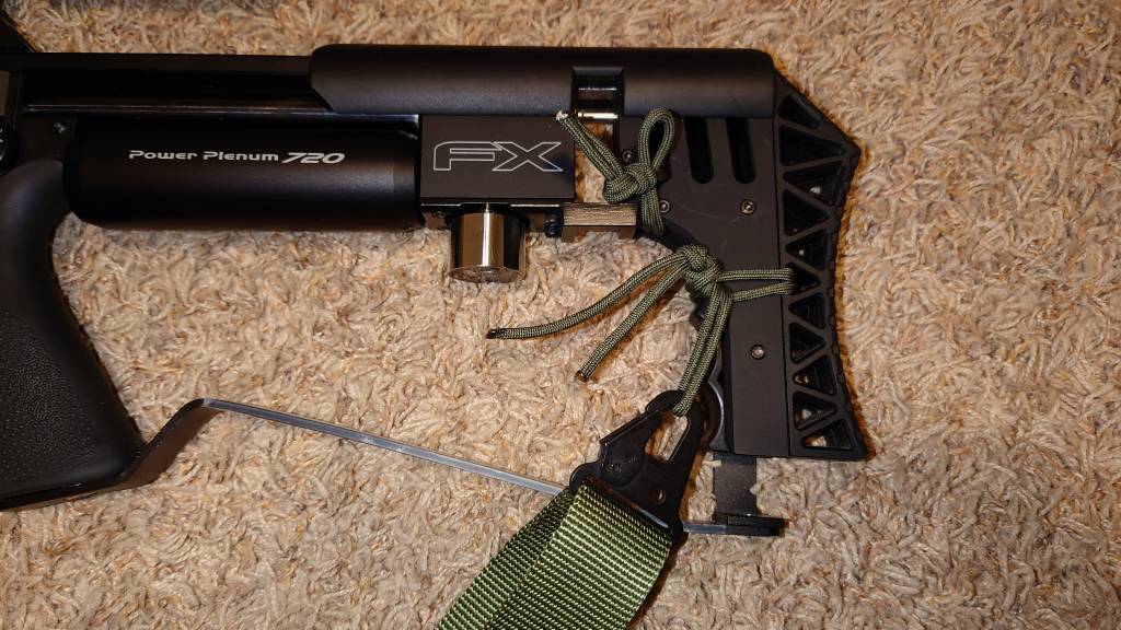

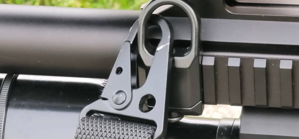

I did some 2 point sling experimenting on my M3 and you are correct in your analysis. The best mounting points are going to be along the centerline of the gun (high), but using a high/low combo may work. For the impact front mount I am using an M-lok QD installed on the side of a Saber tactical ARCA rail. This puts the front mount at the bottom of the bottle (low). When I combined that low front mount, with a QD socket installed via the buttpad lock screw in the rear (low), the gun was pretty 'floppy'. I then threaded some paracord through the rear side plate slots in the M3 and mounted the rear of the sling this way (high-ish). That combo was ok. Considering you are using the Maverick front/side rail for your front mount (high), you may be able to get away with using the buttpad screw hole to mount a QD socket. Other than that, it looks like you would have to use one of those other two screws up top, or drill and tap the rear area some where. I don't see any convenient places to thread a paracord loop through which is the easiest cheat for sling mounting.

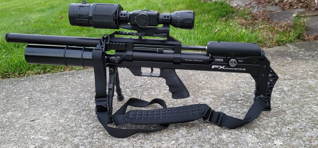

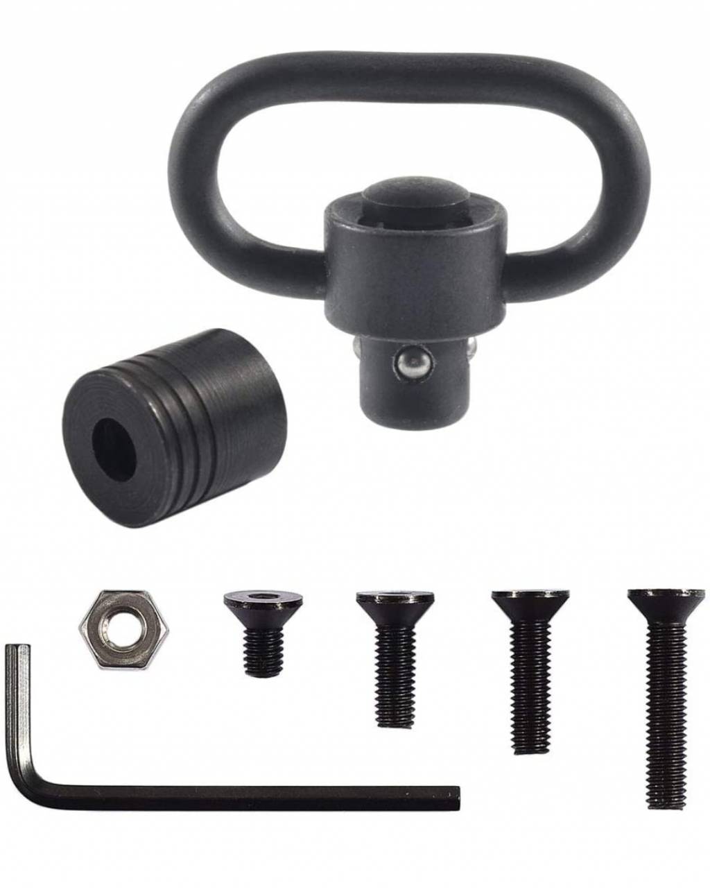

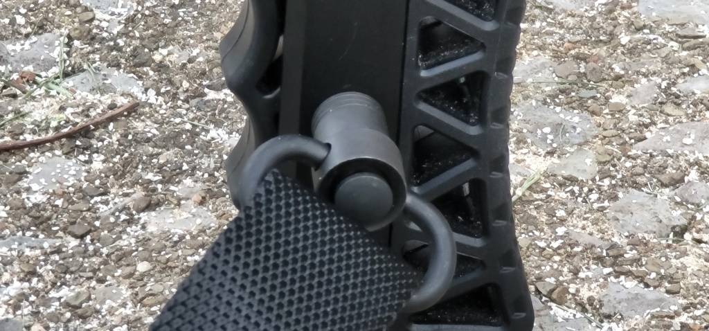

I bought the same QD socket shown in your picture and ended up using a Magpul QD socket instead for the buttpad mount. The reason is that the QD sockets are all designed for inch #10 screws and doing this mod involves using M5 screws. The Magpul socket is designed around a button head #10 screw, and an M5 button head screw drops right in. The other QD socket in your picture uses a special flat-head #10 screw that doesn't allow for an easy metric drop-in replacement.
The Magpul QD socket part number is MAG333 (Type 1)
The screw you'll need is a button-head M5x30mm or M5x35mm depending on what nut you want to use. You are going to install the new screw in reverse from factory direction, and then add a nut on the opposite side.
