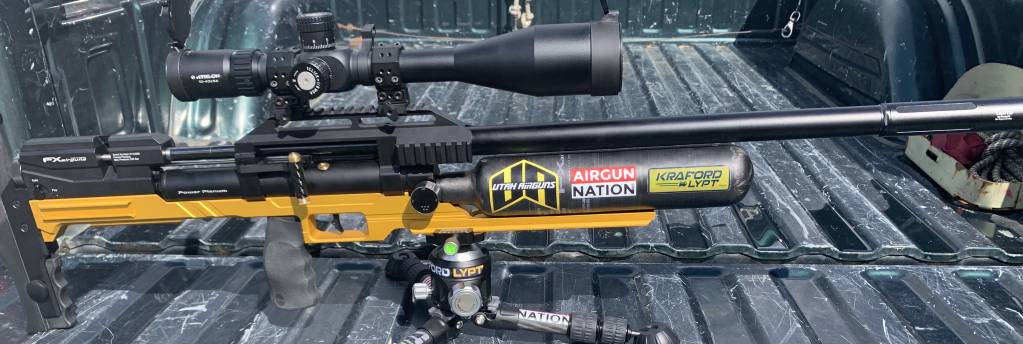

I've yet to see the "slug tuning kit" that FX listed in their power figures, but you don't really need it, if you're resourceful and have no problems doing things yourself. The two things you can get right now are the Huma V2 barrel port and regulators which will allow a much higher set point. I've seen contrasting specs on those regs. Some say the high pressure Huma regs are rated at 135-210 bar, and I think Huma's site says 135-200 bar. Extra pressure is always a good thing, if going for big power. I feel like the guns can do what FX claims though.
So far, I got my .30 Compact up to 96 fpe with 160 bar reg setting and 63 grain slugs. That was with me modifying the factory barrel port and probe a little. Oh, and I changed out the hammer weight with one that was little heavier. The factory weight was 11.4g and the one I put in there is 13.4g, but I don't think it really needed it. I also just finished machining an Alfa Precisioin .177 barrel(635mm) and pin probe for it, and I got it up to 47 fpe with 24 grain slugs. I will be able to let you know what the power potential is in .22 and .30 with the 700mm barrels in a few days. I have the Huma regs and V2 barrel ports in route as well I'm very curious to see what that .30 can do with some more barrel, and maybe a little higher set point on the Huma regs.

Interesting that your .30 Maverick compact came with the 11.4g .25 hammer. My .30 MK3 Snipper came with the 13.4g and shoots the 44.75 @145bar / 98fpe with the Huma reg. My .22 Maverick sniper came with the 9g hammer.
I have the ER .30 dual TP to install soon as well. Have the ER .22 TP in the Maverick and it is fantastic. I will forgo any "FX pin probe" as I have tried them (Nielsen/FX) in the Impact. Not worth the pellet/slug hassle adjustments, just mod your current probe and it will be as good. Try the heavier hammer I say and adjust to your liking.
