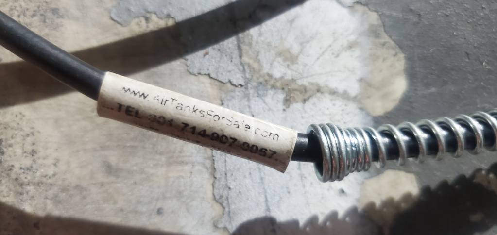

Well i had to know on mine... lol
Its a Joe B hose. As you can almost read the airtanksforsale.com

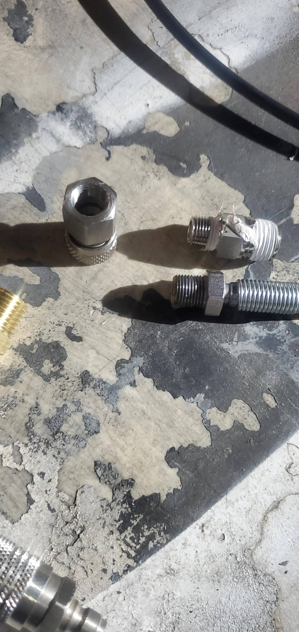

It has some type of threads tape so I do not think it is parallel thread and would not have a oring so probably some type of pipe.
So removed it. Boy is it tight.
it matches with one of my 1/8 npt fitting.

FYI, whenever a fitting is sealed with teflon tape it indicates that it is tapered. 1/8 NPT is the thread on the microbore hose shown. That photo of the male adapter with teflon tape is a 1/8-1/4 NPT adapter. M10*1 female threaded quick connects are parallel threaded and usually include a white plastic seal that goes between the hose and the quick connect to seal. Most BSP fittings are also parallel threaded and typically seal with a dowty washer.
