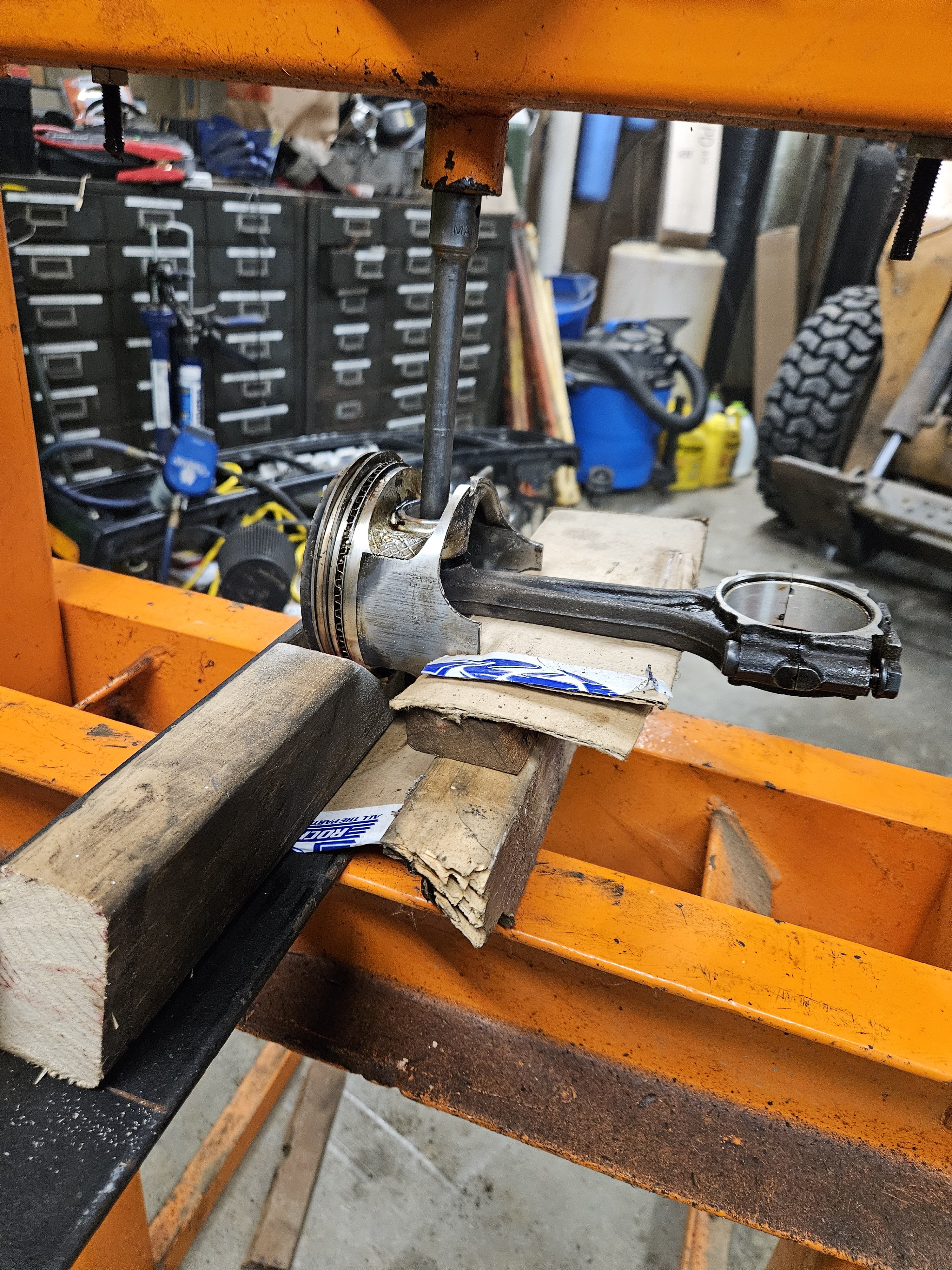

You pull it, rebuild it, and install it in less than a week.

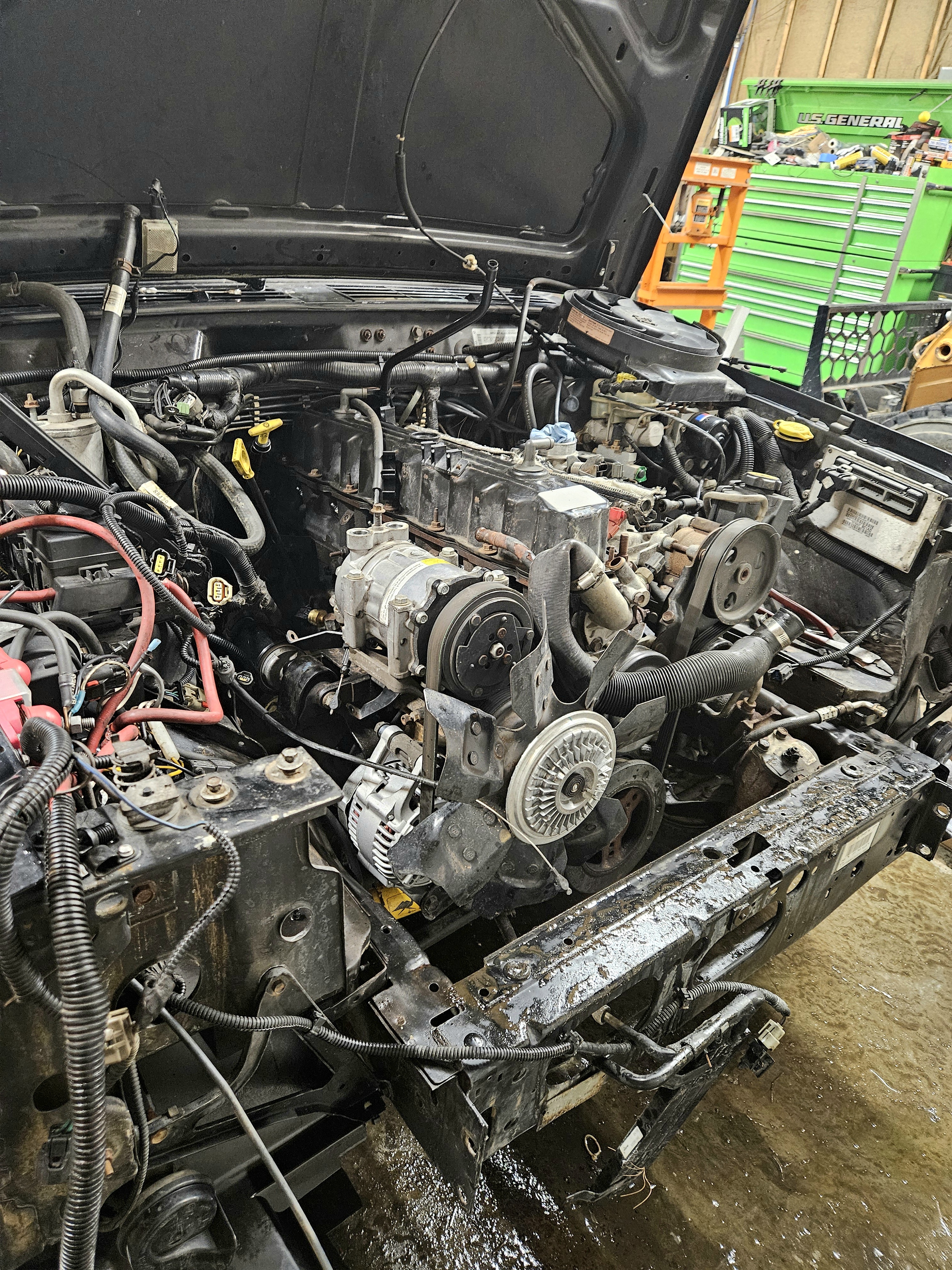

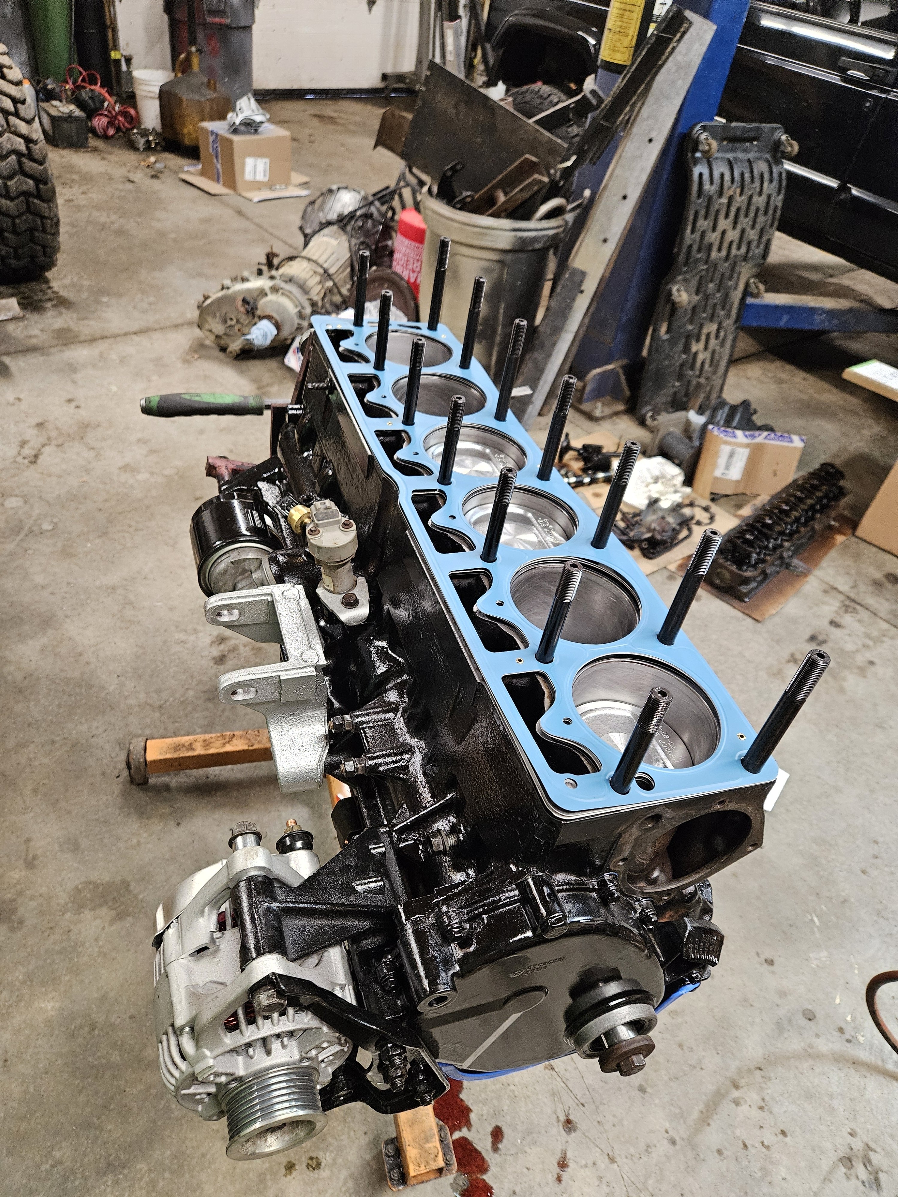

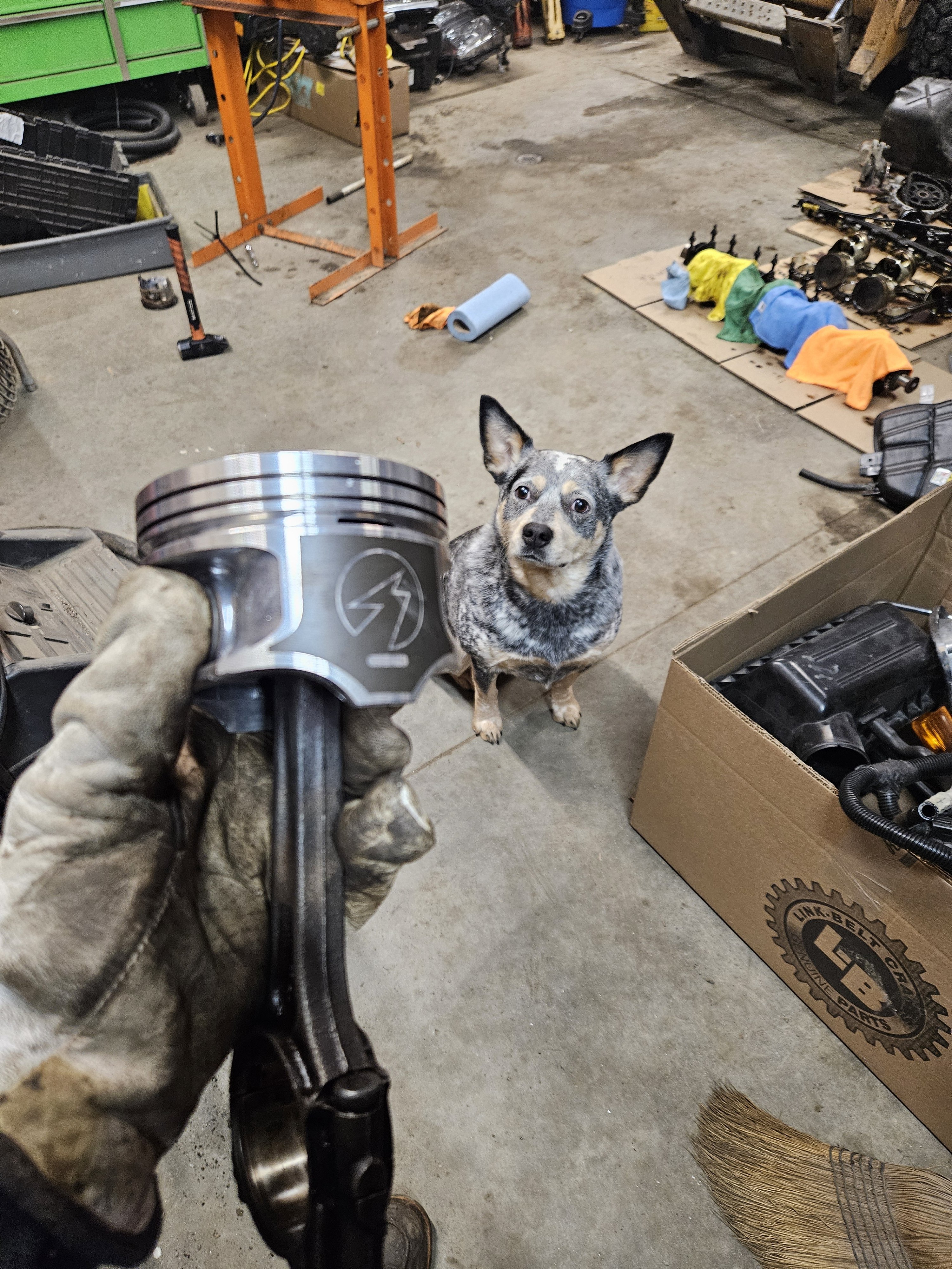

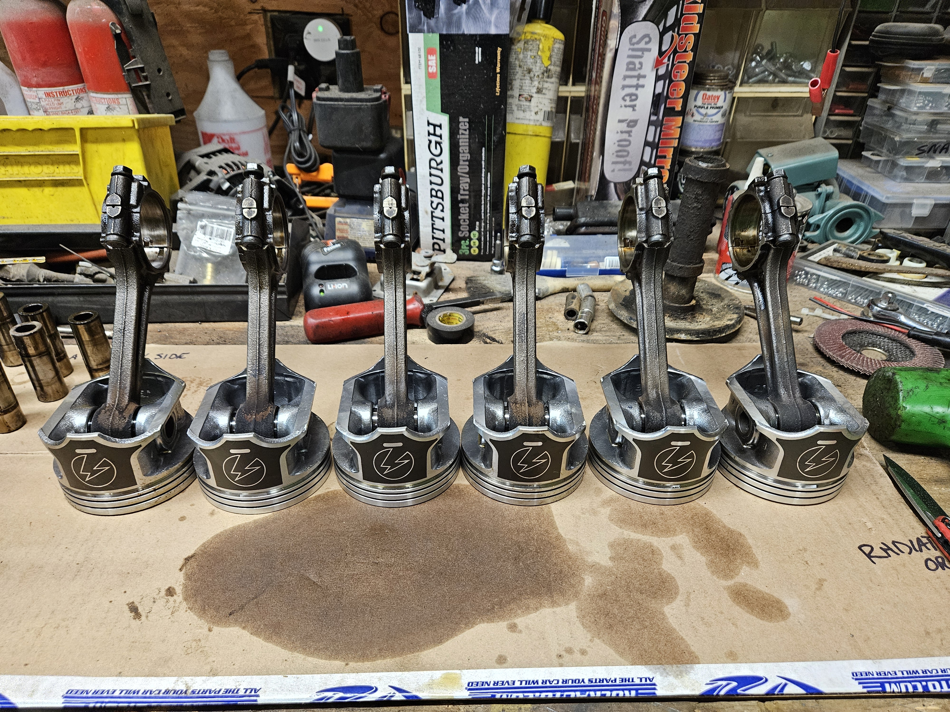

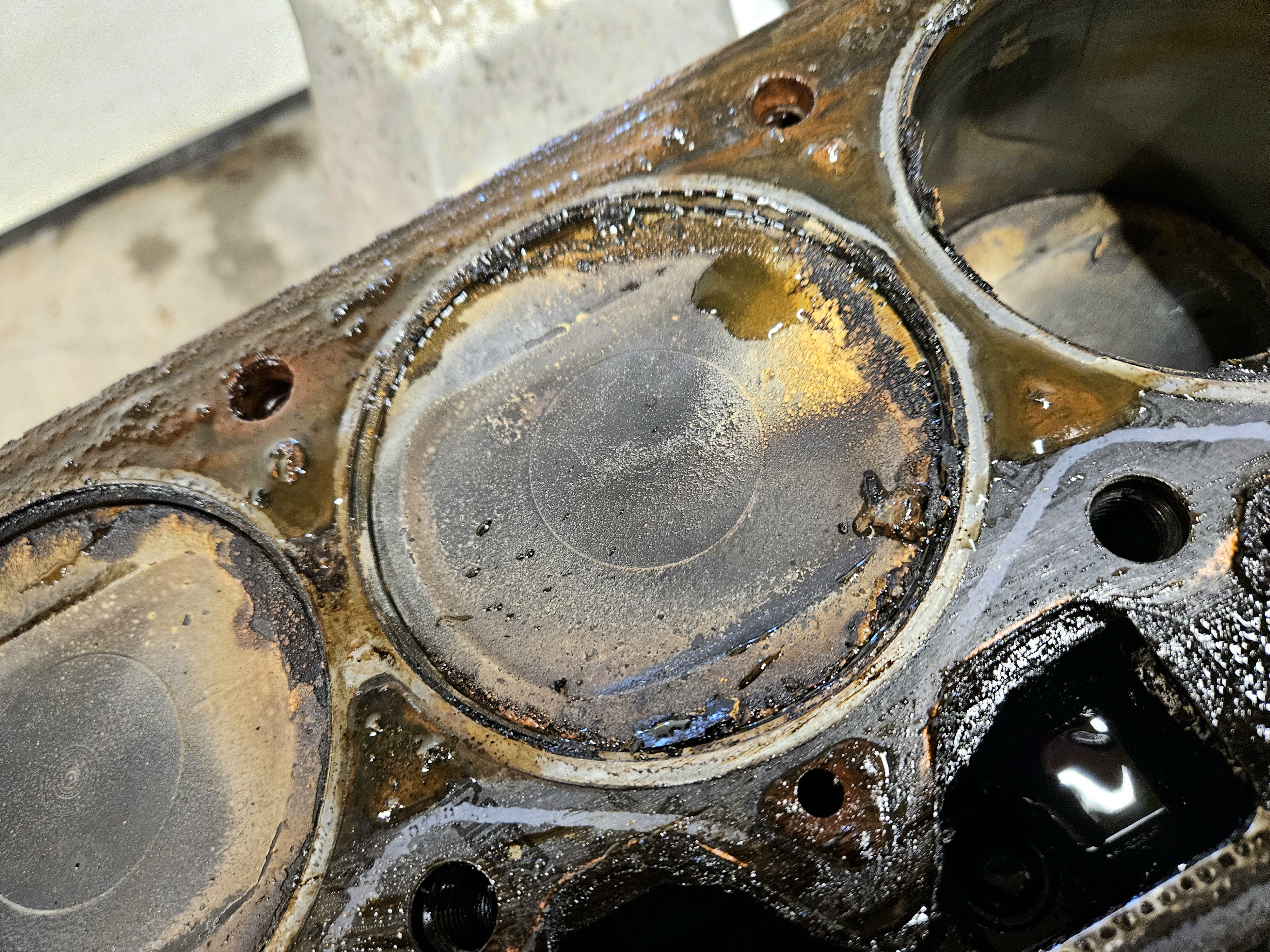

Yup, it blew up last weekend, so from Monday till yesterday morning I was doing all that's shown in pics, didn't take anything to a machine shop, did it all on my own. Well of course with the help of Peri! Drove about 100 miles on it so far and it's 👌

It’s probably an esoteric thing to say, but I took one look at the metal cabinets in the background of the picture where you’re pressing the wrist pin out of the piston and thought ”This guy and I would probably understand one another.”
Also, it’s interesting to see how much room the 4.0 takes up in the engine bay of your XJ. My TJ seemed to have a lot more space in there all around, and I had a second engine driven compressor (for on board compressed air) with plumbing for not only the air tank out back, but also the compressor oiler.
How many miles before the rebuild?
140k miles. Previous owner(s) clearly did not know how to maintain anything. They knew how to keep it nice looking thats about it.
The shop was a lot filthier during this time than it normally is too lol. A lot of things in disarray but easily found while doing this.

Well done man! I've work with a lot of techs in my years and I think I would have trusted maybe 3 of them to do that job. Excellent work
Thank you very much, it was quite stressful to be honest. Used a week of vacation time that I wanted to use for airgun comps, a lot of waiting for NDA shipments to come in but I did pat myself on the back with a 1 pound ribeye when I buttoned her up for good yesterday evening.

I assume you've got the tools to properly hone and or deck? Looks like good work. And I assume by the setting (and apparent quality of work) you know what you're doing. Looks like a job well done. But from doing it myself a few times (mostly on turbo supras) I know those long blocks (and heads) really throw a fit if they're not just right.

I assume you've got the tools to properly hone and or deck? Looks like good work. And I assume by the setting (and apparent quality of work) you know what you're doing. Looks like a job well done. But from doing it myself a few times (mostly on turbo supras) I know those long blocks really throw a fit if they're not just right.
Hone yes, deck no. Block was straight, head I had sitting on standby brand spanking new. Its running real smooth . Just a guy in a home garage following torque specs and instructions lmao
