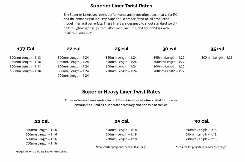

My FX Maverick VP .30cal with a 600mm STX liner shoots FX Hybrid Slugs and JSB Exacts pretty good, but accuracy starts to decline when I switch to the JSB Knockout 50gr and H&N Slug II ammo.
Will I see a noticeable improvement if I replace the STX liner with the Heavy Slug Liner? Will the Heavy Slug Liner greatly reduce my accuracy with JSB Hades and FX Hybrid Slugs?

I saw this on another post. If you go off this... it looks like you might be better off switching to the heavy slug liner. More spin for the heavier slugs.

I have and had very good luck in the past with the superior heavy in 30. I have liners in 500mm, 600mm, 700mm, and even the 800mm but I have not used the 800mm much as the recoil and whip in created some other issues with heavy projectiles. I mainly fire .22 and 25 slugs now for 200 plus yard accuracy.

I have the 1:14 800 mm (I think I have a 1:16 in 800mm too) and 1:16 700mm. They are my best shooting barrels. I shoot
32 gr to 40 gr slugs with excellent results. What weird is in 800mm the 218 shoot the same as the 217 for me.

wow 2 years ago. But yes the standard superior liner still does well for 50ish down grain which at the time seemed like all of like 3 pellets. Maybe some changes in 2 years since?
