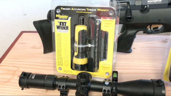

I picked up the F.A.T. torque wrench in order to tighten down my scope bolts properly. Plain and simple. I've often wondered if I'm over or under tightening my scope mounting bolts and ring bolts and what the effects of doing so might be. Now, I can feel confident that I'm doing it right. On rare occasions, I've also found myself wishing I had a nice in-lb torque wrench for working on cars and other projects around the shop. This will come in handy for those times as well. It's a nice little torque wrench and, like the scope leveling system, is easy to use. A simple pull-and-twist will get you to the torque setting you're after. Inside the package was a sheet of paper stating calibration measurements from when it was made. That's a nice touch since I have no way of checking it to make sure it's right. The system comes with 10 bits but, unfortunately, none of them are Metric allen size. There are 2 torx, 3 SAE allen, and 3 flat blades (Which I would gladly give up for some Metrics!). Like the level kit, it comes with a case to keep things organized, together, and protected.

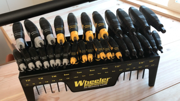

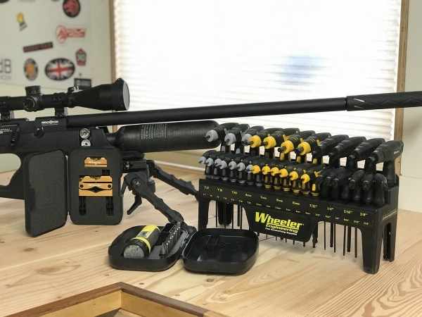

I've been wanting a set of "P" handled allen keys for a very long time! When I go to professional airgun shops, I see sets like this. When I look in the back ground of pictures from rifle tuners and guys that are always tinkering with their rifles, I see sets like this. So, there must be something to it, right? On the few occasions where I've found myself wrenching in shop with a set like this, I've always found them to be very nice to work with which has only reaffirmed to me to get a set. This may be a small detail but, when you give one of these a spin and you feel the weight of the tool kick in to help run a bolt down... it's just feels nice! I always thought these were called "T" handle but Wheeler is calling them "P" handle. In using them, I think they are formed comfortably and length of the handles allows me to get enough torque out of them without having to switch to the shorter end. The base is made of plastic. If I were using this in a car mechanics shop, I might have wanted to see a metal base. Since these will be dedicated to the airgun room, plastic will work well. I wish they had spaced the larger keys out a little differently. There's a few instances of conflict of space. For example, if I go to pull the 4mm hex key, it runs into the bottom of the 10mm hex key and I have to lift them both in order to get it out. Personally, I rarely use the larger keys so, I think I'm just going to put the larger ones in a drawer. As you might expect, the holes in the base are sized and hex shaped which helps to get keys put back where they belong. I like the set and I'm really glad to finally have one for my shop!
