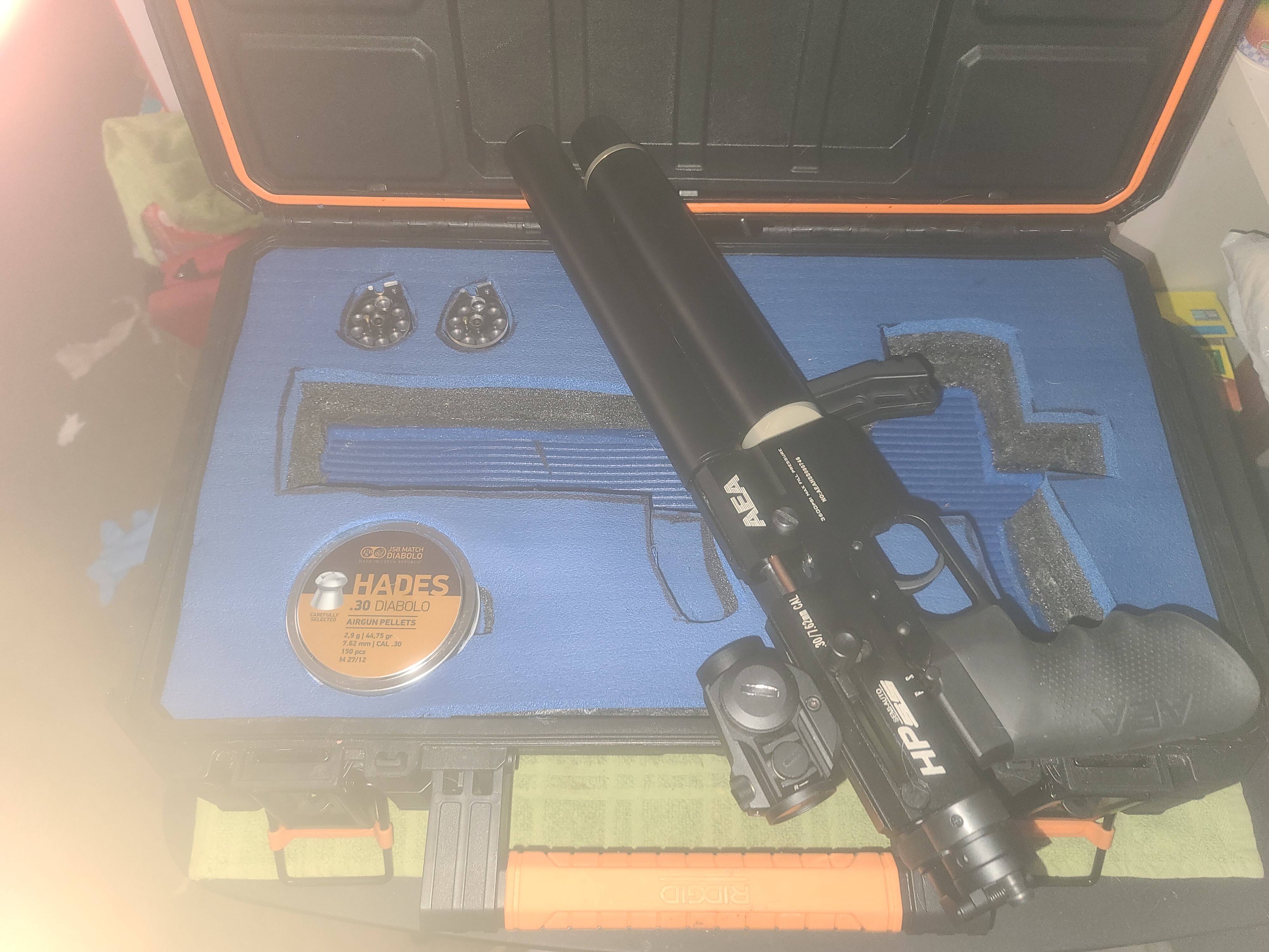

It all comes down to personal preference. Either you like it or you don't.View attachment 389671
My choice is Edgun Leshiy2. Went through the story with AEA. No thx. You can buy L2 from AGN for under $2000 and build with time to any caliber and power. Twice much than AEA, but the difference is day and night. Happy with the choice
