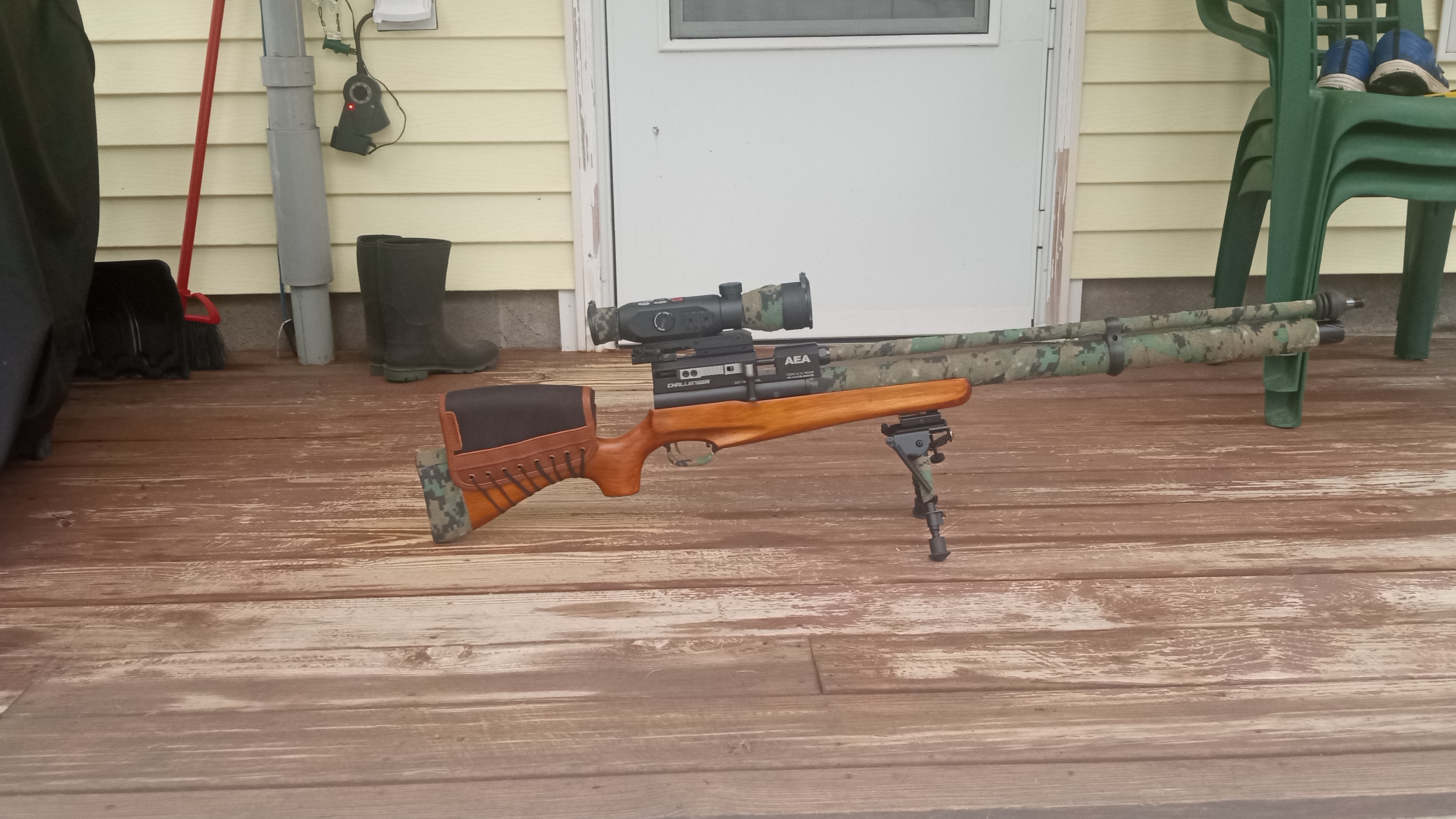

My most accurate is an American Air Arms 357 Slayer bullpup, shooting swaged slugs. It can shoot MOA groups out past 200 yards if I do my part. First six shot group, cold bore out of the case at 100 yards.
