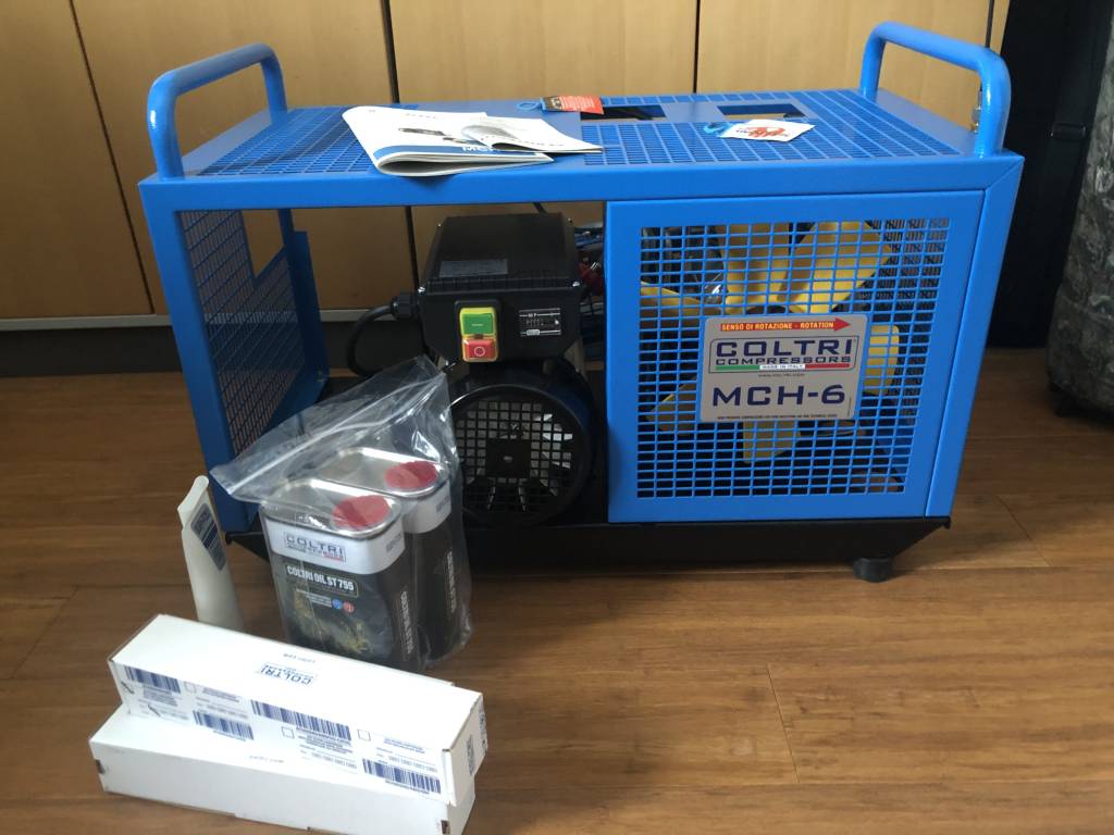

coltri

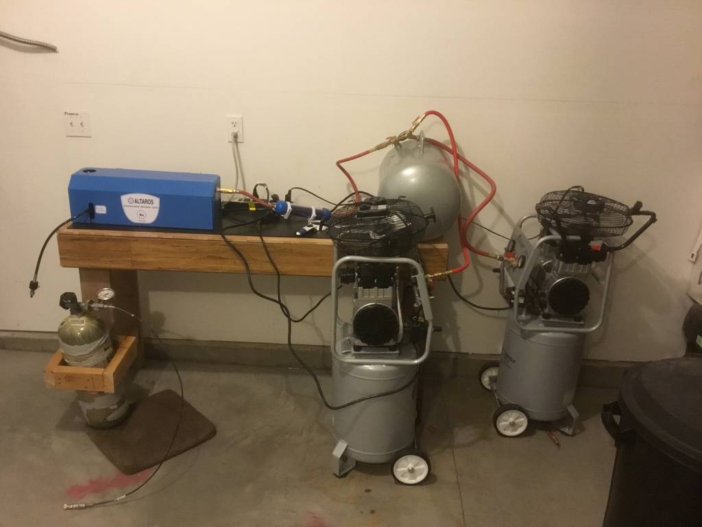

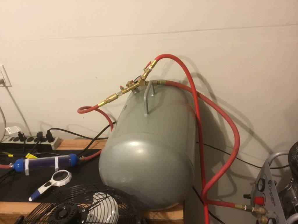

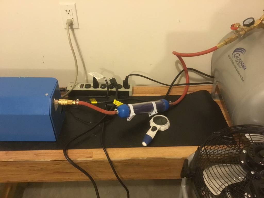

My set up is a Altaros Booster driven and fed by two cascaded 5.3 cfm quiet California AirTools oilless shop compressors which independently empty into a common air tank, and then into the Altaros Booster. A check valve at each compressor discharge prevents one compressor from filling the other compressors tank.
The set up runs very quiet as the CATS run at 71db. 12 inch industrial floor fan runs directly onto each compressor for cooling.
