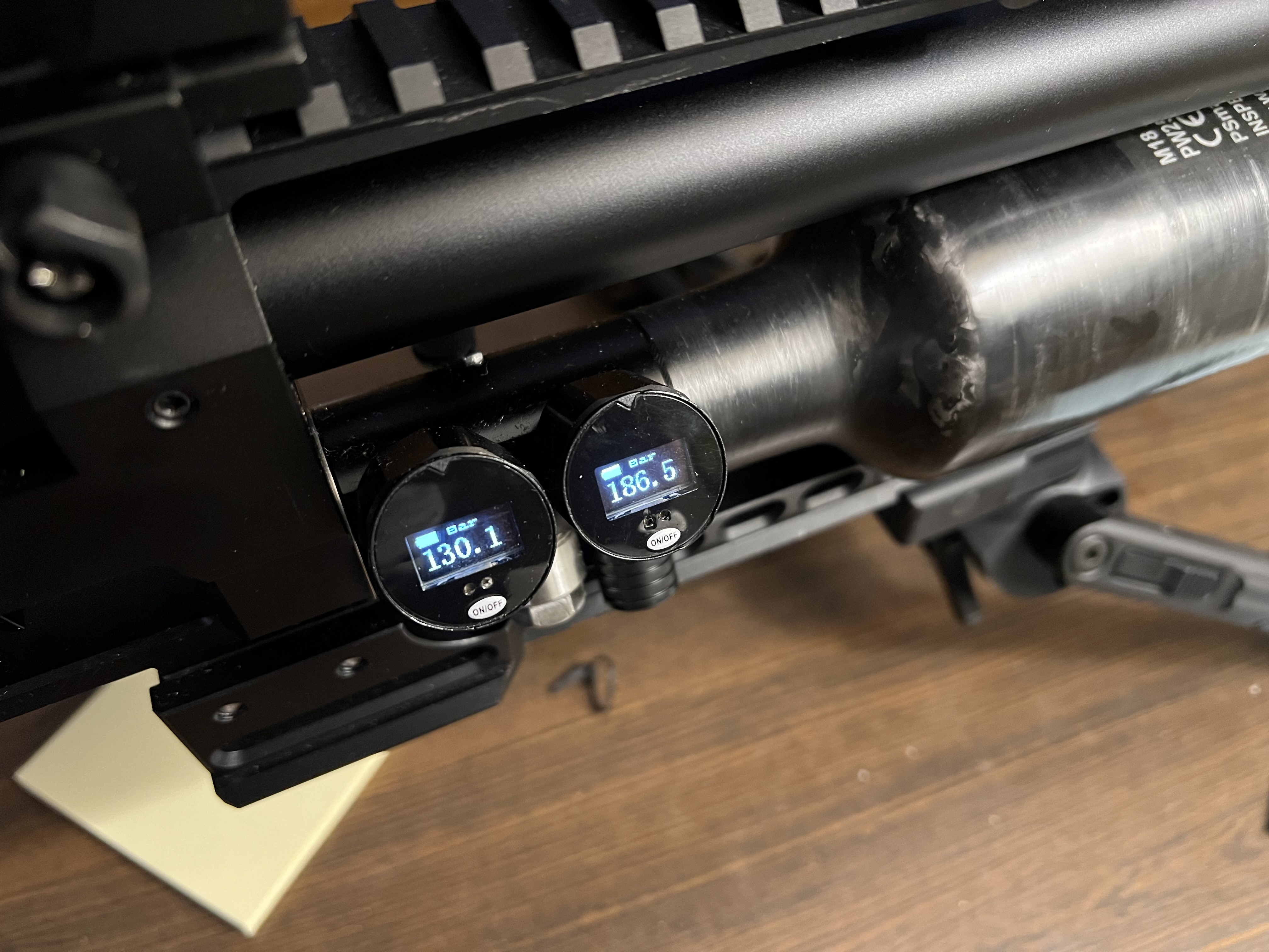

🔶 Then, I did another shot string.
Summary:
The REG dropped from 145bar to 131bar in just 5 shots (AIR 260 to 250b). 😱
🔸Then the REG was more stable, but still decreasing pressure as bad as before:
▪AIR: from 250b ➔ to 120b
▪REG: from 131b ➔ to 117b — over a total of 40 shots.
The average MV dropped by 31fps from 938fps to 907fps (55.1FPE to 51.5FPE).
⭐ Well, any more suggestion before I resign myself to write an email to RTI? 😊

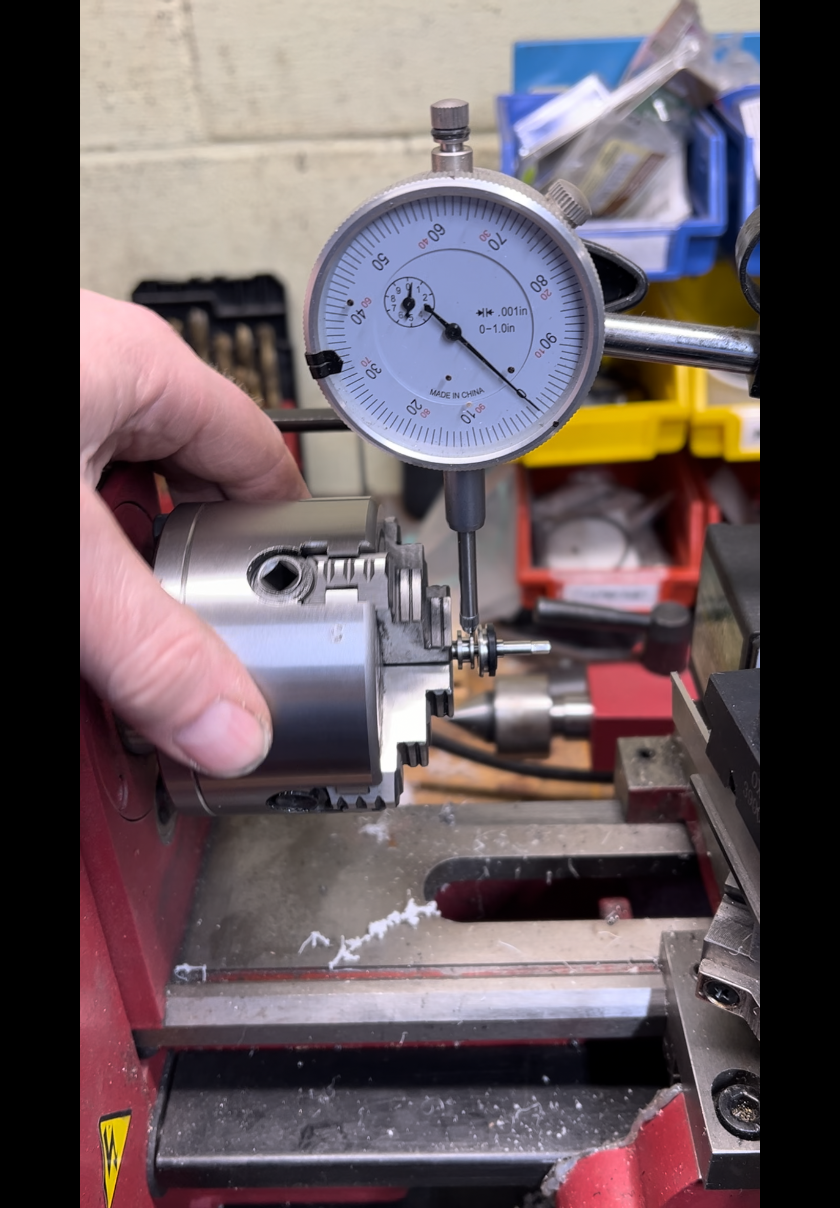

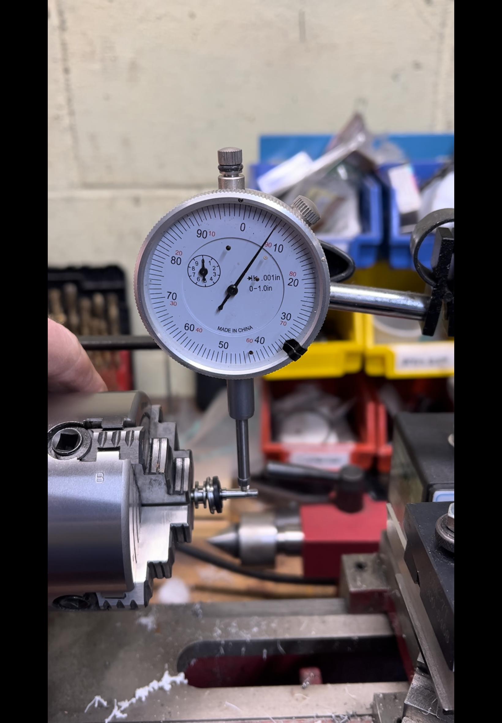

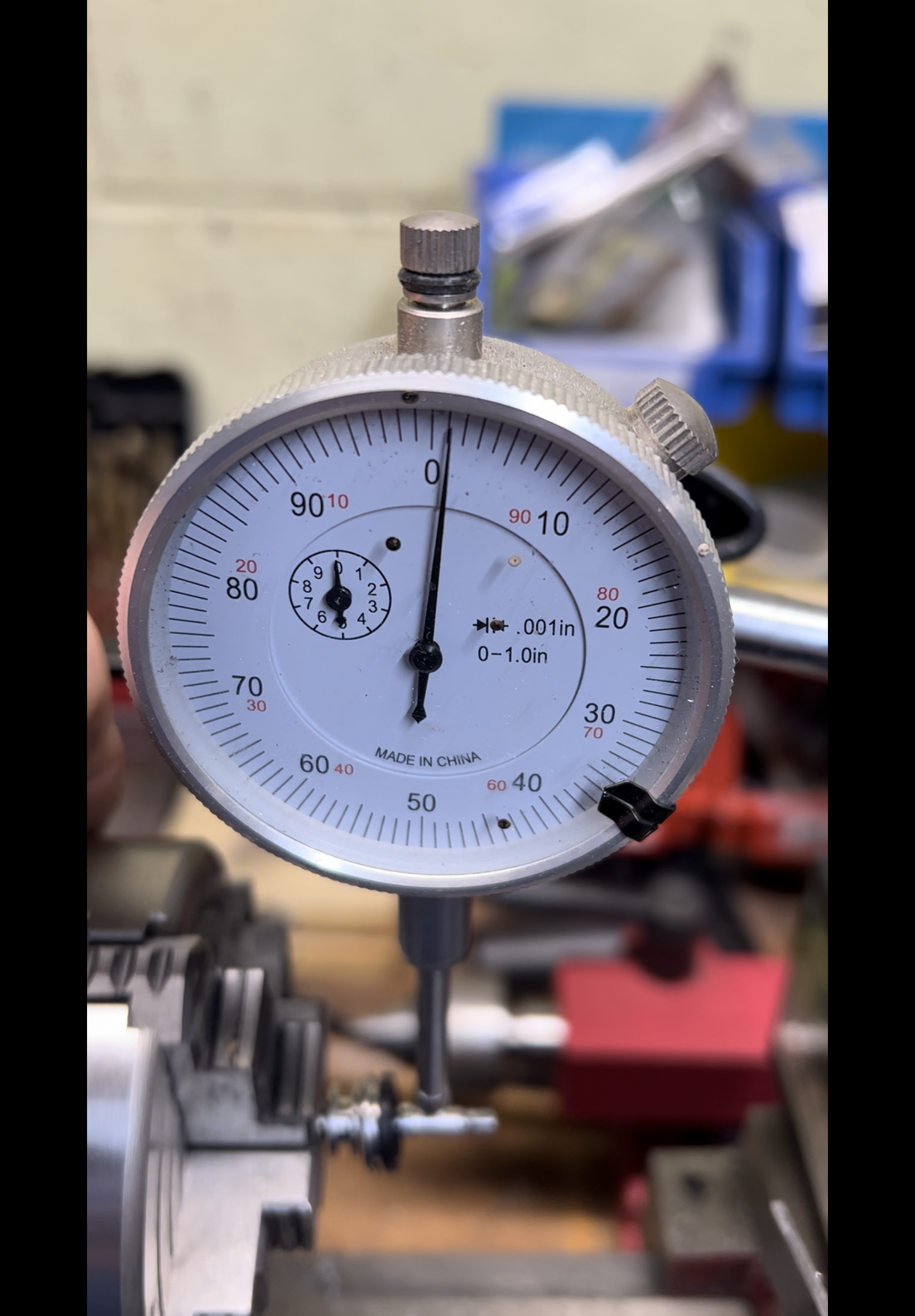

I was out shooting tonight getting my Coyote hold overs at 140, 160 and 200 yards. It’s cold out and gun sat for 24 hours. It was fine. I will see if I can find some pics of the runout on the reg pin. Because of how this reg works, I think it’s important. It may help others that have the tools to address it.
Thank you!! 😊
And shooting coyotes out to those ranges must be extreme fun! 👍🏼👍🏼
Ok, these are screenshots from a video I made on my phone back when I did it. I’m not a video poster so the first is when I dialed the pin in close to the chuck as close to zero as I could. You have to allow for flaws in the surface or a dust mite turd. Second pic is how much runout that pin had. Spinning in my mini lathe it was like a dogs tail wagging. Last pic was as close as I could get it to zero without going full OCD.

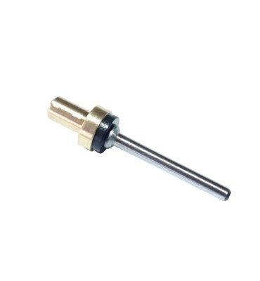

There is dude in Poland who makes a valve for the Prophet. He is on ebay:
He also makes an adjustable speed dialer for the Prophet hammer spring:
I ordered one of each. I don't know if this will help anyone without machinery for fix or make.
Can I ask who makes those small digital gauges and are they any good? The gauges on the Prophet are very hard to read to me.
