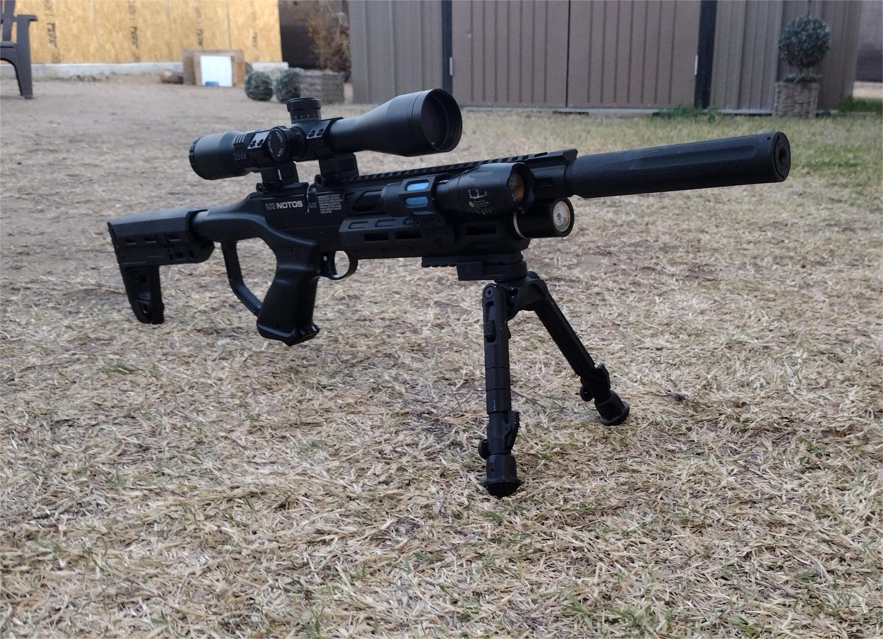

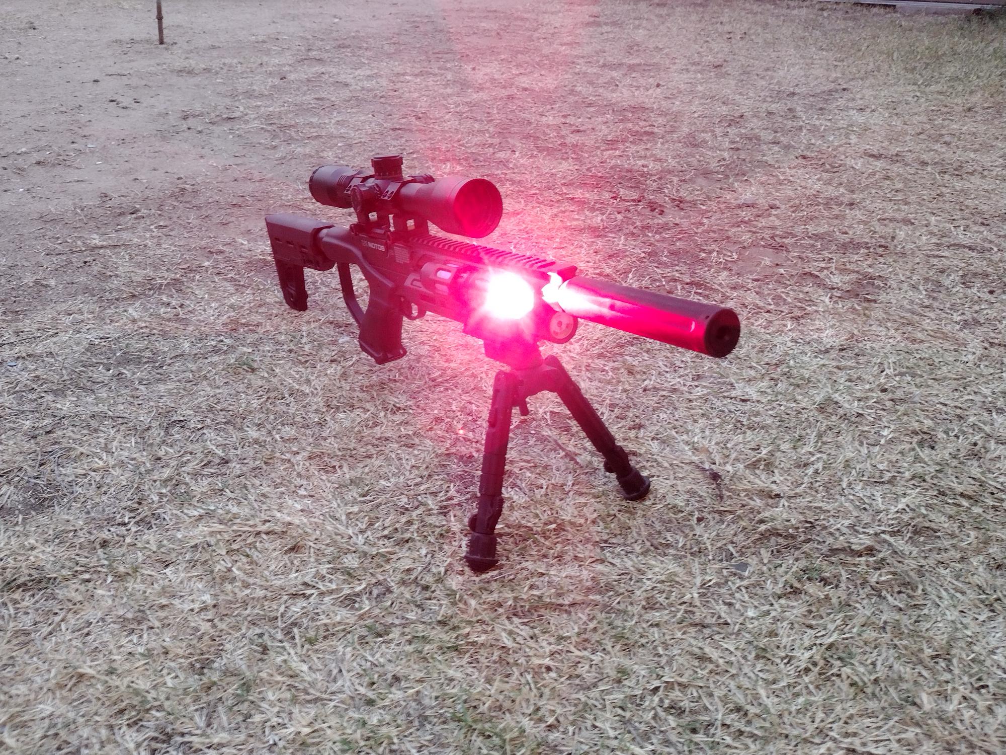

I use a redlight on my Notos backyard night time pesting ....I've been thinking about trying more powerful redlight for yotes at night, need to find one that can throw good light at at least 50 yards.
View attachment 583275View attachment 583276
Oh go on Amazon there are a lot of decent light options. I bought one for like $40 that has red, green and white bulbs that you can change out. With narrow focus I’ve caught eye shine out to 150y easy. I actually scan that way and when I see something I turn the scope on (the Zulus has a great standby mode) and go from there.
