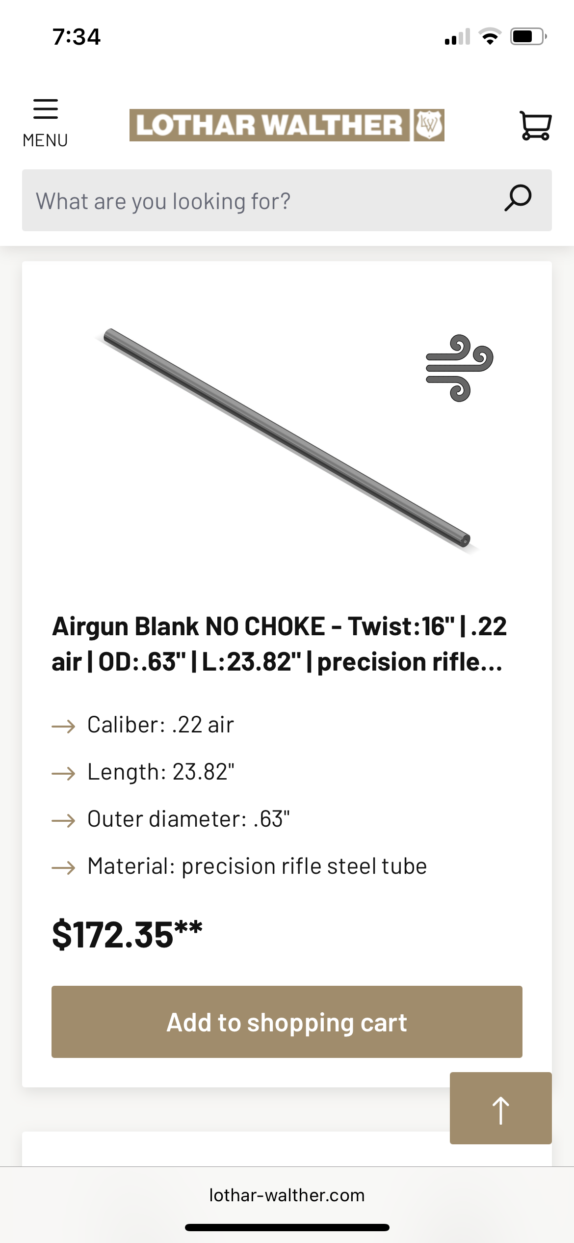

What’s the twist rate on the slug .22 23.5” LW barrel?
