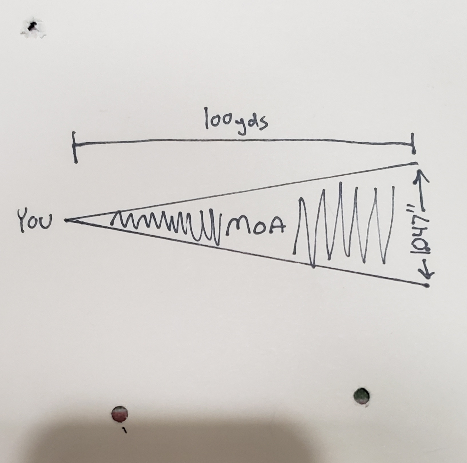

Here is a crude drawing for what "MOA" looks like from 0-100yds. That triangle just keeps expanding outwards as far out as you want to go. At 200yds it would be almost 2.1" wide. At 1000yds it would be almost 10.5". Any group size that fits inside the shaded area is MOA or better for that given range.

A 0.1" group at 25yds would basically be a 0.4 MOA group. A 0.25" group at 25yds would be about 1 MOA. Minute of angle (MOA) is an angular measurement and works at any range.

MOA (or MIL) is an angular measurement. It will scale to any distance. It will be about 1/4" at 25 yards, 1/2" at 50, or 5 inches at 500 yards if you want.
