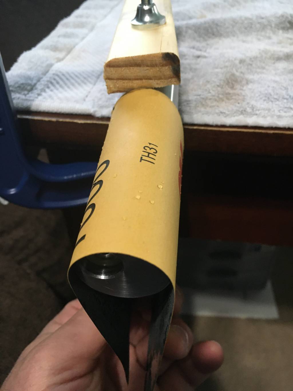

I have some older pics here of how I did a compression tube for a HW97 one time with the wet sanding part and just a clamp on my desk. Works the same for a piston.....
This is a pic of the sanding process that I used on that occasion....use very fine grit. What I used here actually finished very well and then the Dremel with the buffing wheel and jewelers rouge. This is only one of a couple of pics that I could find that I had on this process I used. Hope it helps.

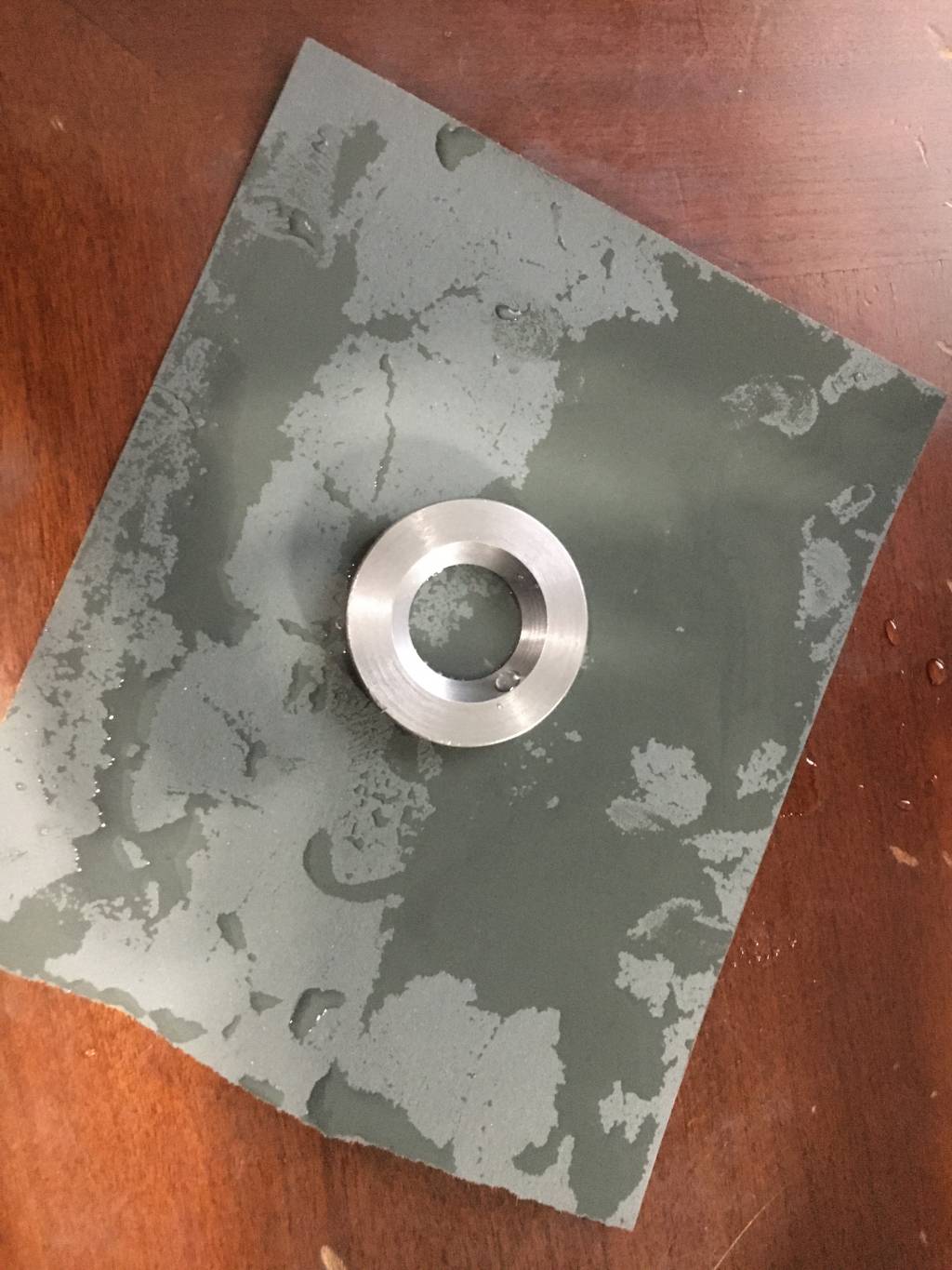

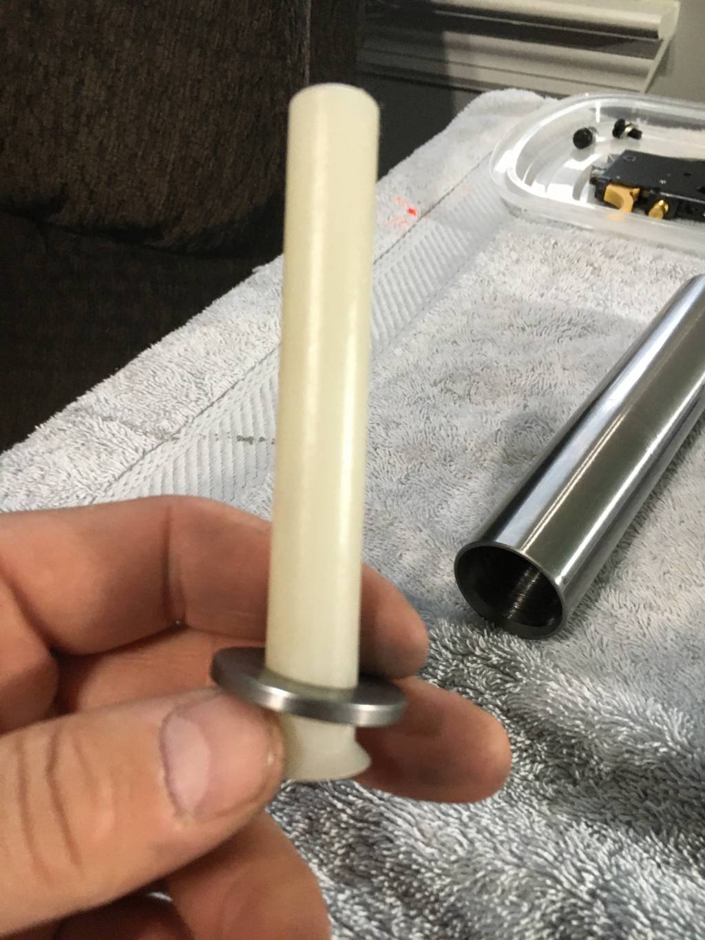

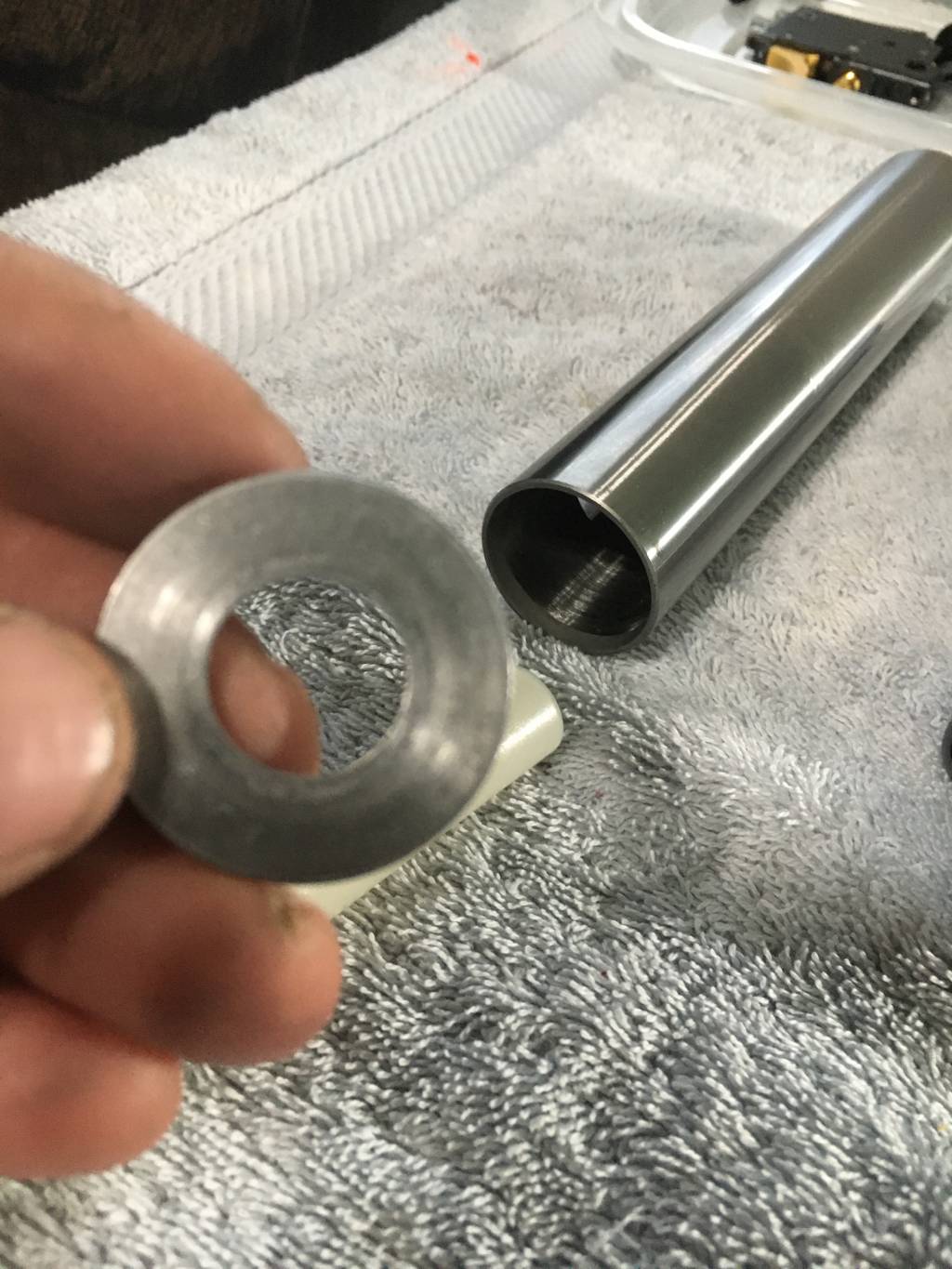

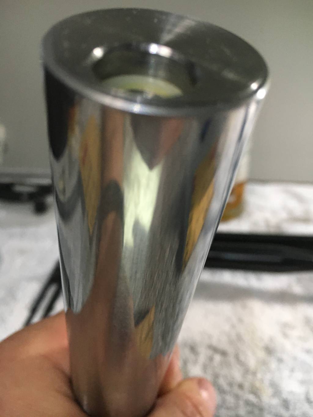

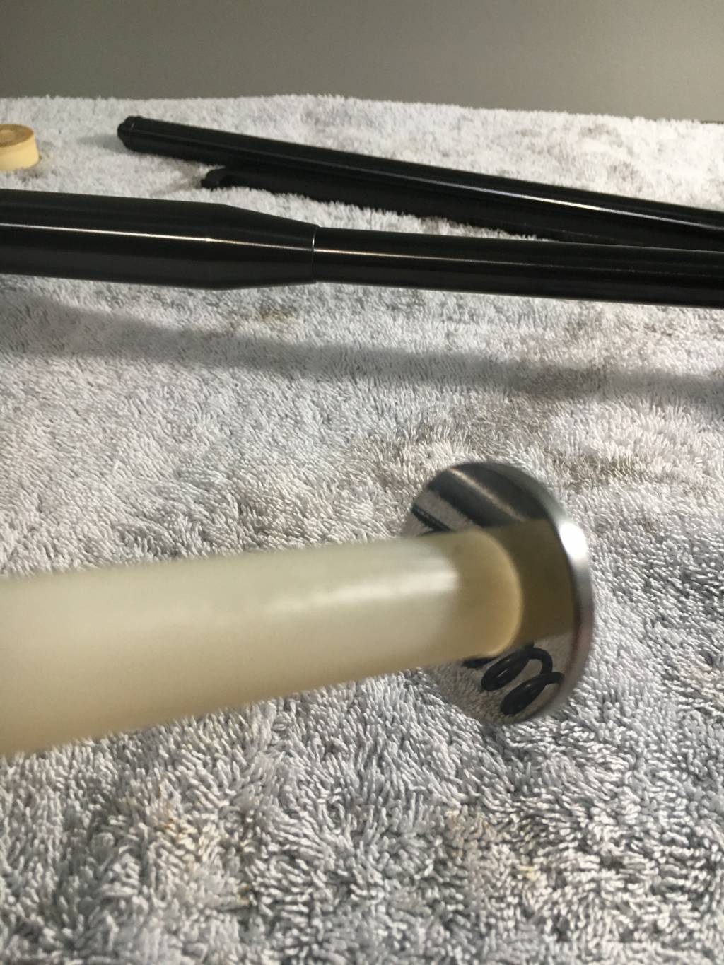

Arnie, I have played around with a few. But I would recommend something in the range of 1000-2000 grit paper. I have polished some springer parts to a mirror finish doing it this way without the use of any type of buffing wheel. I mentioned the buffing wheel on a Dremel in my previous answer to you because I've had pretty good results using it as well. The pics below show some HW97 parts that I polished by wet sanding using the above mentioned grit paper.
HW97 compression tube polished.
The last four pics kind of demonstrate the before, the process, the end result. In the last pic you can see the reflection of the spring which is sitting on the table out of view. It has a mirror finish from the wet sanding.
