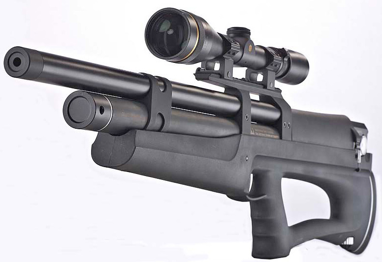

What's the Most Accurate Slug or Pellet in Huben K1
Hey guys, The dude's who sent me the Priest 2 to film a review a few months back are sending me the new Gen K1 (not sure what it's called, Huben 2 maybe?)
I would like to have the right ammo ready when it arrives.
Are there some pellets or slugs that are known to be very accurate out of the Huben? Please include brand an weight. -Nate
