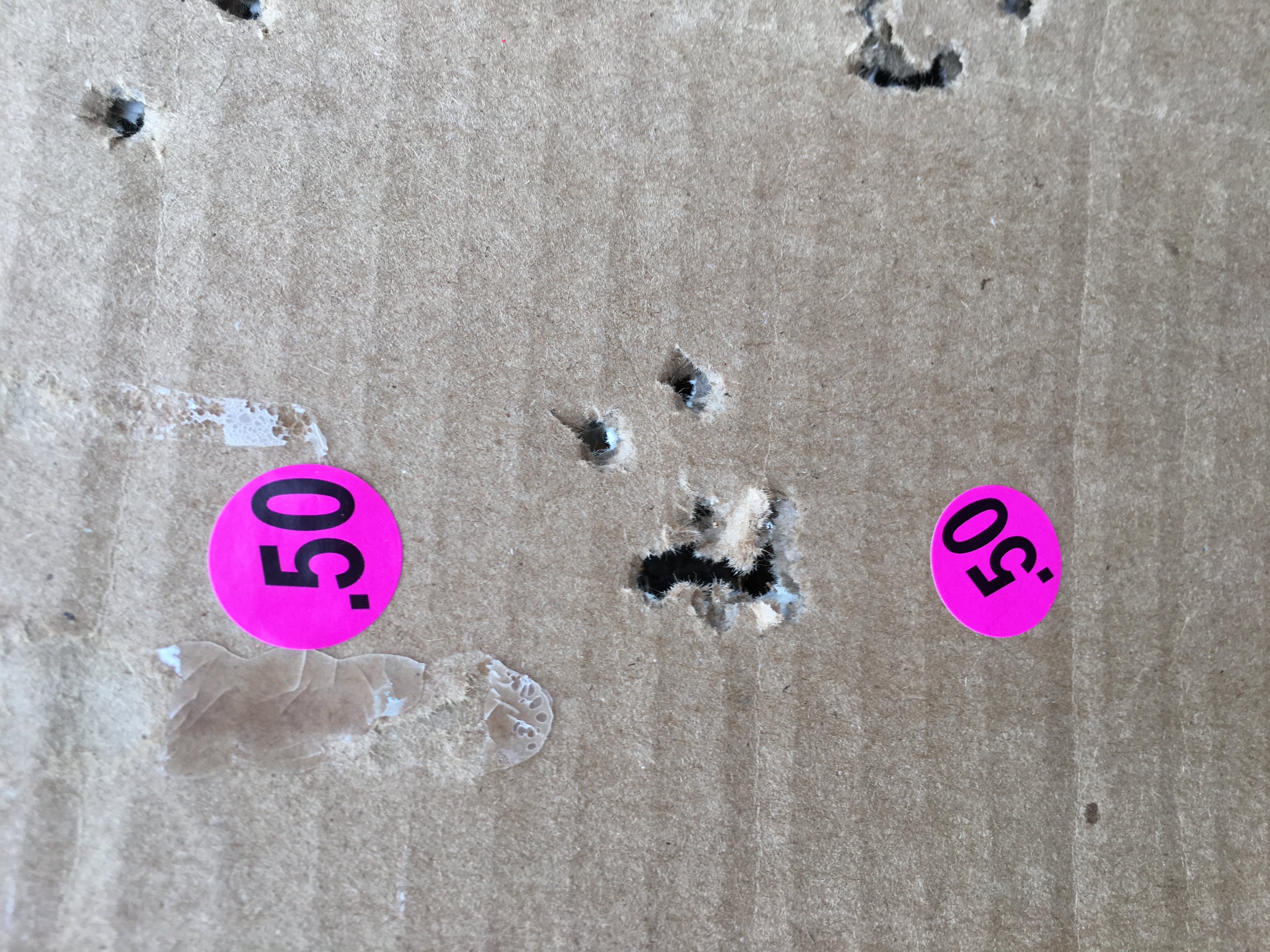

 I did it thank you everyone for the information.. here my results the ones out of the group was because of the wind, the targets was at 55 yards

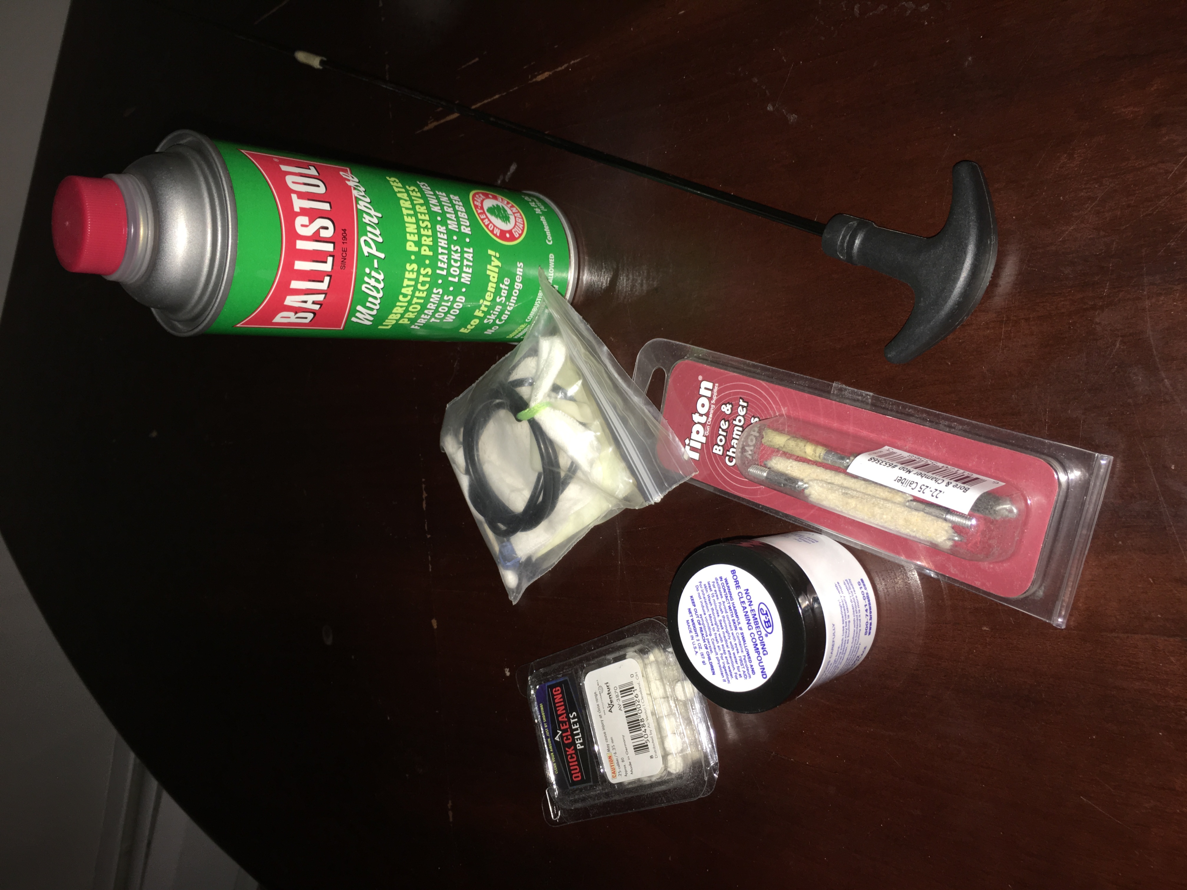

I used this
