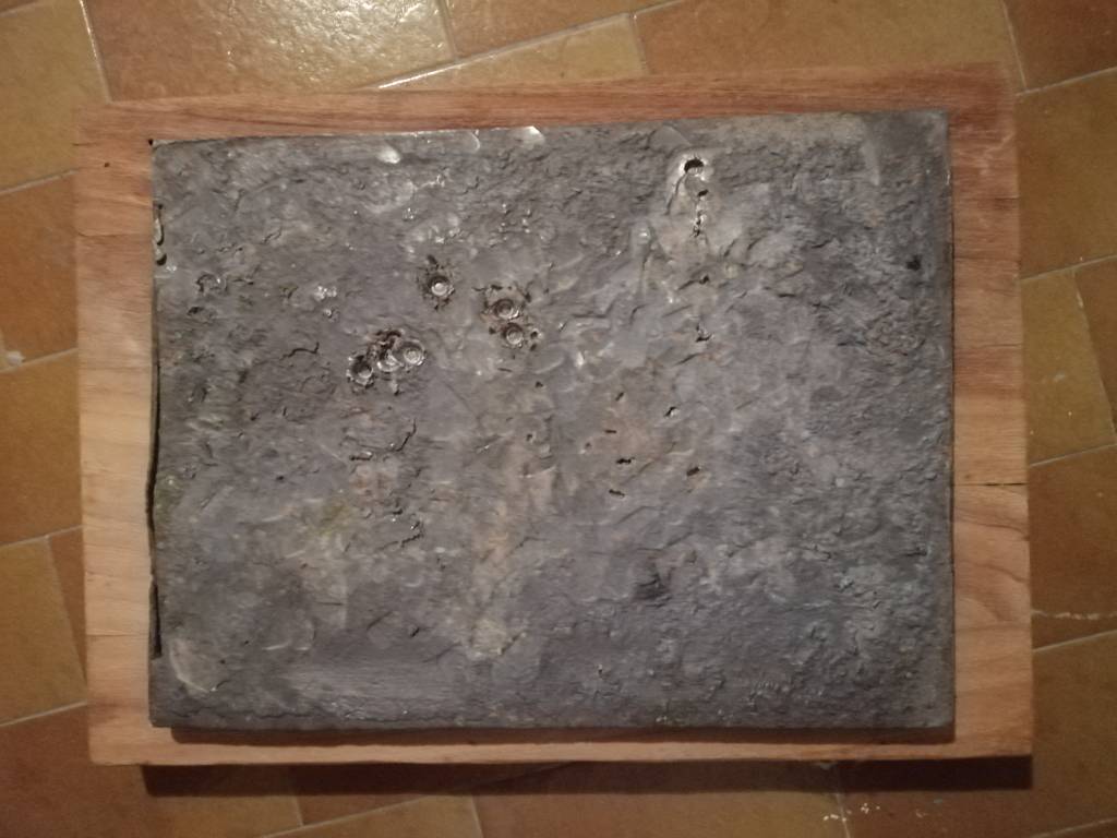

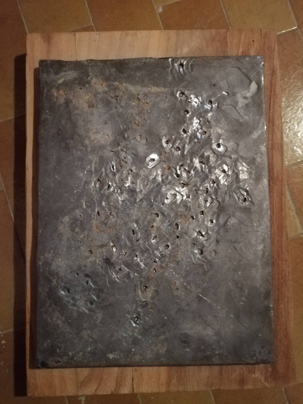

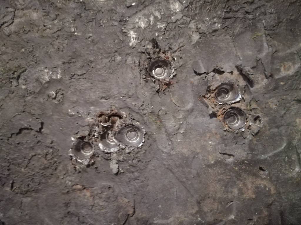

For about 15 € I made this bullet stopper. Lead plate 40x30 cm, 3 cm thick. I bought lead scraps from a junkyard and melted them in an old kitchen pan. At 5 meters it stops pellets cal. 25, 2.2 grams, shot at 280 meters a second ... 86J approx. Only drawback .... 25kg of weight. The shot does not bounce, but it gets stuck in the lead plate. No noise on impact. Ecological, no harmful metal is released into the environment.
