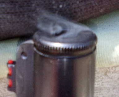

What's that burning smell? HW97

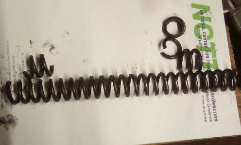

I thought the seal was dry and rubbing / friction burning in the cylinder ...
I don't know it lasted about 8 months and the spring brok in like 5 spots but disassemble looked to have plenty of lube .. new spring , seal, throughy cleaned out of old lube and krytox stopped that smell..lol

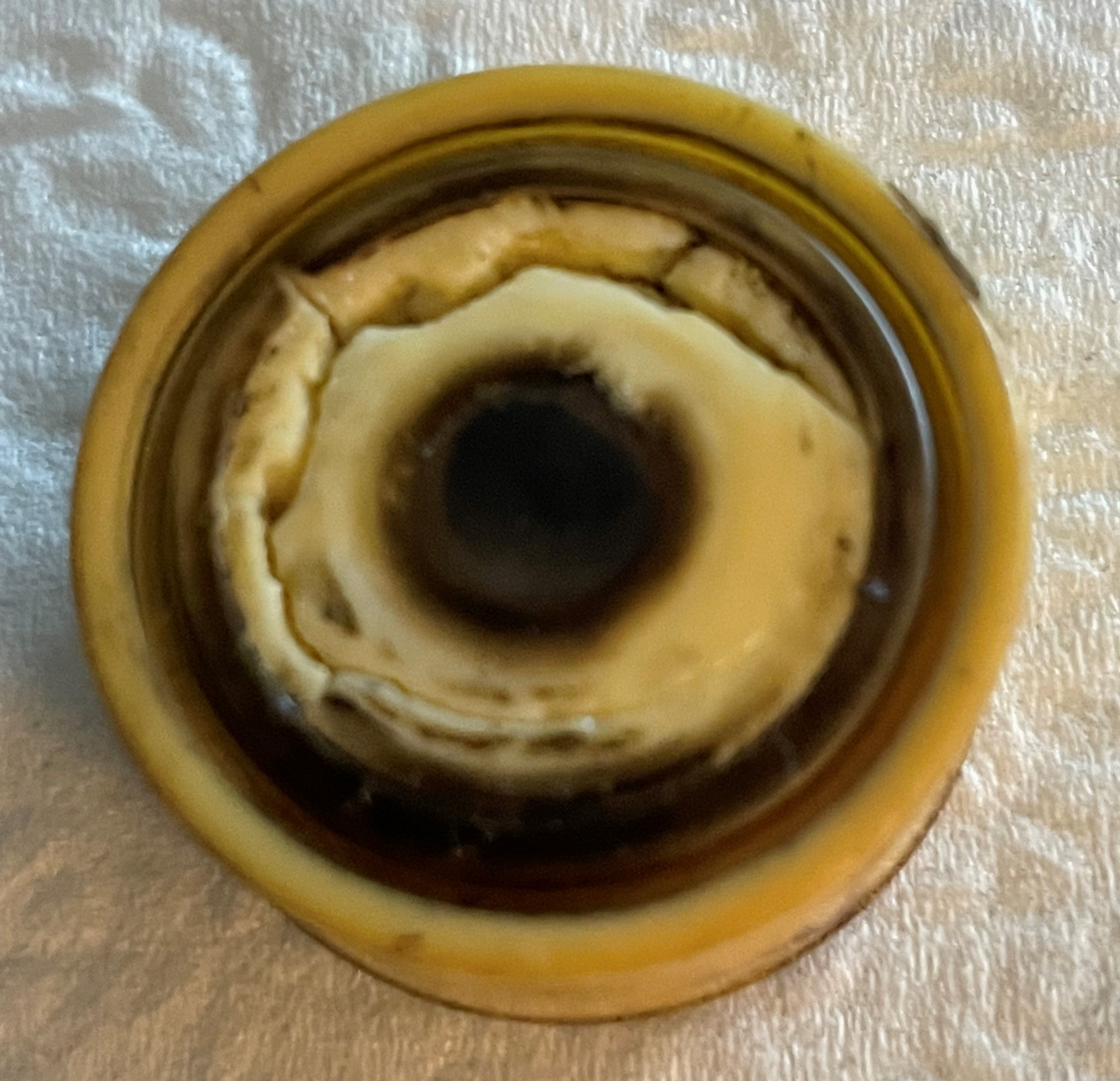

HW95L 2020 vintage seal damaged by dieseling.

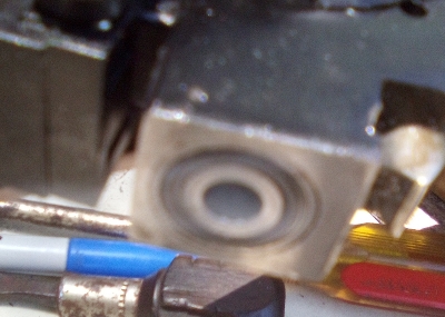

The R9 at 400+. Constantly got to do somthing . I just had it apart today " fixing" it. I call it the Edsel ( like the ford edsel). Spends as much time on the shop bench as the shooting bench. Thats after i had to spend another 70$ to fix the broken spring and bad seal in less then a year. Sure makes a gamo a heluva deal😉

In my experience, a little smoke after the shot is not going to harm anything and will go away after a couple tins usually. A loud bang at firing is a different story. I had a couple HWs that dieseled badly when new and a year later had broken springs. I always believed there was a connection.
A loud pop like a gun shot is detonation. Often heard when dry fired. Dieseling is just smoking. Yes excessive dieseling can burn out seals and shorten spring life. Detonation will break springs. My experience is Weihrauch springs don't last a long time with normal heavy use. My first two Weihrauchs didn't last a whole year before breaking their springs. I'm gonna guess 10-15k shots on each.

There's a big difference between just smelling some lube burning and serious dieseling. If the rifle
sounds like a rimfire every time you shoot it I'd recommend breaking the rifle down and cleaning
out the excessive lube. If it's not and just a slight whisp of smoke comes out of the barrel when
you blow through it you're good to go as that is normal for a new rifle. Give it a tin or two of pellets
and it will improve.
