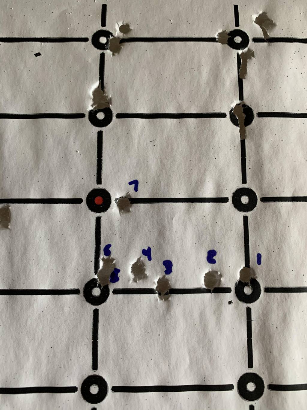

I know my Dreamline Compact has a different setup with its liner but I thought I would post a pic of what mine does when I completely disassemble the barrel system to clean the liner. If I don’t take everything apart to clean the barrel it doesn’t do this. The good news is once it walks itself in, it stays dead on accurate for a long time. It’s like the barrel has to vibrate itself into its happy place. Don’t give up. If it was accurate before, it can be accurate again.
