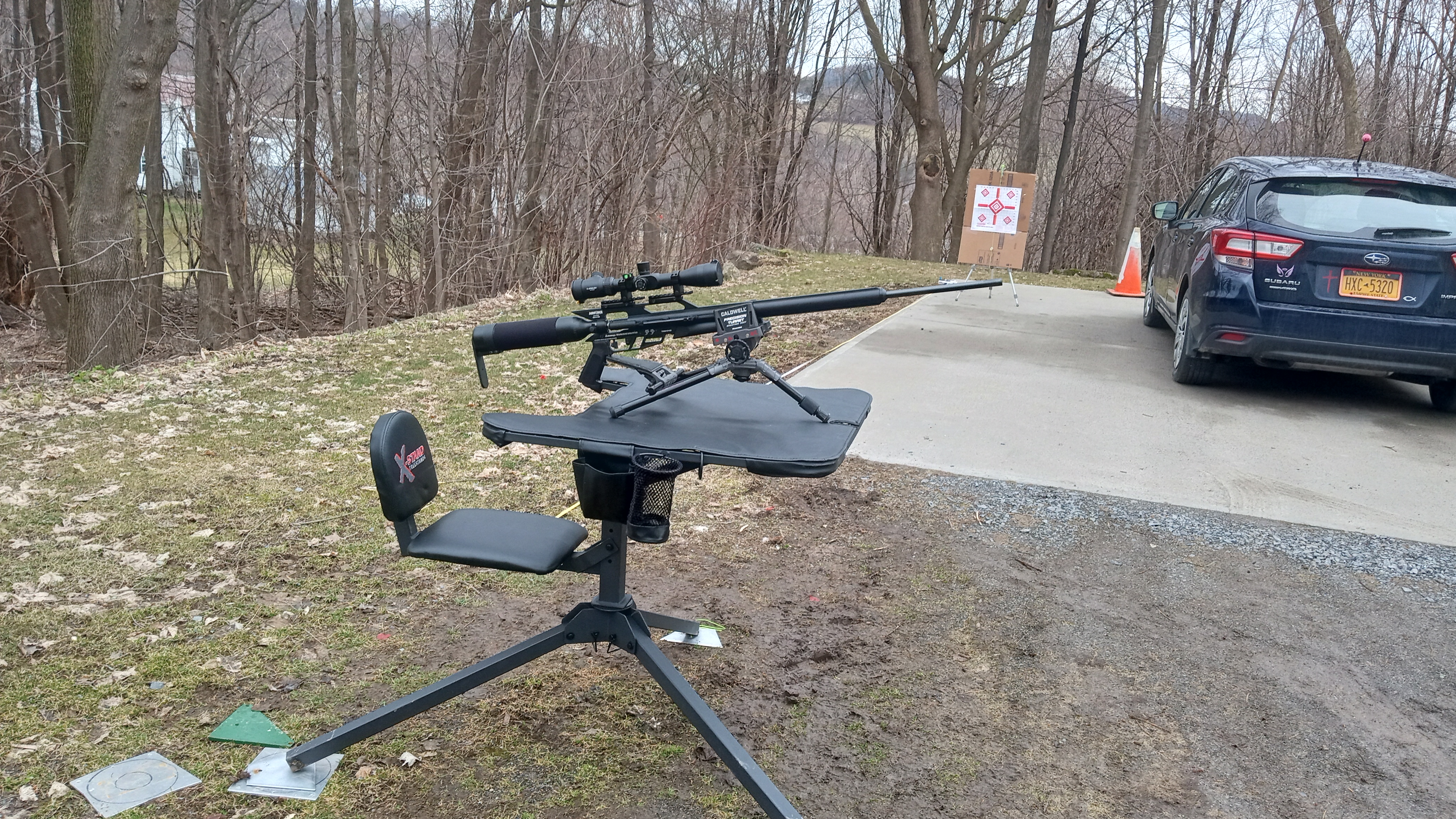

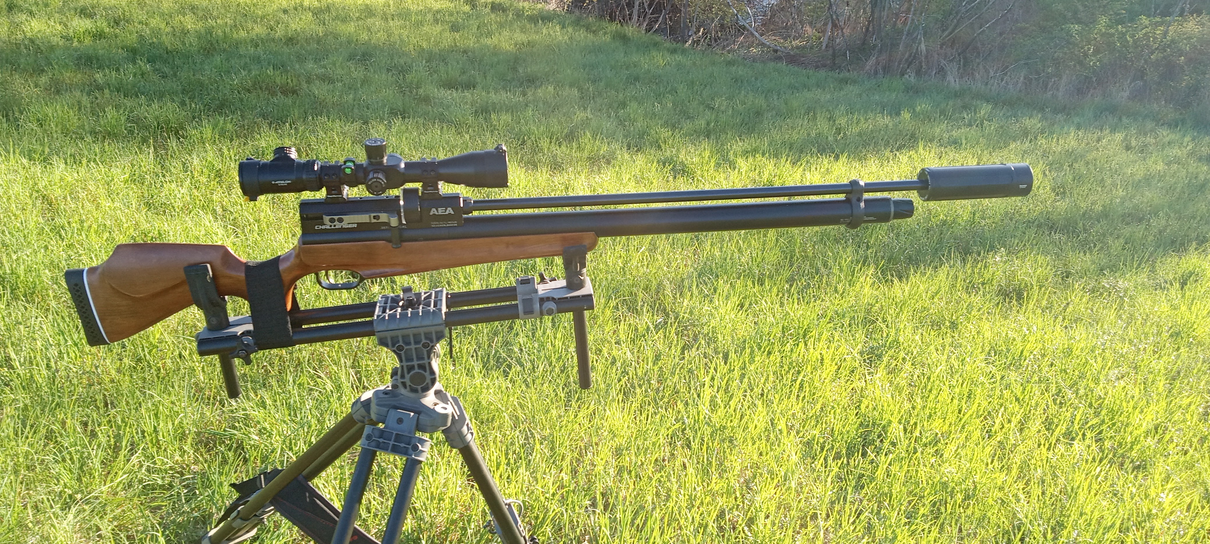

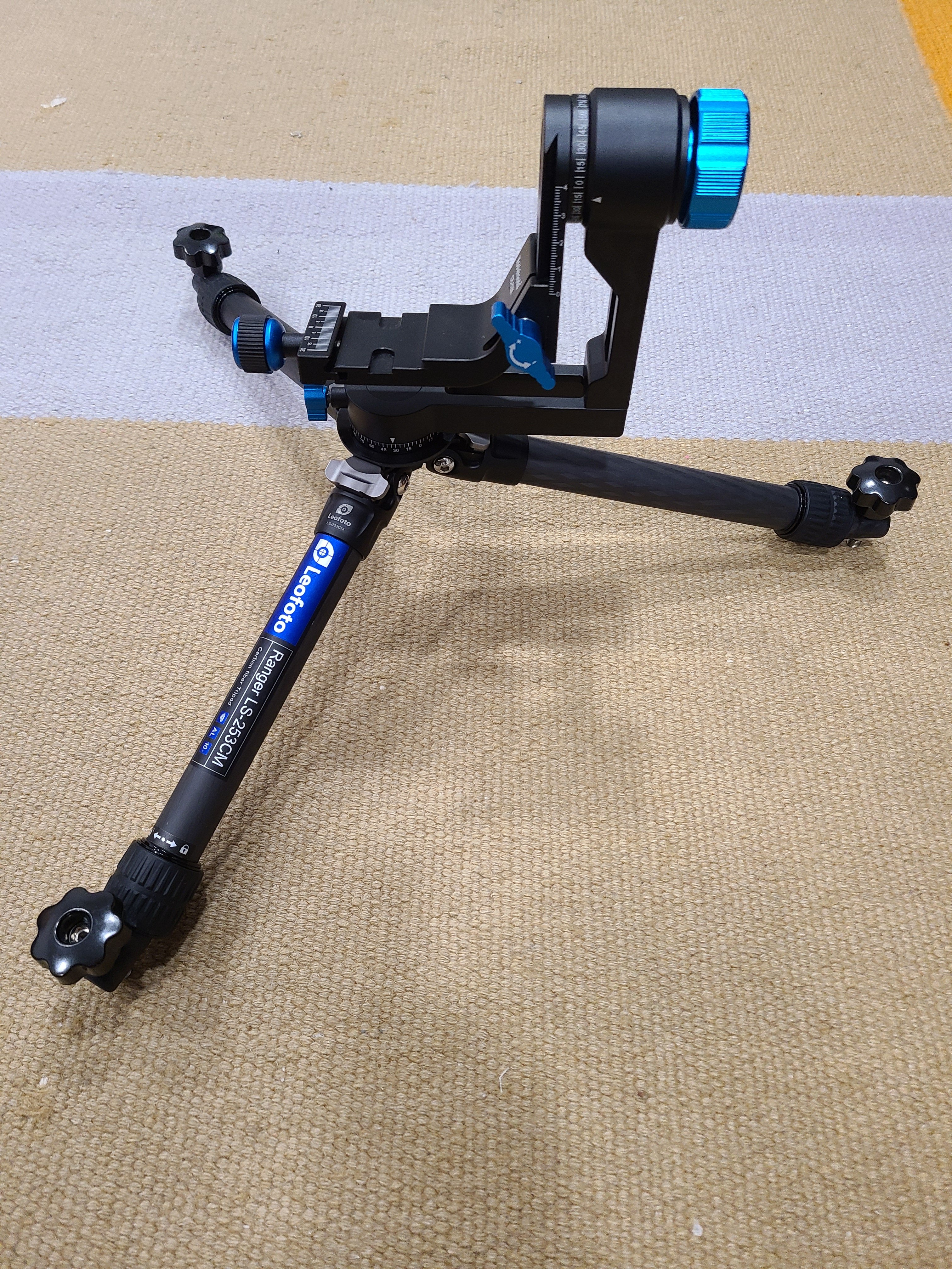

I spent some time and money on trying what works more or less, for me personally a tripod works much better then any bipod I have seen.
This from an engineer perspective, I am not competing with an airgun but have some two decades in shooting sports and training and shooting as I would compete. And btw this tripod wasn't cheap neither.

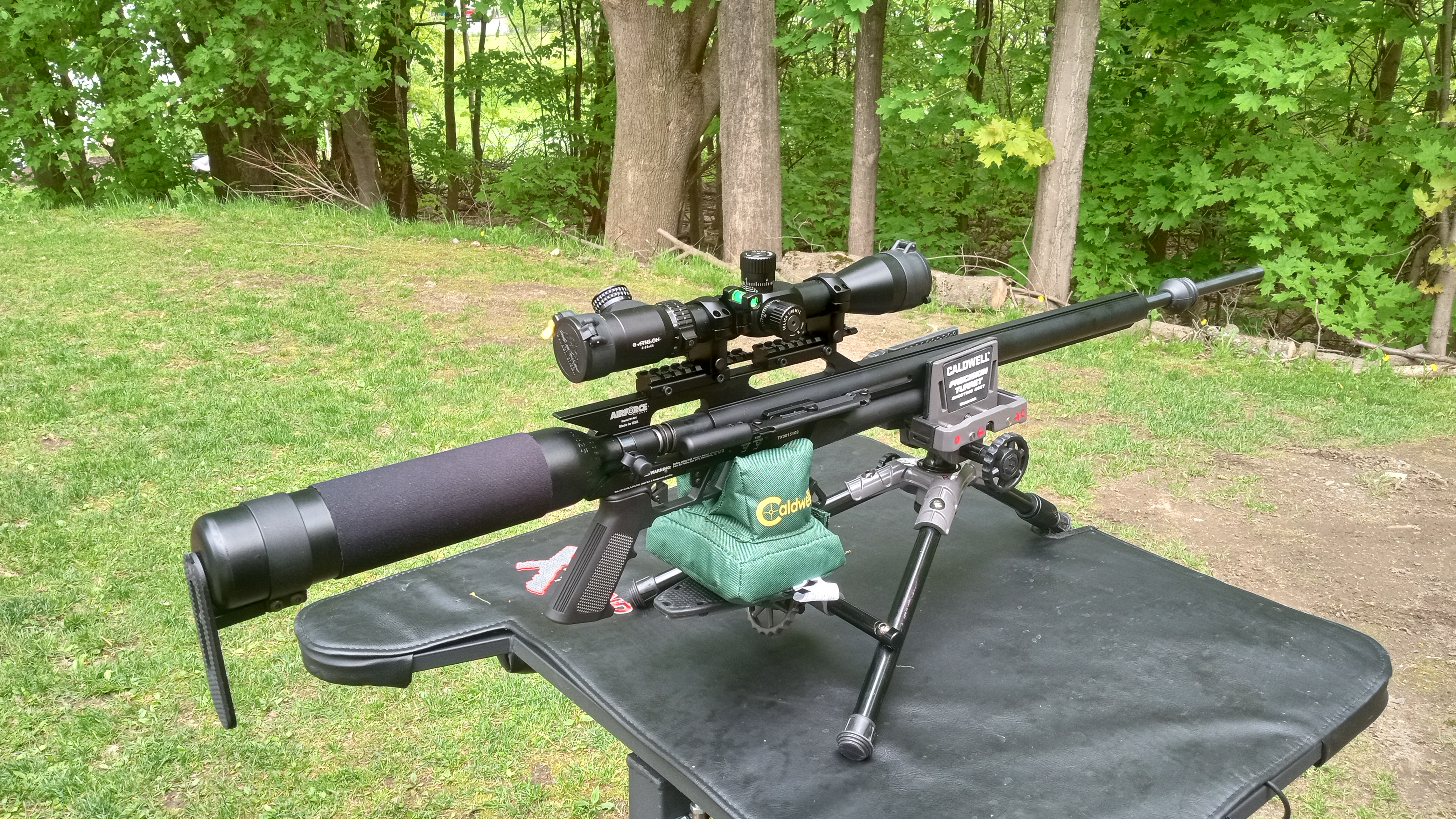

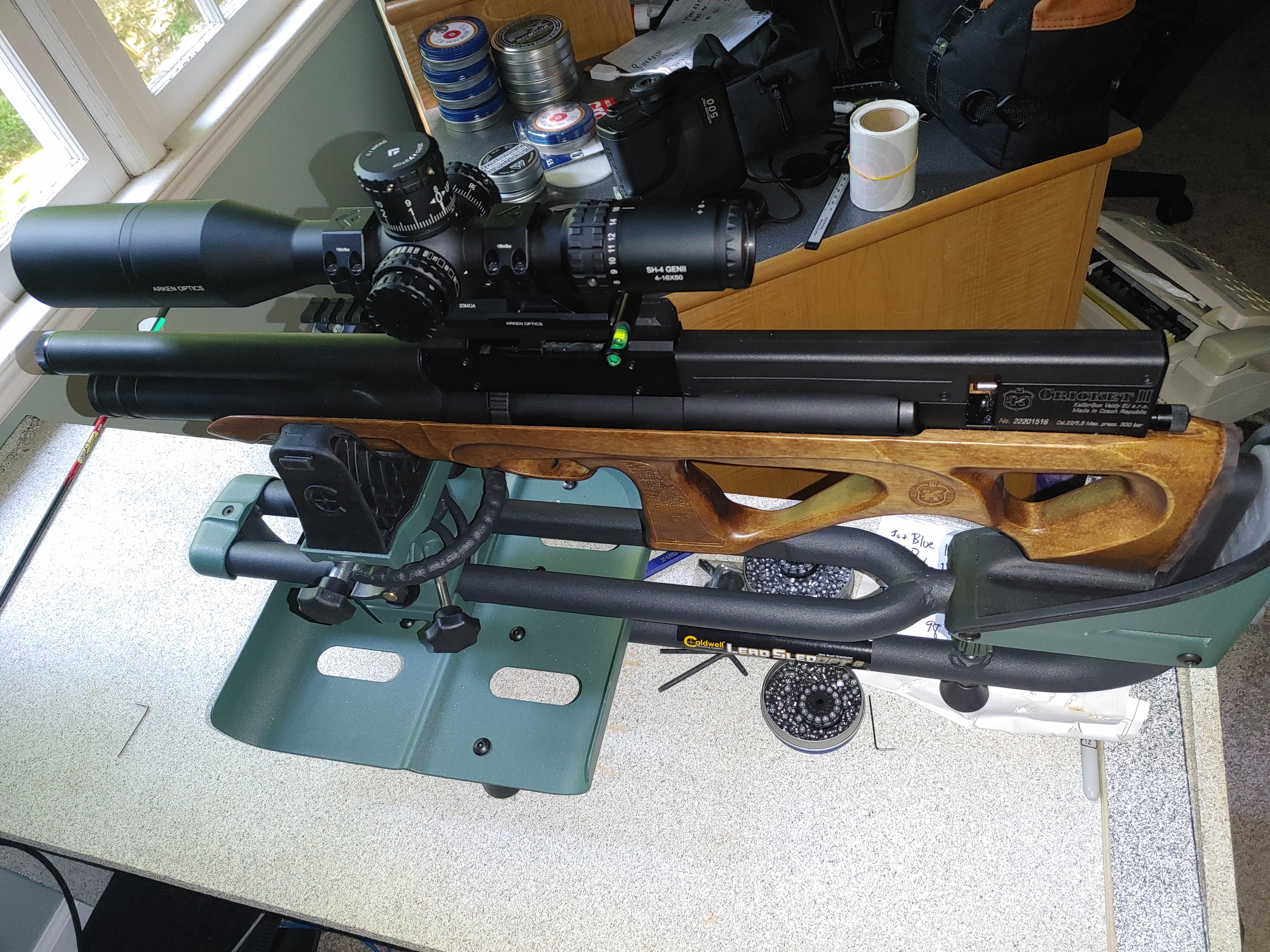

i have two setups i use .. first is a caldwell rock jr and caldwell prefilled rear bag .. second is a caldwell turret rest .. i can set both rigs up in a window in the day and leave the gun there sighted on a gong at ~100 .. open the window any time at night and just pull the trigger and ring it lol ..have to have a stable base to set up on though, if it moves when you lean on it etc, no good .. bipods meh, dont like them except to be mobile if i need to setup in an oddball place .. they can do fruity things with a guns harmonics though, not the ultimate in accurate imo ..
So which is better the turret or the rock Jr?
Is there a bag you rest the gun on? Is the big blue knob a windage adjustment? Looks like it would be very mobile and easy to cary arround compared to one of the cast iron Caldwell front rest..

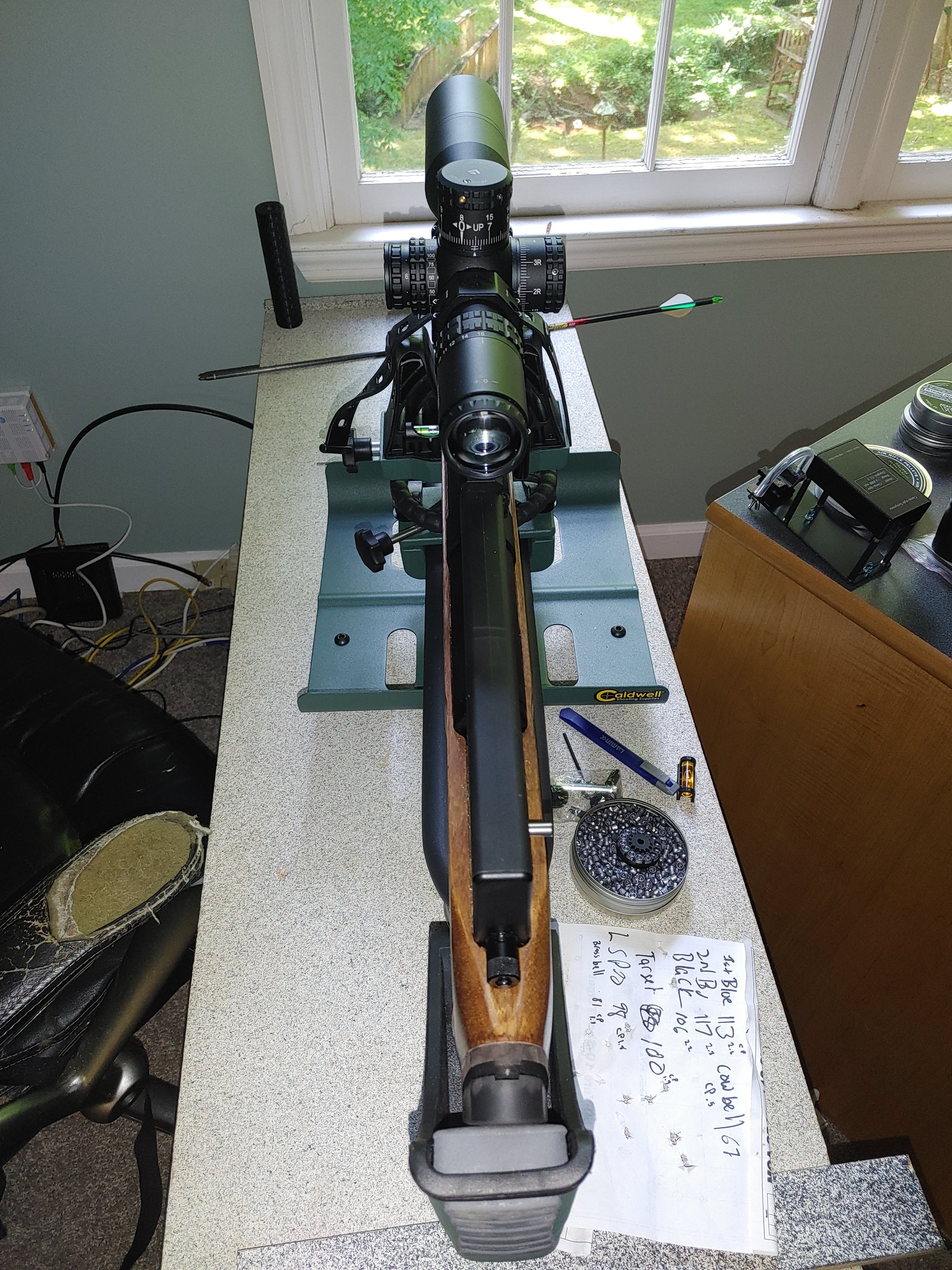

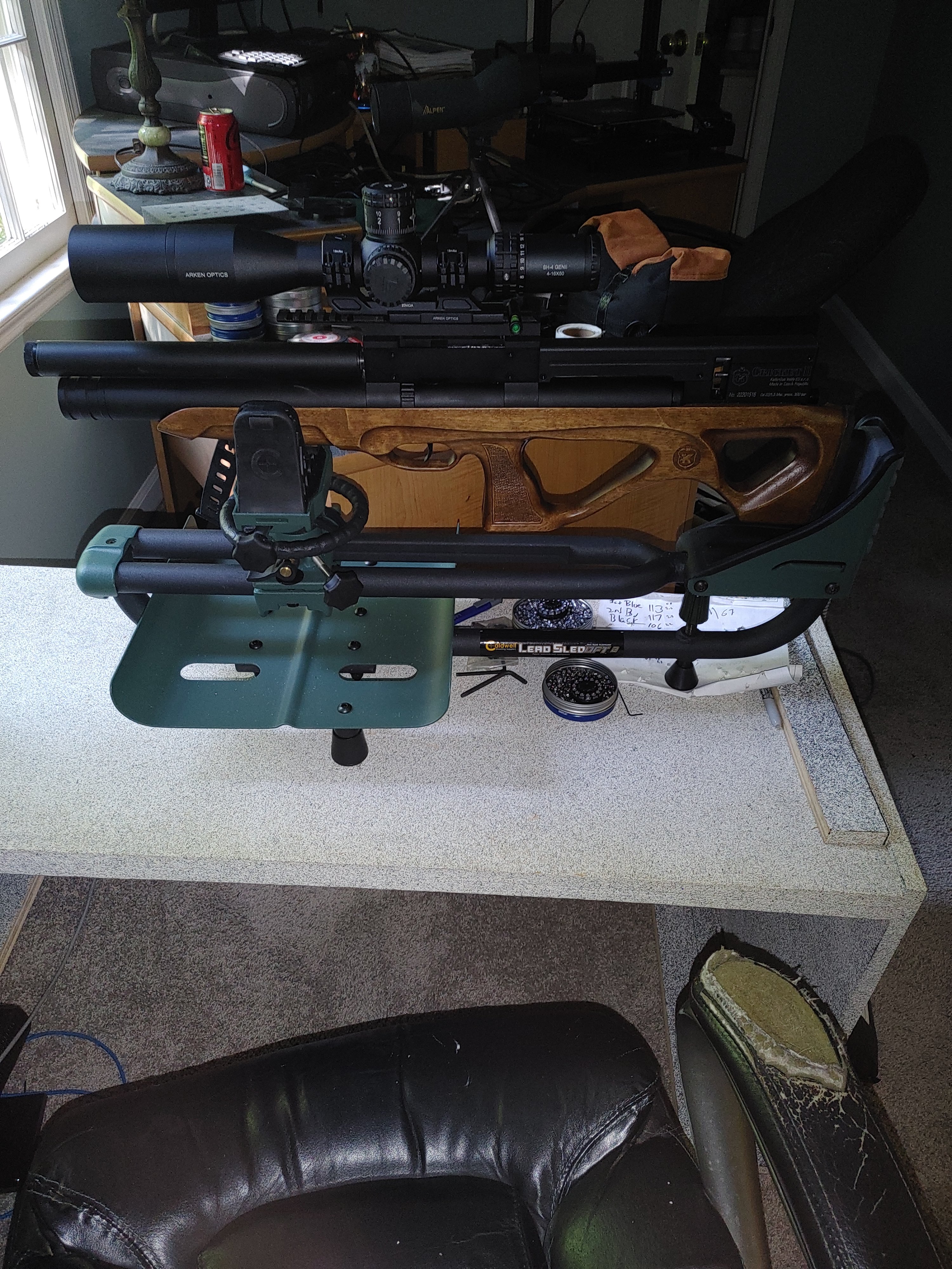

I wound up purchasing a Caldwell Led Sled but unfortunately its not ideal.
1) based on how high it sits and my shooting location down into the yard from a two story location its very hard to get enough angle for a 50yd zero.
2) the way the stock fits its extremely loose. I can use a ruber strap to secure the barrel but the side to side movement is way to much present.
3) the way the stock sits the butt cheek is so far back that it messes with your eye relief. So you have to adjust your seating position which isnt the most comfortable position.

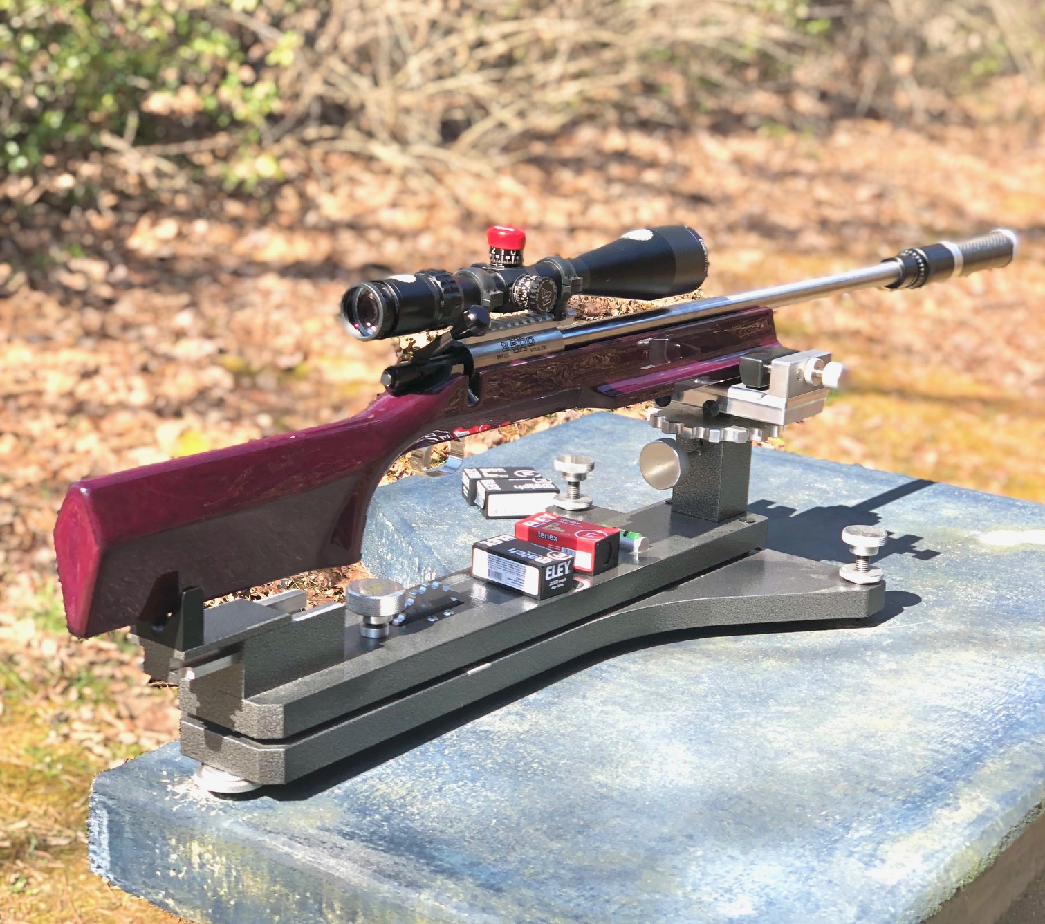

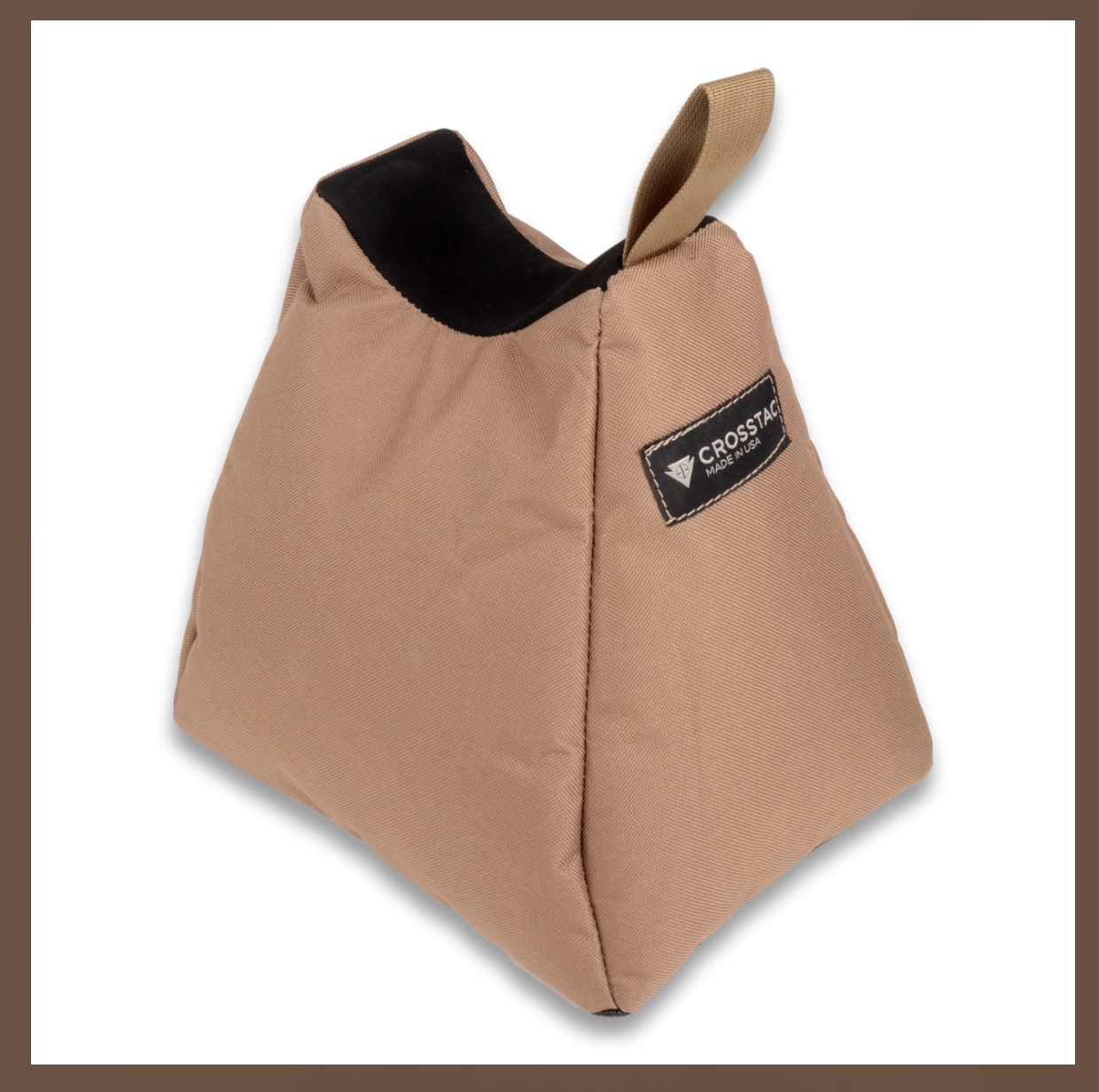

I’m not a benchrest competitor but like many airgun and PB shooters I do a lot of shooting off a bench to zero the scope and test pellets for group size at various ranges out to 100 yards.
Typically I use the shown Crostac bag but I notice some fine left right movement that probably doesn’t help group size. I’m thinking I’m going to pick up a Hog Saddle and see if that minimizes the motion. I’ll attach it to something or other to sit on bench as rigid as possible.

Many different techniques can work. I think the PB benchrest shooters use rests like a SEB or Sinclair. Rests which cost more than any of my PCPs. I bet they would help but I'm not ready to buy one. Caldwell had many much less expensive options. The Rock br would be my choice if I had to buy something I thought would help right now. Pretty substantial but reviews say it has a bit of slop in it. Spending 5 to 10 times more probably gets rid of the slop and adds precision to the movements. But using any "fancy" rest off a plastic flexible shooting bench isn't going to give the best results either. Concrete benches way to heavy to move are the standard for the PBs. I also agree completely with the sentiment already expressed that the shooter is more of the issue for most of us than the equipment. My choice for now, after trying several other setups, is a front bipod that adjusts for cant and a home made monopod in the back. Some guns might prefer a sandbag in the front but mine seem to do fine off the bipod.
