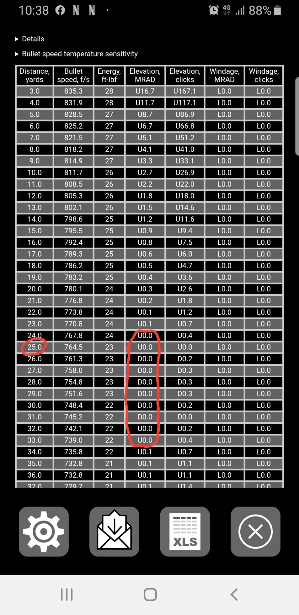

I use Strelok Pro and find what zero is best that gives me a flat trajectory dependant on velocity. I set it for hold over at all ranges, no hold under. For my Leshiy .22 as an example based at the current speed at 850 fps with JSB 18.13gr., I check which distance would give me the flattest trajectory. Zeroed at 25 yards, it's flat from 24 yards out to 33 yards.
