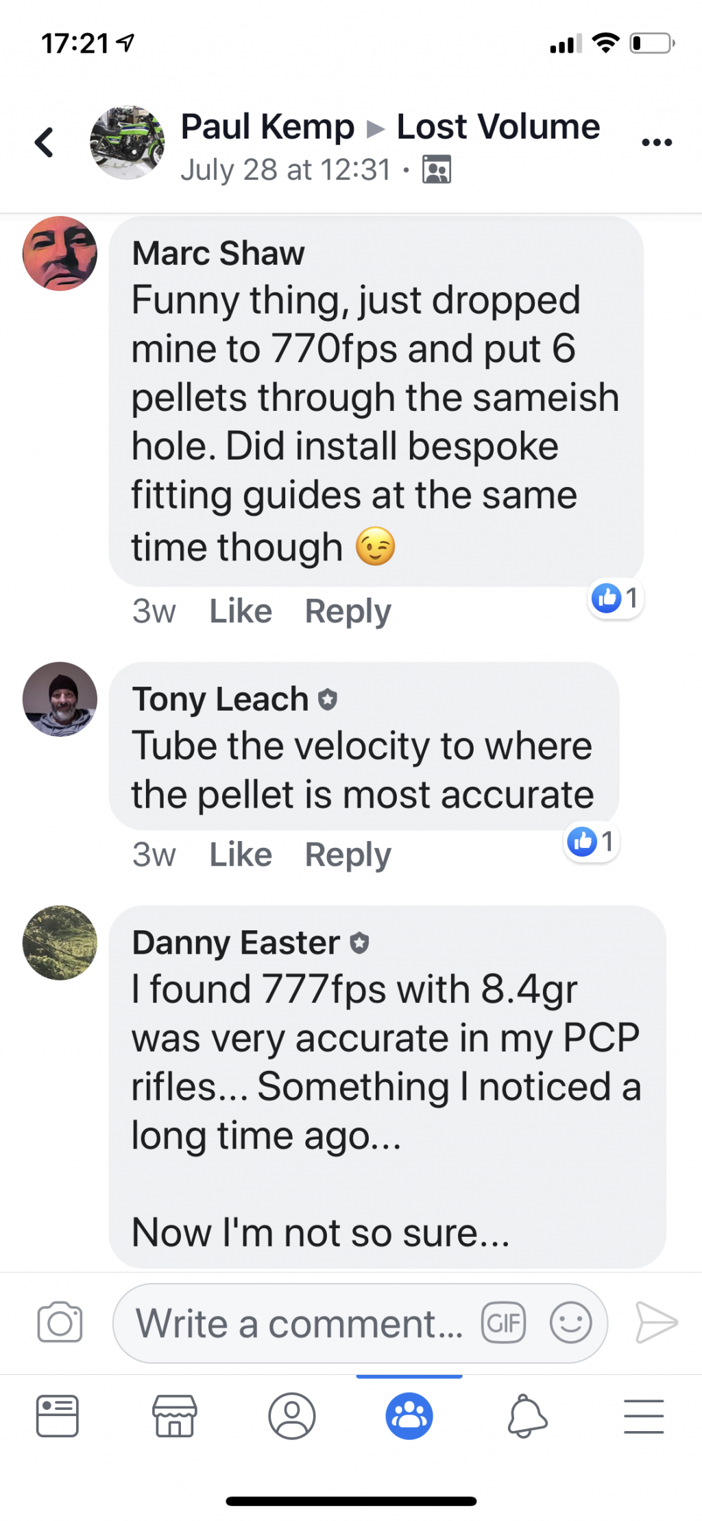

Interestingly enough, I was reading on the Lost Volume FB group the other day and this subject came up. There seems to be the notion out there that the 8.44 should fly at 777.
Do. Note Tony’s answer:

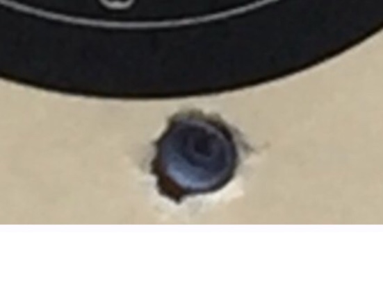

1566630335_13833261115d60e1bf40c6f0.56165412_97052436-CDF8-4F0C-92D6-E7140DB28468.jpeg
4 shots at 45yards rapid mfr .177 780fps the pellet is one that I pushed into the hole made by the others.
Bb
