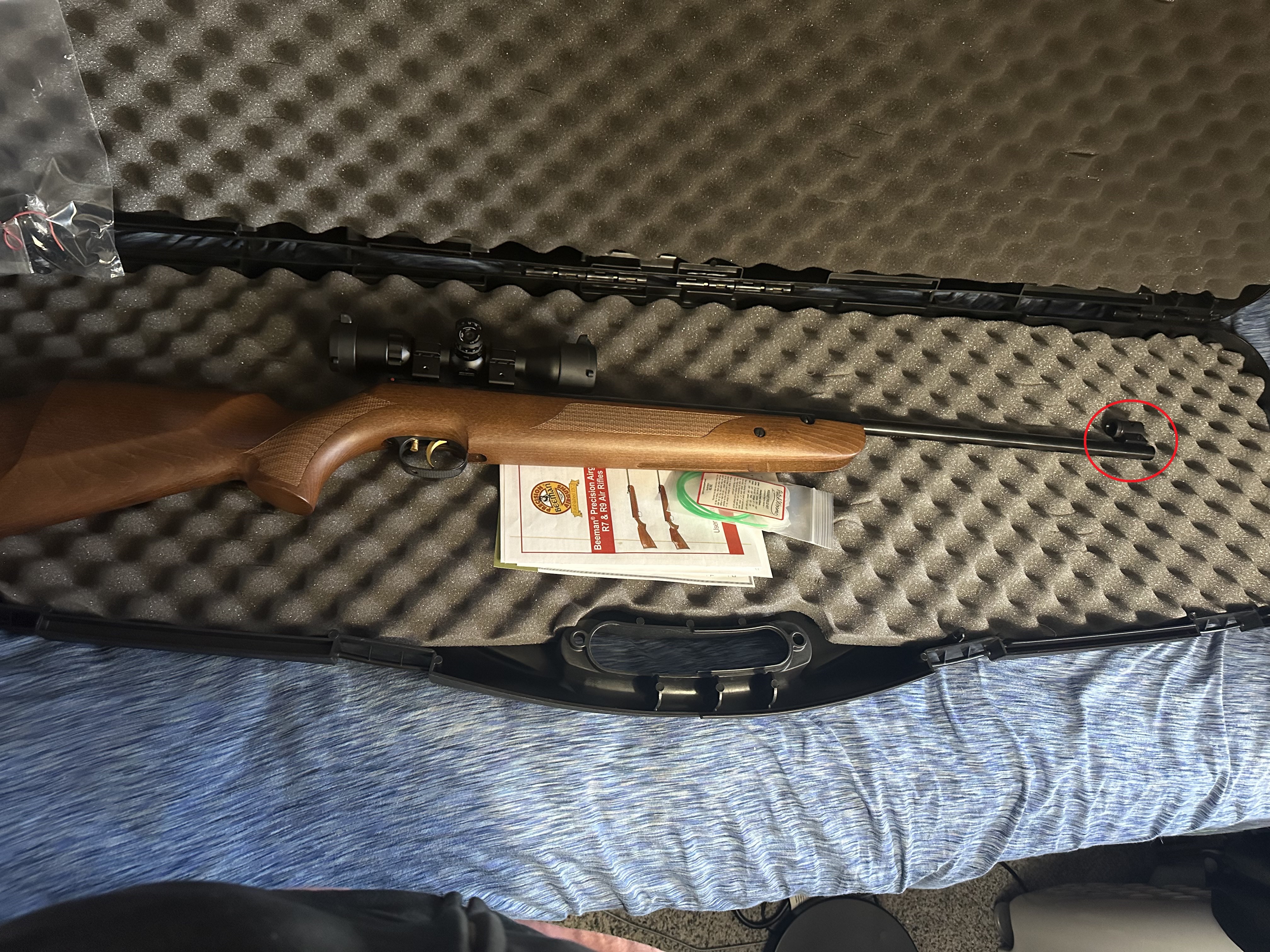

Pretty embarrassed to ask this since I have no shooting experience and I couldn't really find a answer. Do I remove the little metal piece at the end of the barrel once the scope is on? I had pyramid put the scope on and it was sighted for their 20/20 thing, but after trying to shoot a bit I'm unsure of if that's meant to be there?
It adds like a very blurry/out of focus circle when I look down the sight ... am I meant to make sure the scope crosshairs are within the circle? Once again so sorry for what is probably a very idiotic question lol. I just watched alot of videos on the rifle where some have it on and some have it off so I was unsure.

I took all mine off and I replaced them with a Delrin muzzle end that SpiralGroove makes.
Not as cold on the hands. Good luck. Crow

FWIW. I would install the UTG Bug Buster very carefully as not to scratch it so you can return it, if needed. I have one and like it a lot but not on a R9. The eye relief is to small. You may be okay with it but also may think it’s uncomfortable to get a full view. If so, I would recommend a full size Hawke model.

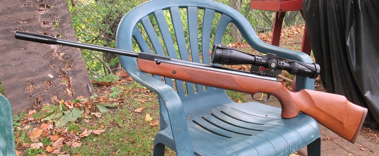

My R9 .20 and HW95 .22, both with Hawke Airmax 4-12x40 scopes. The R9 for a time (along with the R7 of the time) was made without an option for open sights and I bought mine gently used from a fellow member of the forum. Will give you an idea of what yours will look like if you decide to take them off. As mentioned, fellow member SpiralGroove makes very good Delrin muzzle breaks for them to cover and protect the front sight grooves if you decide to take them off.

My HW 95 has the open sights and I left them on. Shouldn't be any kind of problems seeing a ghost image in the bottom of the scope from it and I never have, but mine is set to 10 and like jccams said above, you might at lower magnifications? I've never lowered mine to see and can't honestly say.

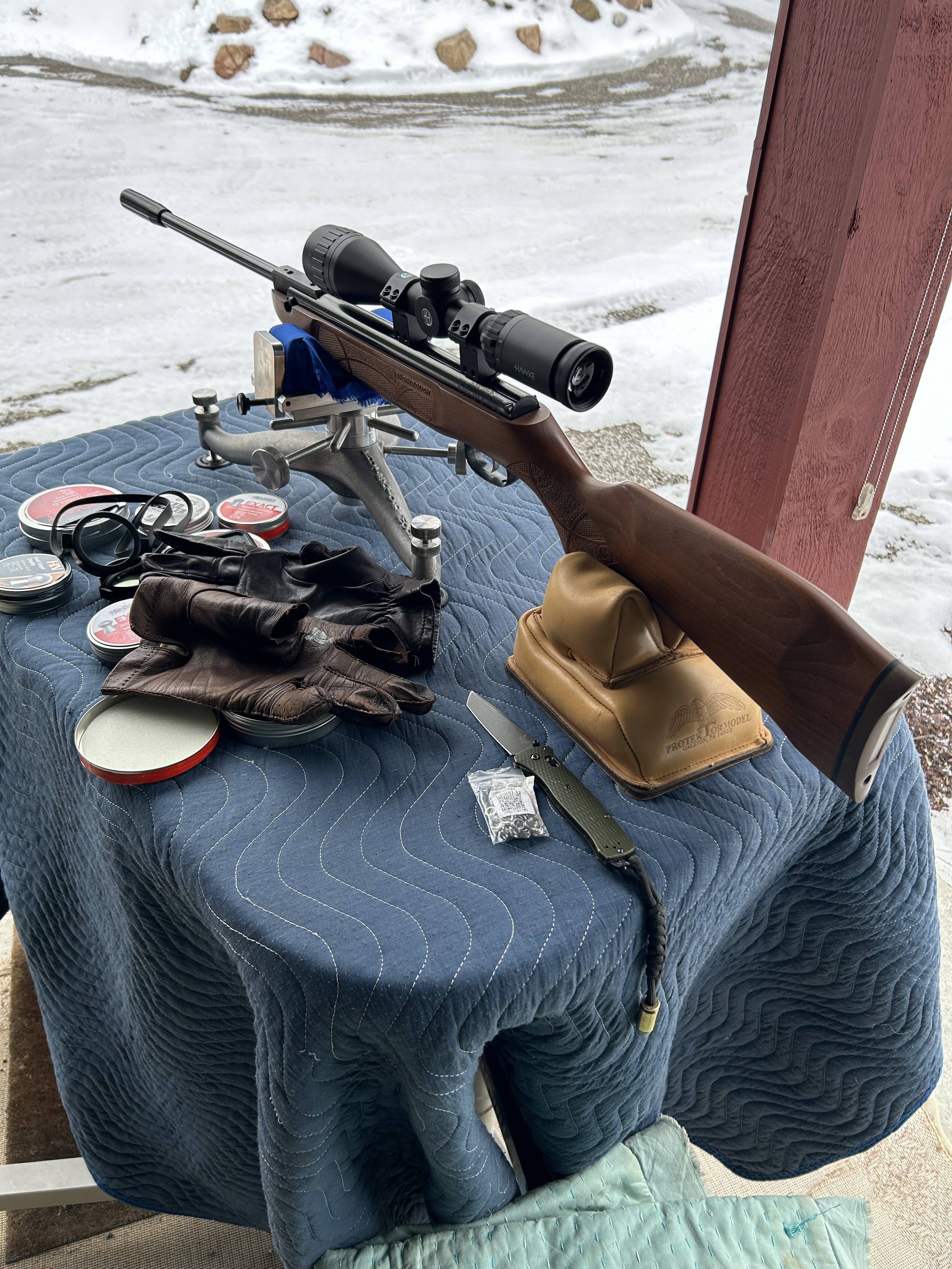

I finally got to spend a day shooting and yes, I & my friends dad agree, really need a scope with a bigger field of view. Otherwise it was a blast finally got some shots in! Surprisingly out of all the pellets I got, the Crossman premiers dome & Hollow point both gave me the best groupings
