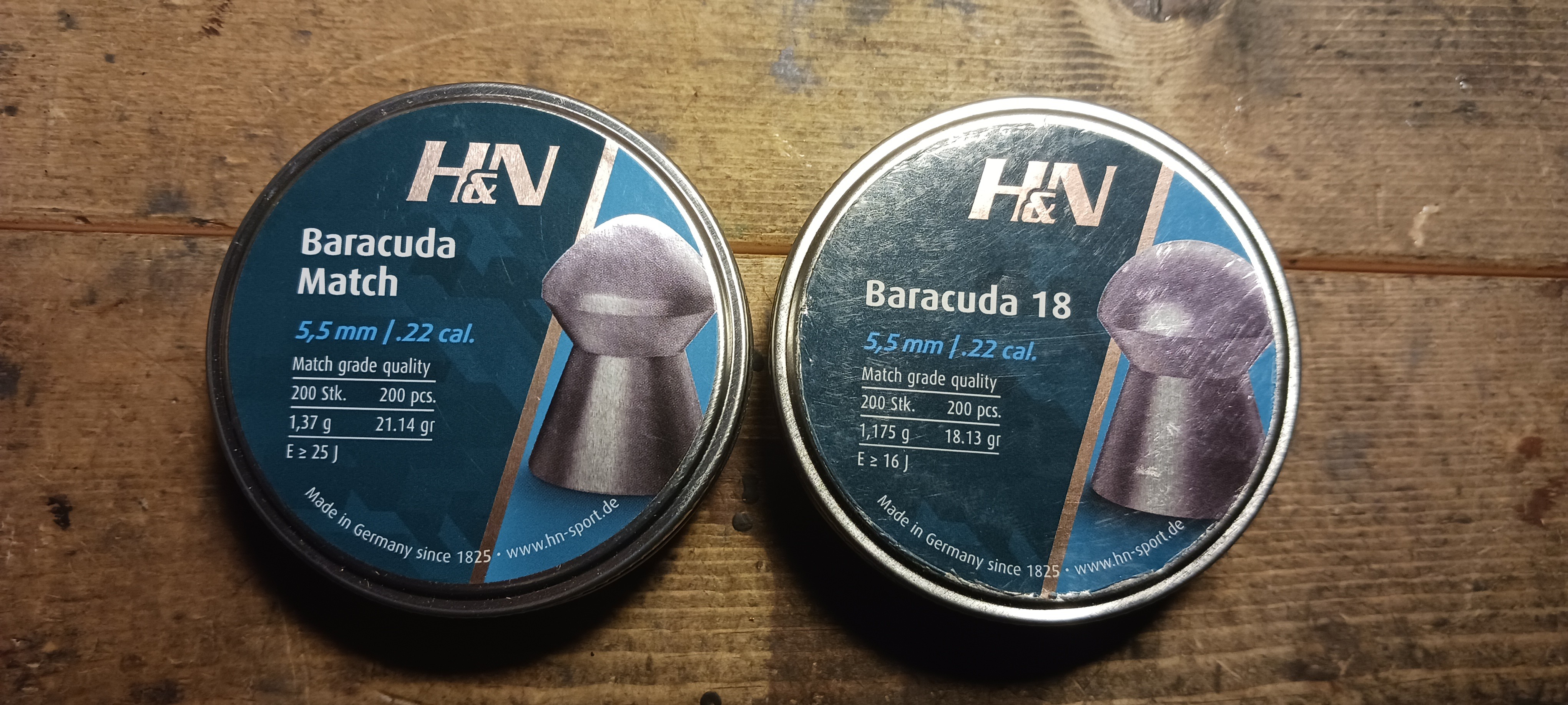

My 125 shoots both these very well. But your rifle could be different, Try a few different pellets, the gun will let you know what it likes best. The same goes with the hold. Each one is a little different.
Reactions: maxtrouble

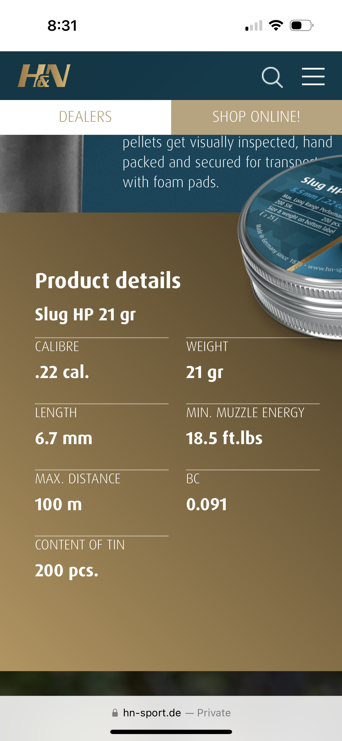

Actually I really like the looks of this round. What kind of drip do you think I’m looking at 50 yards with 20 yard zero?
Depends on your speeds, but probably about 1-1.5mil drop at 50. But I highly recommend you get to know your gun with pellets first. Slugs can be....frustrating. Even for experienced airgunners.

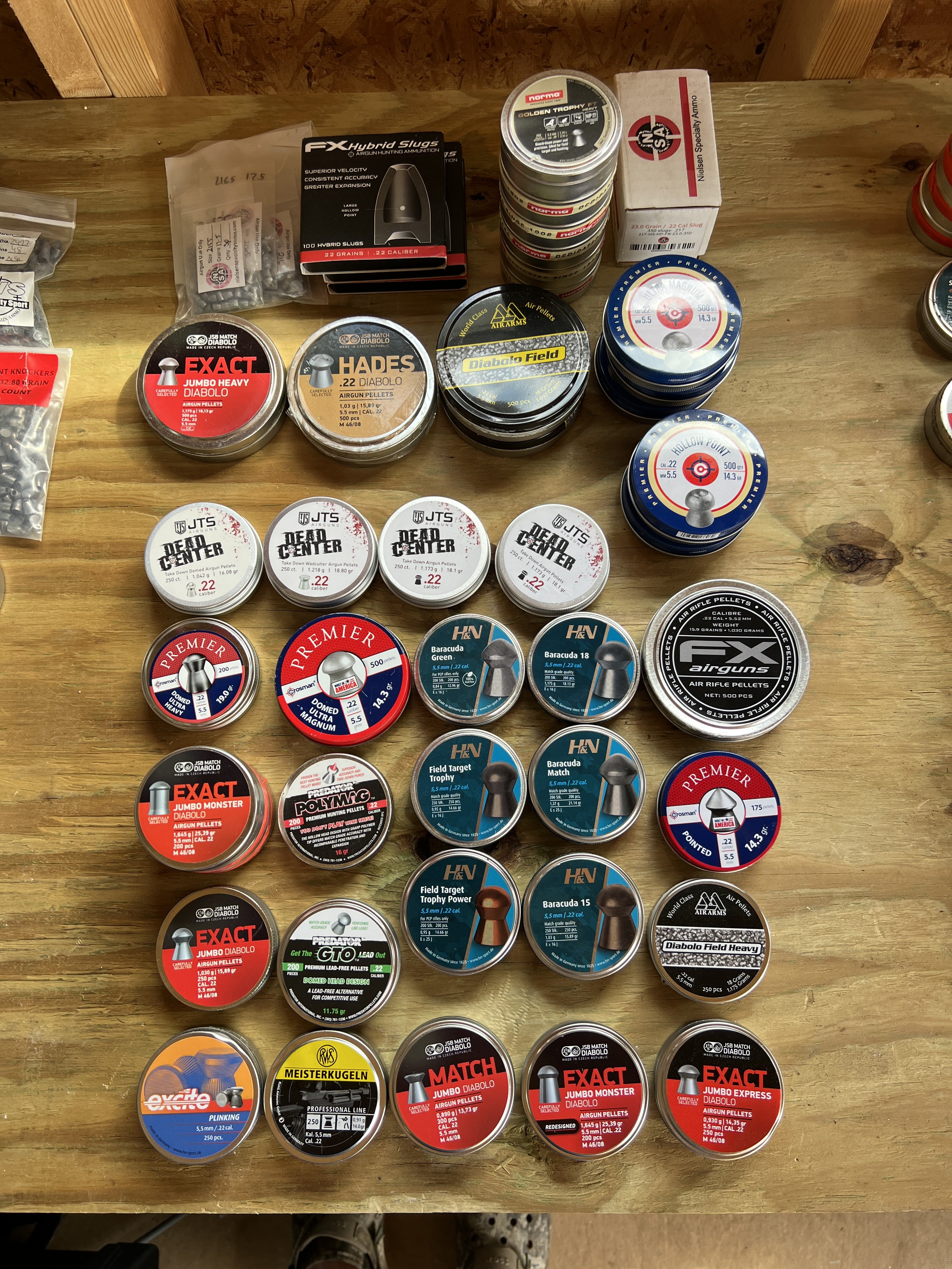

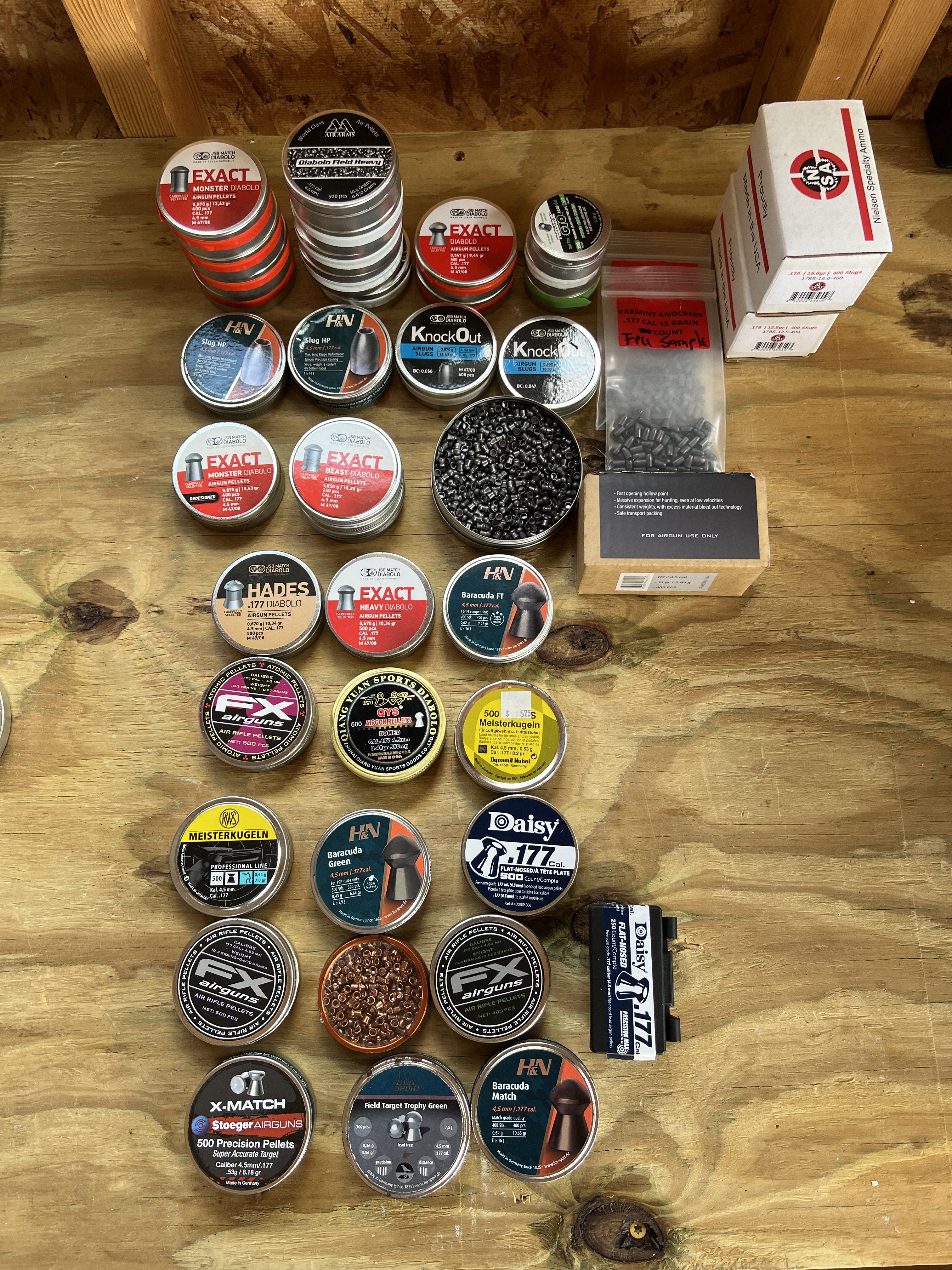

I don’t have a collection of pellets like a lot of people, but I have a good deal to test with. From shooting most brands of pellets, through approximately 10 different Airgun manufacturers, I always try the JSB’s and Crosman first.
Ive really hoped I’d have a rifle come along that prefers H&N, because I love their interaction on the forum, but unfortunately most of my stuff prefers JSB. But you never know, so I still try.
This was a few months ago, I have more now 😂
Now there is a stack of JSB and FX 18gr because that is what my Concept Lite prefers.
sorry to burst your bubble,
but truthfully,
slugs are for pcp airguns,not break barrels
never saw a break barrel ever shoot them with anything resembling accuracy.
a break barrel calls for pellets,
pick up some jsb or h&n pellets.
Your gun has sufficient power (28-30FPE) to shoot the light slugs (NSA has one as light as 17.50gr, even the 22gr FX Hybrid could work):
However — like others remarked, if you are looking for
▪︎ precision beyond 20y (squirrel kill zones are tiny!) and for
▪︎ consistency —
slugs are very often(!) frustrating. 😵‍💫 (Slugs are one of the airgun rabbit holes that can be fun — but it is a deep hole indeed....)
Pellets are much more accomodating — most airgun barrels are manufactured for pellets (with a tight choke).
