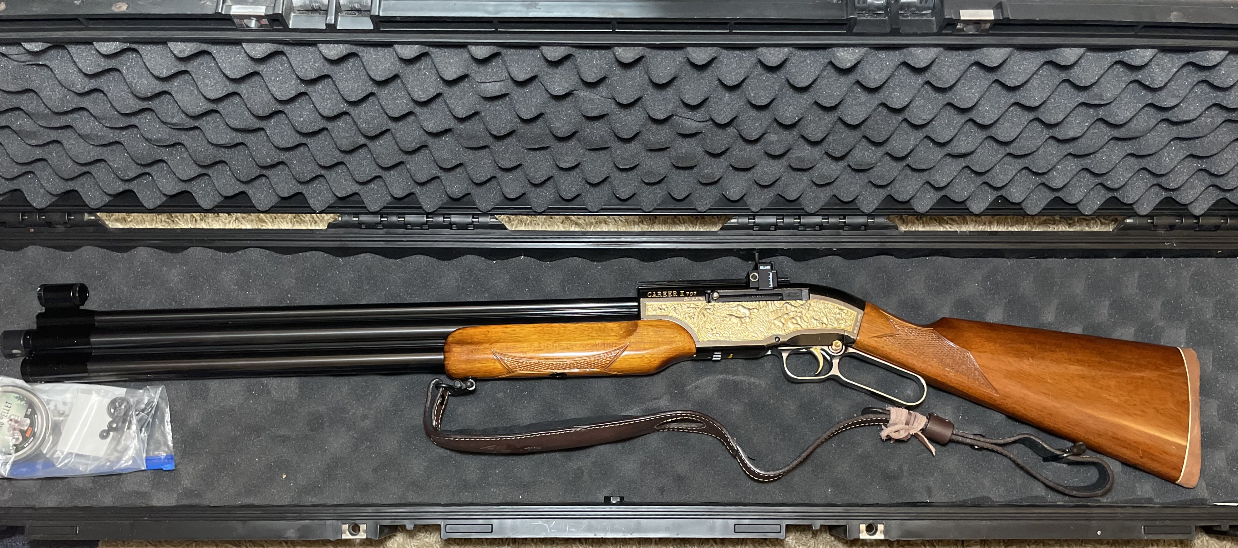

Yea I could care less about stick mags for PCPs but it’s interesting to see the ingenuity it took to develop one for a pcp. The career mag on the other hand is simple and reliable. Only drawback is you can’t keep them preloaded. Need to 3d print a cap to hold them in place. To bad t manufacturers aren’t making lever action pcps. The careers have proven reliable and one helluva fun rifle to shoot. Especially after Will’s treatment. Haven’t had one issue with my careers.
