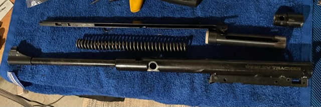

A friend picked up this springer at an auction for just a handful of dollars because nobody was bidding on it, then gave it to me.
I shot it some at 20y and got 3" groups. Anyway I tore it down hoping to find a very bad O-ring, piston seal, or broken mainspring but I did not find anything like that. Just old, dusty, and a little rusty on the outside, and the mainspring was bent some toward the back. The tube was nice and shiny inside.
I don't intend to keep it.
Option 1: sell it (give it away) for parts or a project
Option 2: buy a rebuild kit ($70) and see if I get get it shooting usefully well before passing it along. Would make a solid kids gun, around 9 ft-lb. It would be very frustrating though if the issue was not resolved by the rebuild.
Just searching for opinions and experiences here.

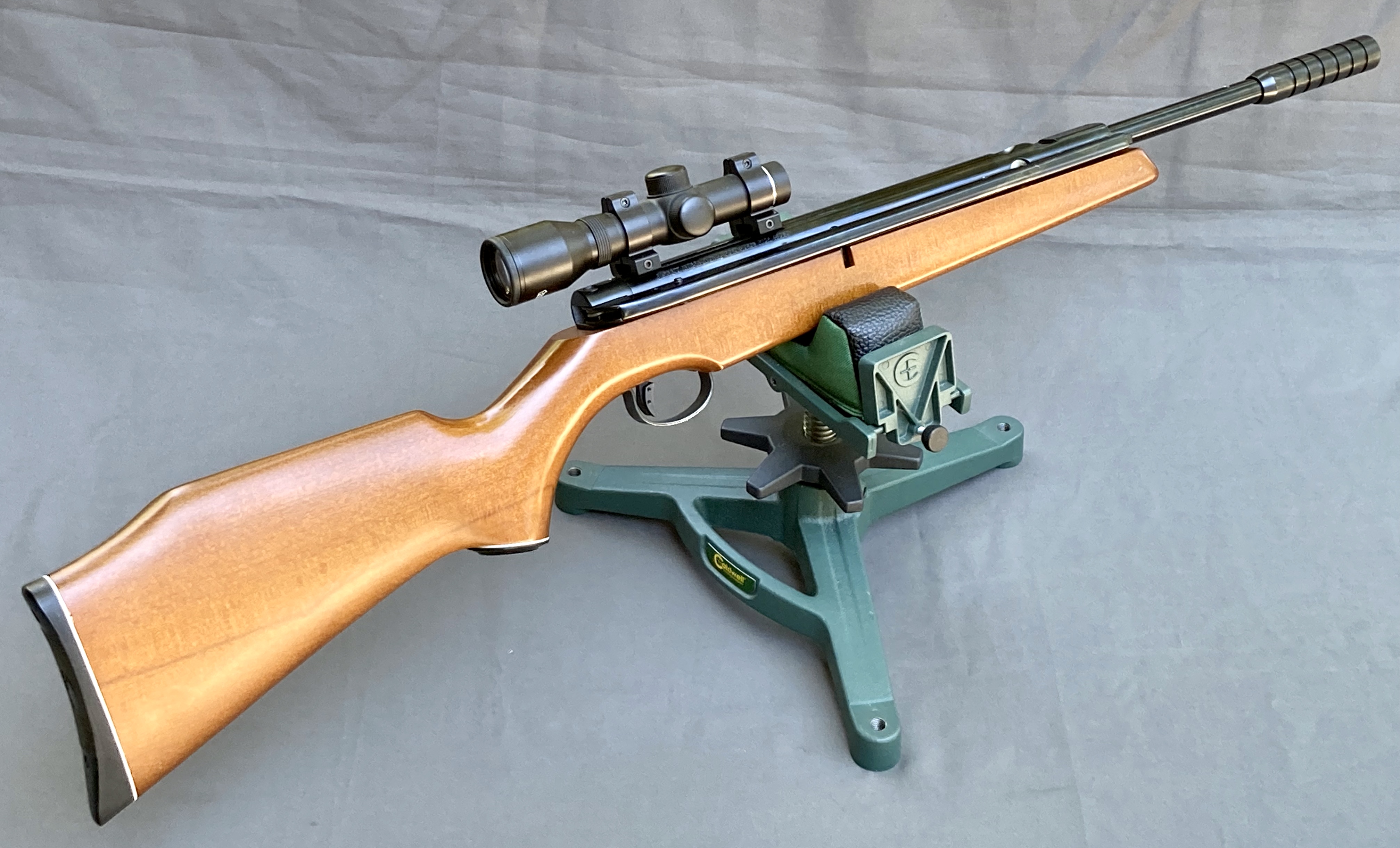

Please post pics of it? The Tracker is one of my fave Webleys - elegant styling, fantastically solid construction, and top-quality metal finish. If you really want to sell it I'll get in line behind Hw9720 (seriously). Pic is an early one labeled as a "Barnett Spitfire."

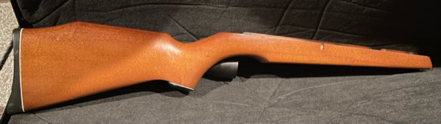

I have someone local lined up to take over this project. The construction is definitely sturdy. The blued metal needs some help but the stock is in good shape.

Looks pretty good! You got a rare-ish version with the open front sight; the majority of Trackers had a muzzle weight there. The holes at the breech will take the mostly synthetic adjustable rear sight used on the Vulcan rifle, Hurricane pistol, and other Webleys of that era.
As KWK noted, the spring guide on these is weird. Early ones had no true guide at all, later ones had the "spring tamer" which was a plastic gizmo that just floated free inside the spring. I'm not familiar with tuning kits available for these but if someome makes a real guide that would probably be a plus.
