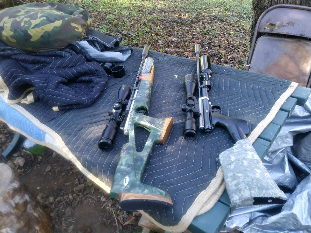

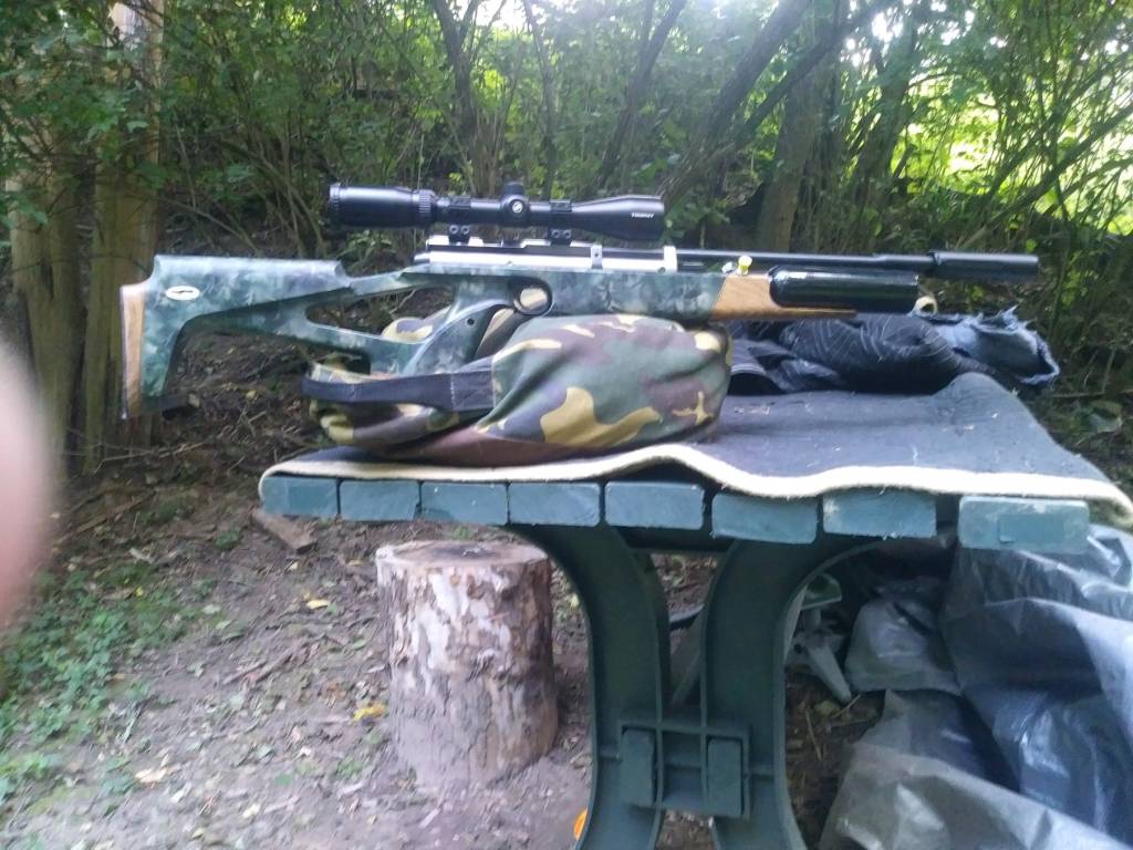

I have a different opinion than the other responders - yes, the re sale value of a Disco or Maximus has taken a hit with the arrival of sub $300.00 repeater pcp's -
BUT - if you enjoy tinkering, bottle conversions are a blast, and a learning experience.
I have recently done two bottle builds, one based on a 2250 Cothran Machine ss tube, and the other a cut down Disco tube.
If you use a Discovery tube, the gauge will read the preuuse post bottle reg, and the bottle gauge naturally reads the pressure in the bottle.
I'm running 1800 psi output, but 1600 would most likely work fine.
