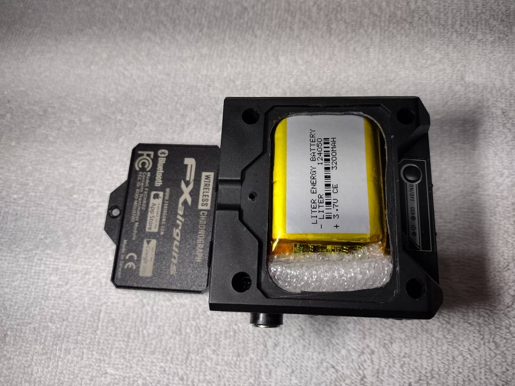

After about a month of having the Pocket Chrony converted to LiPo...I hate it. It was a fun project and I learned some stuff, but I found that a LiPo battery was not the right choice, since storing a LiPo battery at full charge is terribly hard on the battery. The Pocket Chrony doesn't work at 3.8v, which is the storage voltage for LiPo, so I have to use a fully charged 1s battery to run the chronograph. Since I generally use the chronograph in short increments/sporadically, as I don't tune all my guns at once, this means I'm never draining the battery down storage voltage by using the chronograph. This leads to a "workflow" such as:
Need to use the chronograph -> plug LiPo into charger -> wait for 30-45 min for battery to charge -> use chronograph for 10-15 minutes -> plug battery back into charger to run a discharge cycle down to 3.8v
Other than just being an asinine amount of stuff to do just to use the chronograph for 10-15 minutes, this has raised two problems.
1) Every time I want to use the chronograph I am using a charge cycle on the battery pack, which LiPo's have a finite amount of.
2) I have inevitably gotten lazy, which means that I have one LiPo that I've designated the chronograph LiPo and it's just left fully charged and plugged into the chrony so I can use it at a moment's notice. While more user friendly, I hate that I'm ruining a LiPo pack, even if it's just a $6 1s pack.
So what now? Does anyone know if there's a battery chemistry that does well/okay at being left fully charged besides the AA's that the chrony originally used? The other option is to do as others have in this thread and build something to modulate the voltage down from a higher voltage pack. I'll have to see if there's any micro sized gadgets that will modulate a 2s pack down so I don't lose the portability of the system.

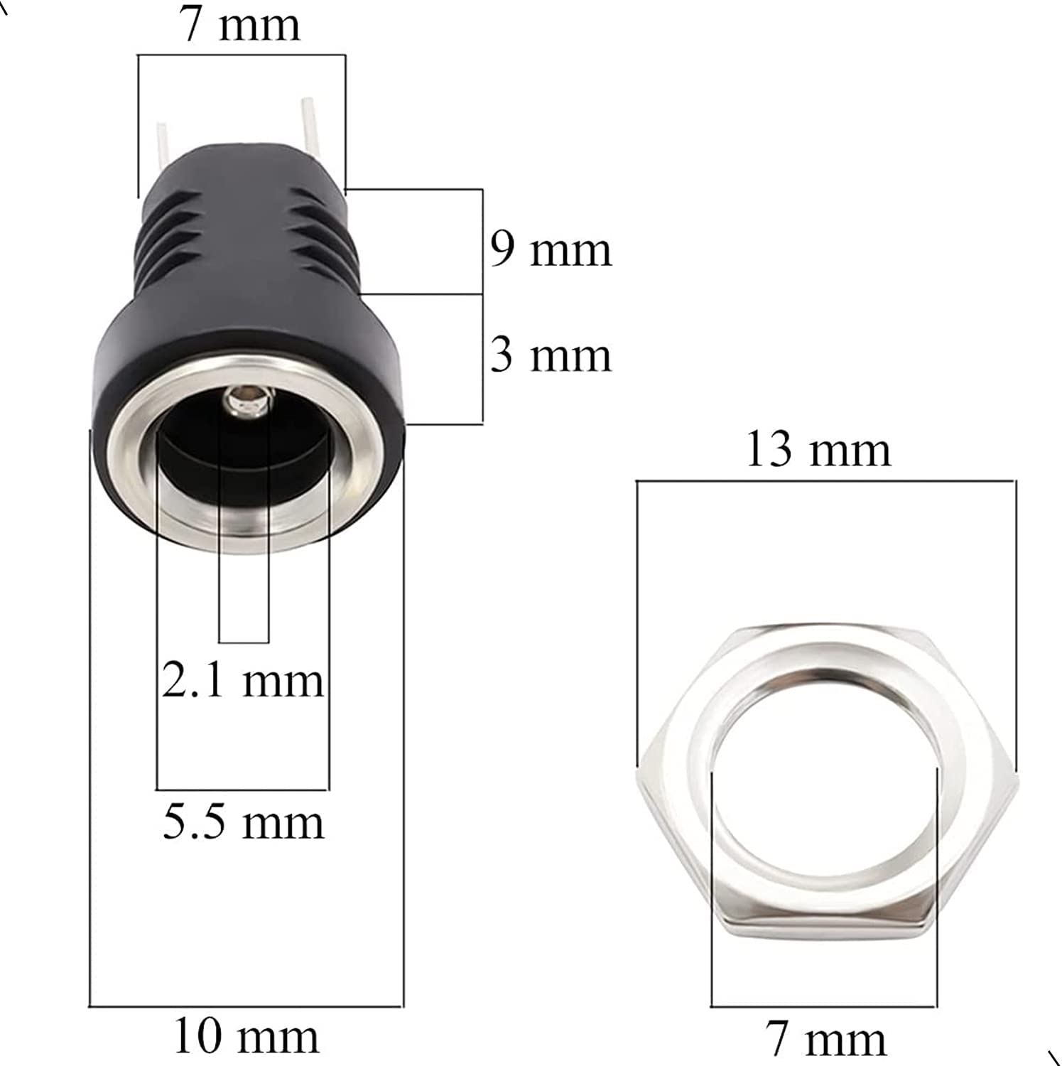

If you open up the Chrony, you'll see a spot on the side if the circuit board which is an obvious location intended to mount an external power jack. This spot corresponds to a hole in the case. You could get fancy and try to find a jack that will mount there, or you could do what I did and take a USB cable that is sized appropriately for that hole in the case, cut one end off and solder directly to the circuit board. Now you have a USB pigtail that you can connect to either:
