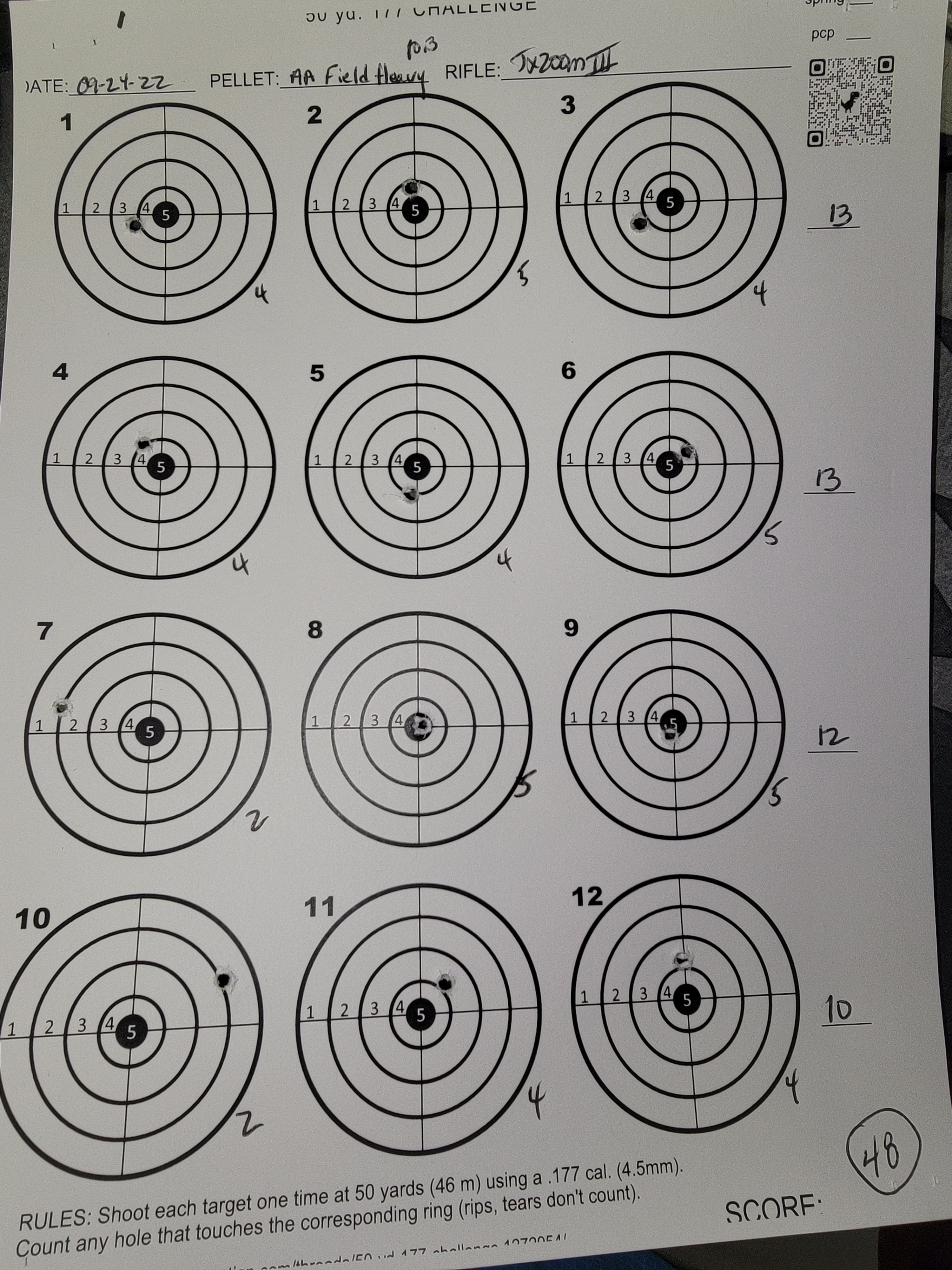

There is a .177 50 yard challenge going on in that area of the forum. The target used there works well for springer guns. Here is one of those as an example. The "5" is about .25" and 4 is about .50" if that helps.
For a comparison I looked at the USBR (mean green) targets. The full bulls measure about 2" with a 1/2" spaced between. The 9 ring is about the size of the bull used in EBR 50 yards. These are used at 50 yards for rimfire, centerfire, air power benchrest. The ARA factory class targets have boxes measuring 2 1/8". The largest circle is 1 7/16" with about a 15/16" "100" ring. So the EBR targets are pretty rough on the springers at 50 yards.
