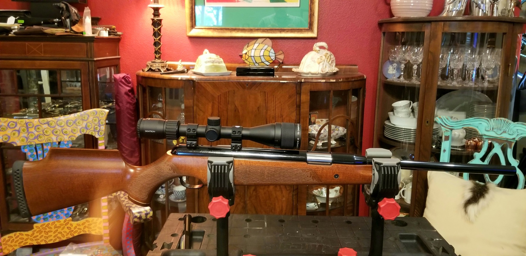

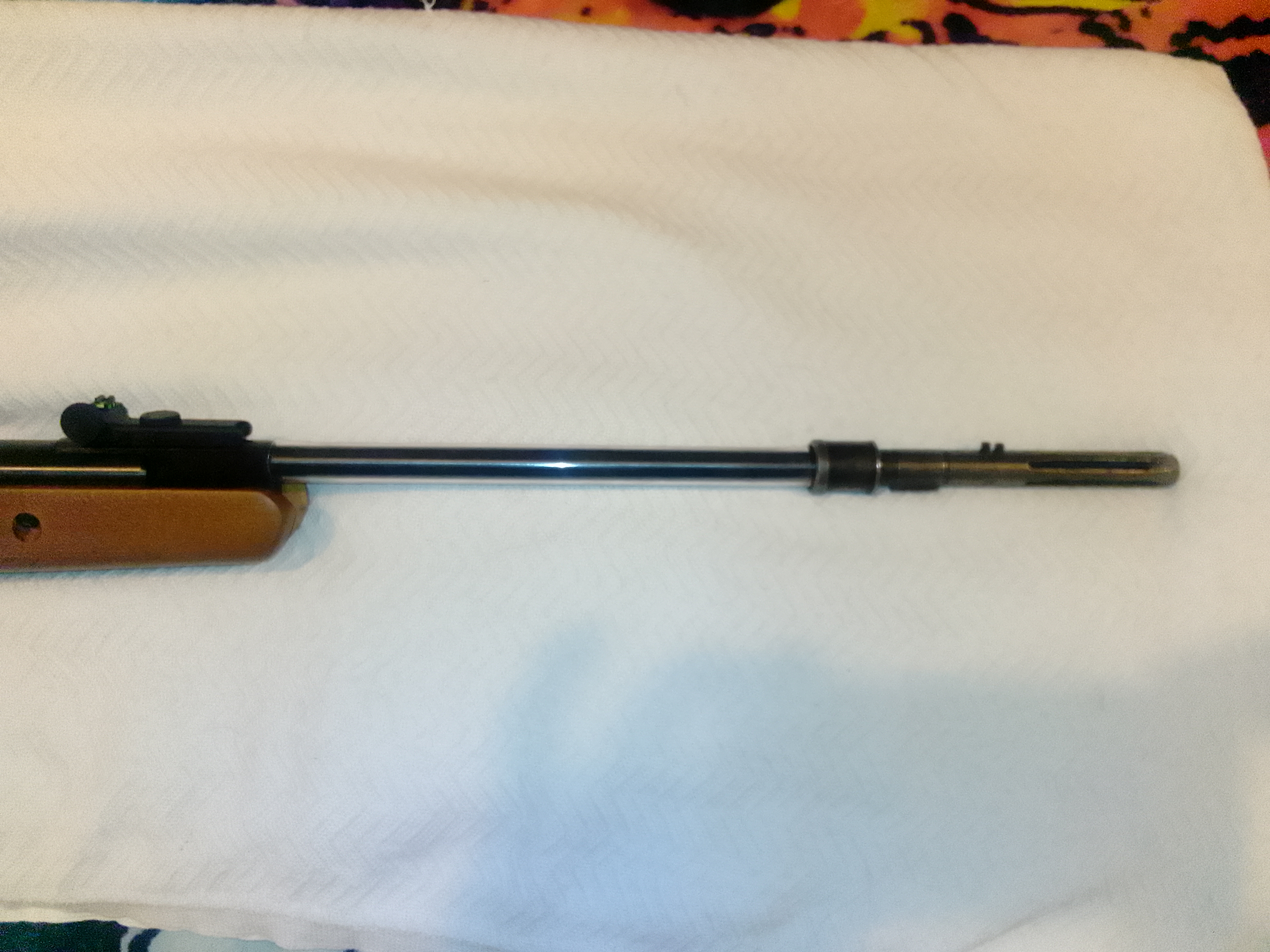

A few days back when I was shooting the Diana 250 the front sight fell off. I was glad just got in the way of scope.

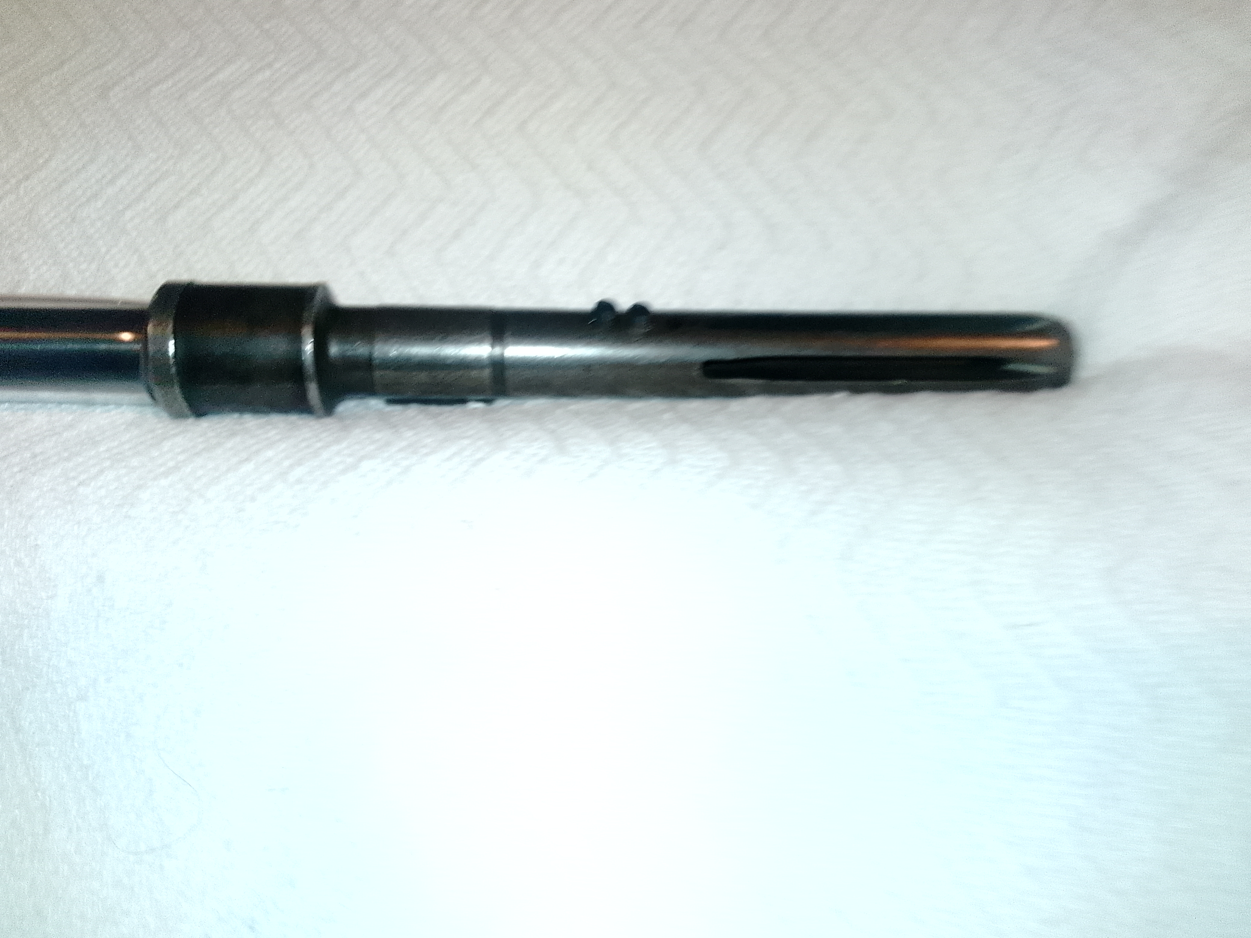

Today I was going through a box of old gun parts , and found G1 flash hider for a FAL. I tried that as an extension on the 250 , and it fit great slipping over the barrel of the 250. It gave me enough extension to be able to cock it with 1 hand. There was a flat on the end of the 250 barrel where the all plastic front sight was , so I drilled , and tapped the flash hider for a couple set screws and put it on. It's looking great , and was shooting great with it on there. I also added some plastic tubing over the barrel as well. For a new gas ram with only about 100 shots through it things are working out great. OV .
