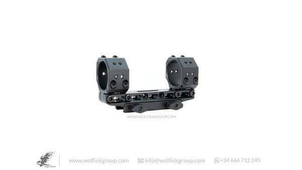

EagleVision makes adjustable one-piece scope mounts that you might want to take a look at.
Of course, then there's Spuhr mounts, made in Sweden, which many top competitors use.

Yes, I like the eaglevision products, but the problem I am seeing is they advertise the mounts as best suited for airgun use. I would assume the 308 short charge may have a considerably higher kick... The Spur is highly regarded but that is also reflected on the piece price.
Edit: got an answer from eaglevisioncam, their scope mounts are not designed for 308 recoil.
