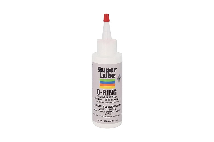

But then I saw today that they have super lube made just for o-rings https://amzn.to/2X2AuSi  is this going to be a better choice?
I have had a person tell me recently I want to use a silicone grease on the o-rings and not oil, I have never used grease on the o-rings of any of my guns.

Super Lube for O-rings #56204

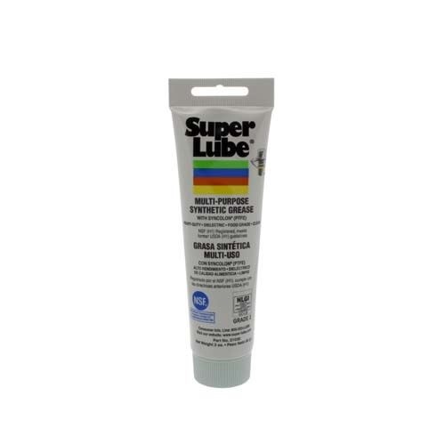

Super Lube for surface/threads #21030
They both work exactly as they were designed to. You can use each with confidence. Remember though, a little bit goes a looong way.

Krytox GPL-206 for o rings, Lucas sticky red heavy grease for threads such as ldc's that like to stick like glue and hard to get off for cleaning. Super Lube 21030 is my # 2 choice for this. But the Lucas is superior for threaded items that are not used or removed often.

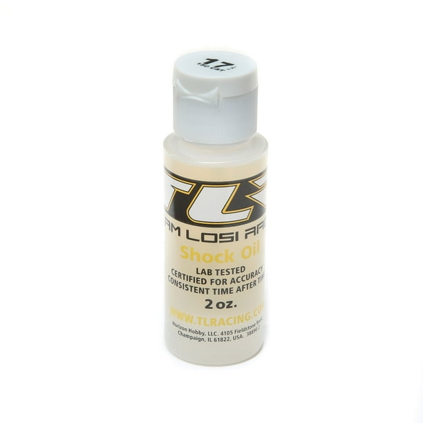

10 to 15 wt rc shock oil for slugs. Picked up a tip from Matt Dubber for the shock oil. He adds a little petroleum jelly melted into the rc oil for slugs. Sounded odd, but I tried it and it works wonders for slugs.

Knife,
How do you apply the shock oil to your slugs? Do put a few drops on some foam and roll the slugs around on it?
