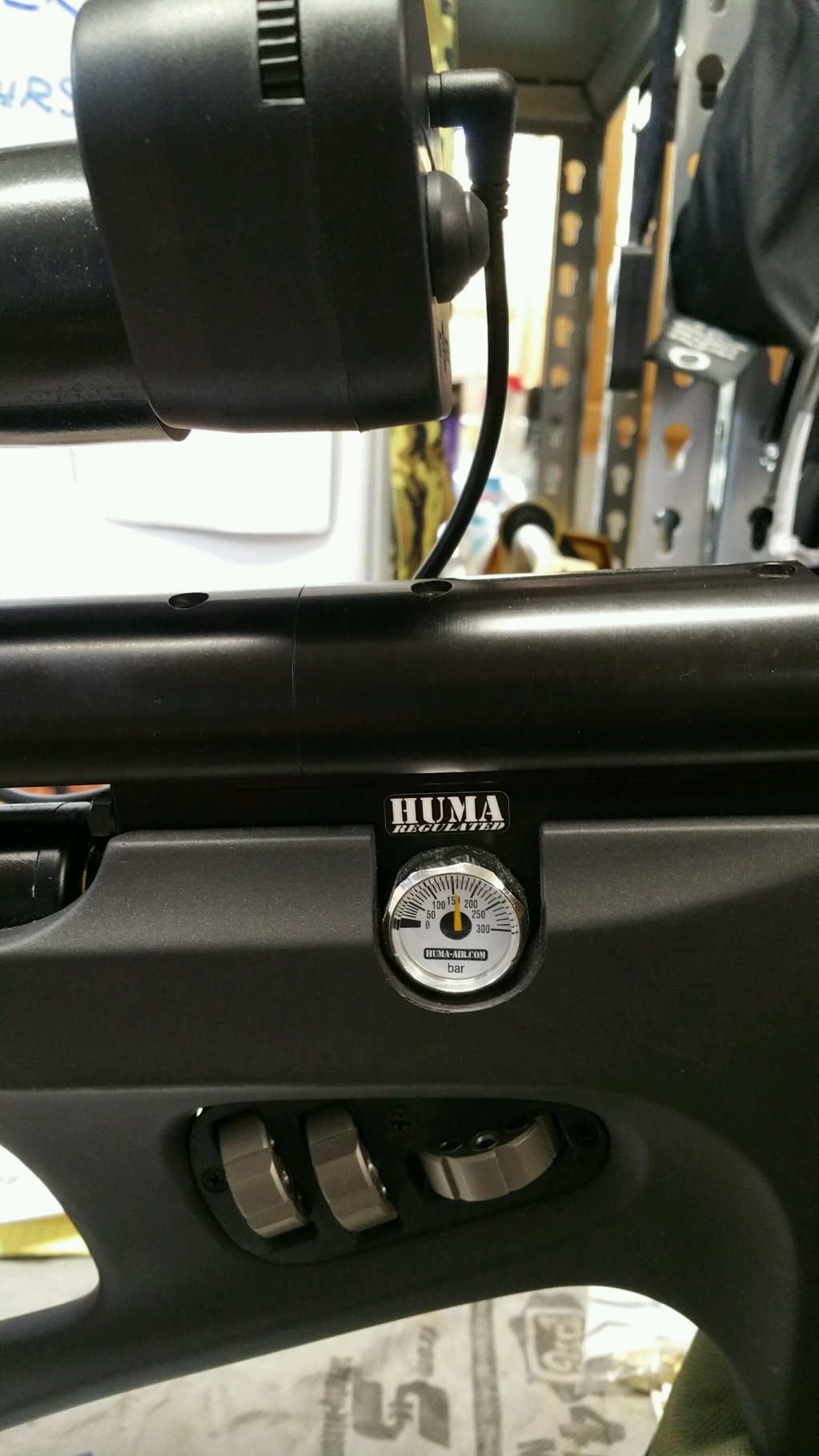

I shoot my .30 wildcat at 840fps and reg at 147bar. Reg was factory set at that. I turned it up from 130fps out of box. This is my most accurate FX product. I shoot under half inch at 80y and .8" at 103y with this super gun. 28 shots before I fall off reg. Very quiet and very accurate. Cut stock to leave huma reg test gauge installed to watch for irregularities. No problems with amp reg as of now. Probably around 800 rounds through gun now. Have the supplied Donny FL moderator from factory.
Monkeyshine, if you don’t mind, can you post a couple of close up pics of where you installed that Huma gage? Where does it thread into? Is the threads 1/8” NPT? I have a 1”, gage, the one from McMaster Carr that reads 0-4000 psi. Will that work? I was going to install it on my PRod, but I think I might want to use it on the WC. I mainly just want to see how yours turned out, cutting into that stock.

Here you go ragu.....
