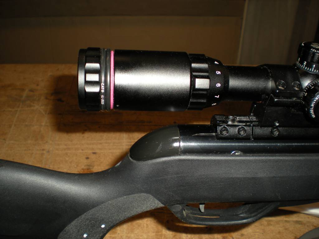

Gamo Whisper Fusion Mach1. 22,000 shots on a UTG True Hunter 3X9 AO. The only problem found is as with most budget scopes the fast focus loosens up and causes poi change. The pic shows that I installed some Orings to correct. Unfortunately adjustment is reduced.
