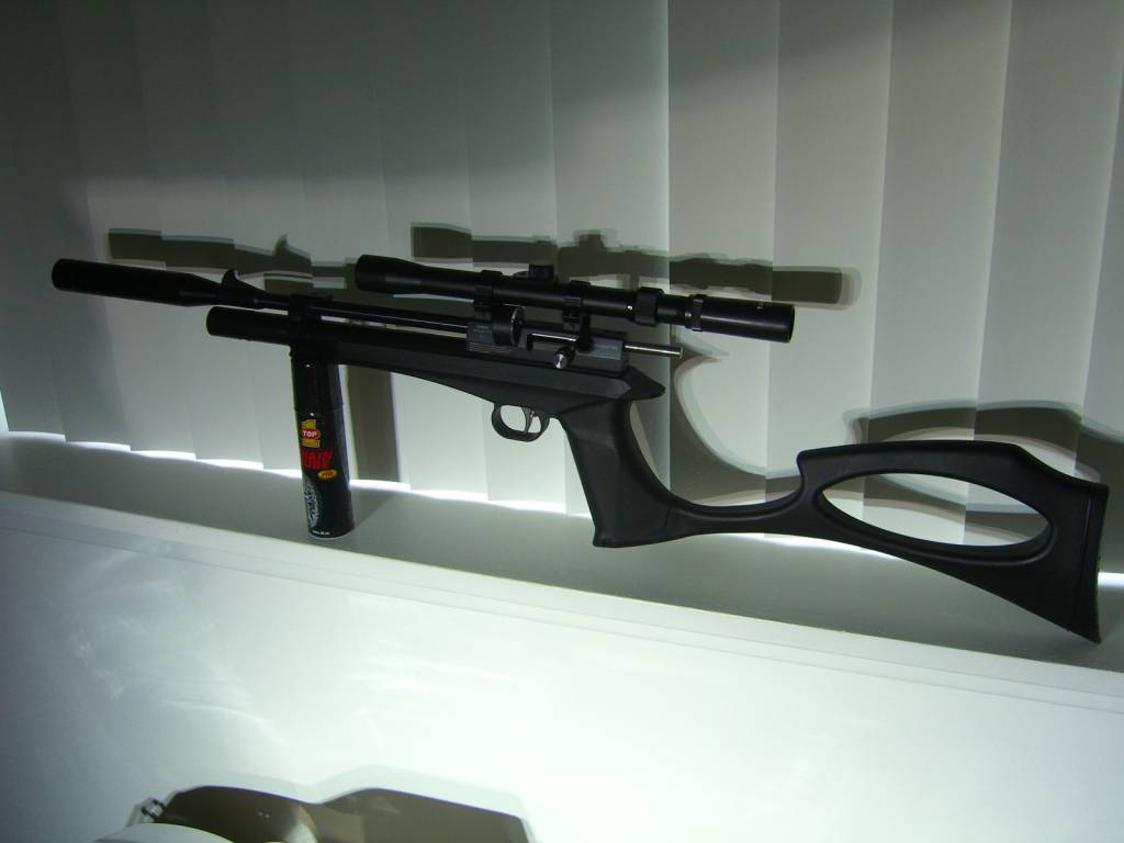

i was horrified when i realized this little micro size tasco 3-7 scope does everything most scopes under 150$ do
best 15 bucks i ever spent haha -->

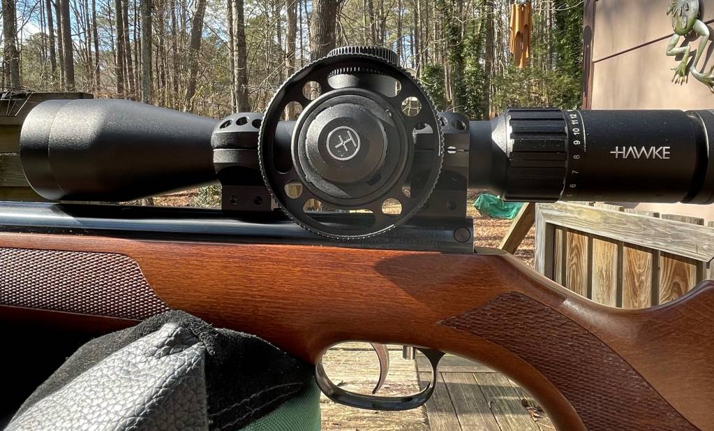

The Hawke vantage 2x7x32 is probly the best $100-150 scope you will find.

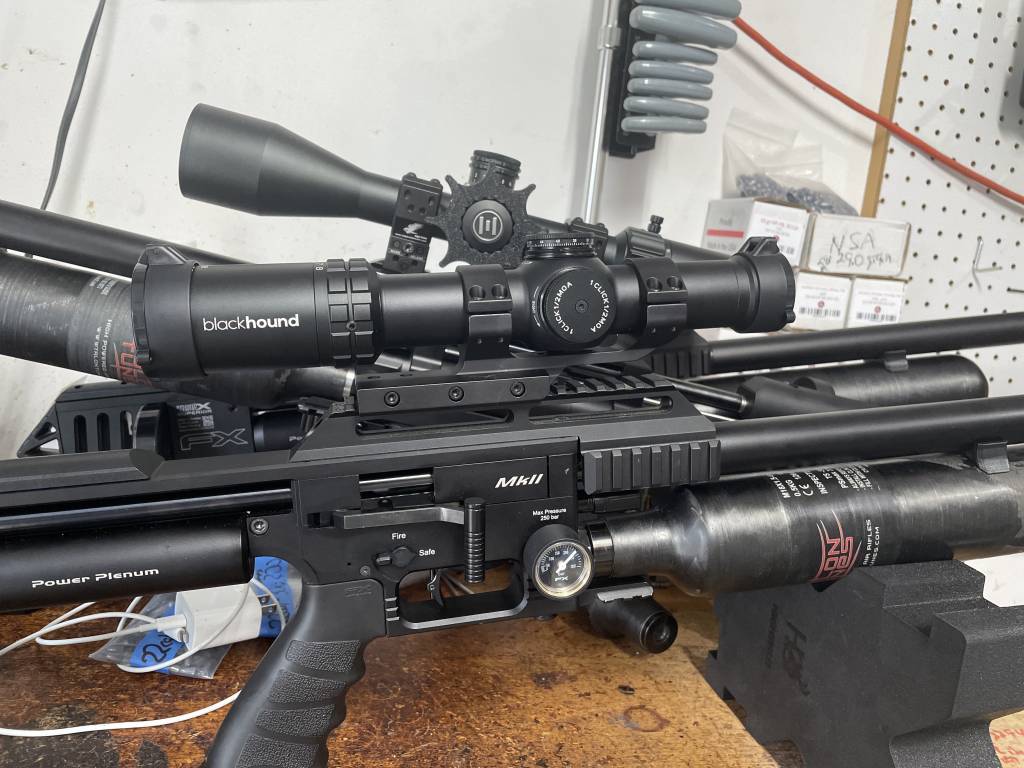

How is the eye box on that black hound 1-8? I’ve heard it’s tough to get a check weld. Looking for something to fit a woods walker, and this fits the bill, but I’m worried about eye relief.
I haven't had any issues with cheek weld or reticle acquisition. The Blackhound comes with scope rings, 34mm, but I also used the FX no limit rings and found they gave me an issue while the scope rings from Blackhound lined up perfectly.
