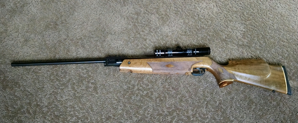

Jim, The 124 I recently bought came with a Bushnell from that era. The objective lens is only 18mm. I'm hanging onto it because the condition is like new, and it's really light. But I'm l'm looking for some original open sights, too.
