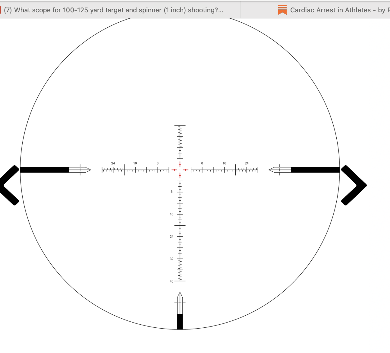

Most definitely not a Element, the cross hairs are like telephone. I like the Arken it has a .3 MOA dot... i.e. TINY and it's hard to see but with the illumination it's great. I like them so much I'm buying another BUT a ELP, they were on sale, I couldn't resist. But if you really want a Titian, I've got a MIL that needs a new home. I may have a MOA laying around, I have to check.
