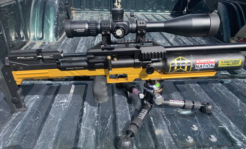

I have my brand new Maverick and I mounted a one piece medium rings I was using on my RTI gun and I noticed I had to give a lot of elevation, when I finished zeroed the scope was almost maxed out, I think I have just around 10 clicks left. This doesn’t make any sense to me knowing the gun comes with a 20 MOA rail.
one thing I noticed was that the distance from the scope to the shroud is way bigger on this gun compared with the RTI, didn’t think this will make such a huge difference.
I know FX no limits rings will probably solve the problem and that’s why I’m asking, what rings are you using? Did you have the same problem?
I'm using Burris XTR rings on mine with about 40 MOA in the rings on top of the 20 MOA rail. That's not necessary at all, but I have tons of elevation I can dial up now :D I have noticed that the FX barrel system does tend to have a bit of droop to it, especially with a good sized moderator. I'm going to work out a way to make that barrel system more rigid at some point on my Maverick though. I also have a new scope and a 20 MOA single piece mount in route to test. I'll report back when I do. You could also go with the FX no limit or Eagle Vision rings. I believe UTG even has some adjustable rings now as well.

I'm pretty sure the rail is 20 MOA, but the droopy FX barrel system is about -30 MOA 😆. I'm only knocking FX a little there, because they are still very accurate barrels. When I got my Maverick, I moved a scope from another gun that I shot a lot of long range stuff with. That scope was on XTR rings with the maximum MOA inserts. I was worried I would have to change out the inserts to ones with less cant, but not so. It's also a lesson in scope purchasing. I've passed up many scopes, because of lower ranges of elevation adjustment. If a scope doesn't have at least 60 MOA of elevation adjustment, I don't want it for an air gun. Every scope I own has 80+ MOA of elevation.
