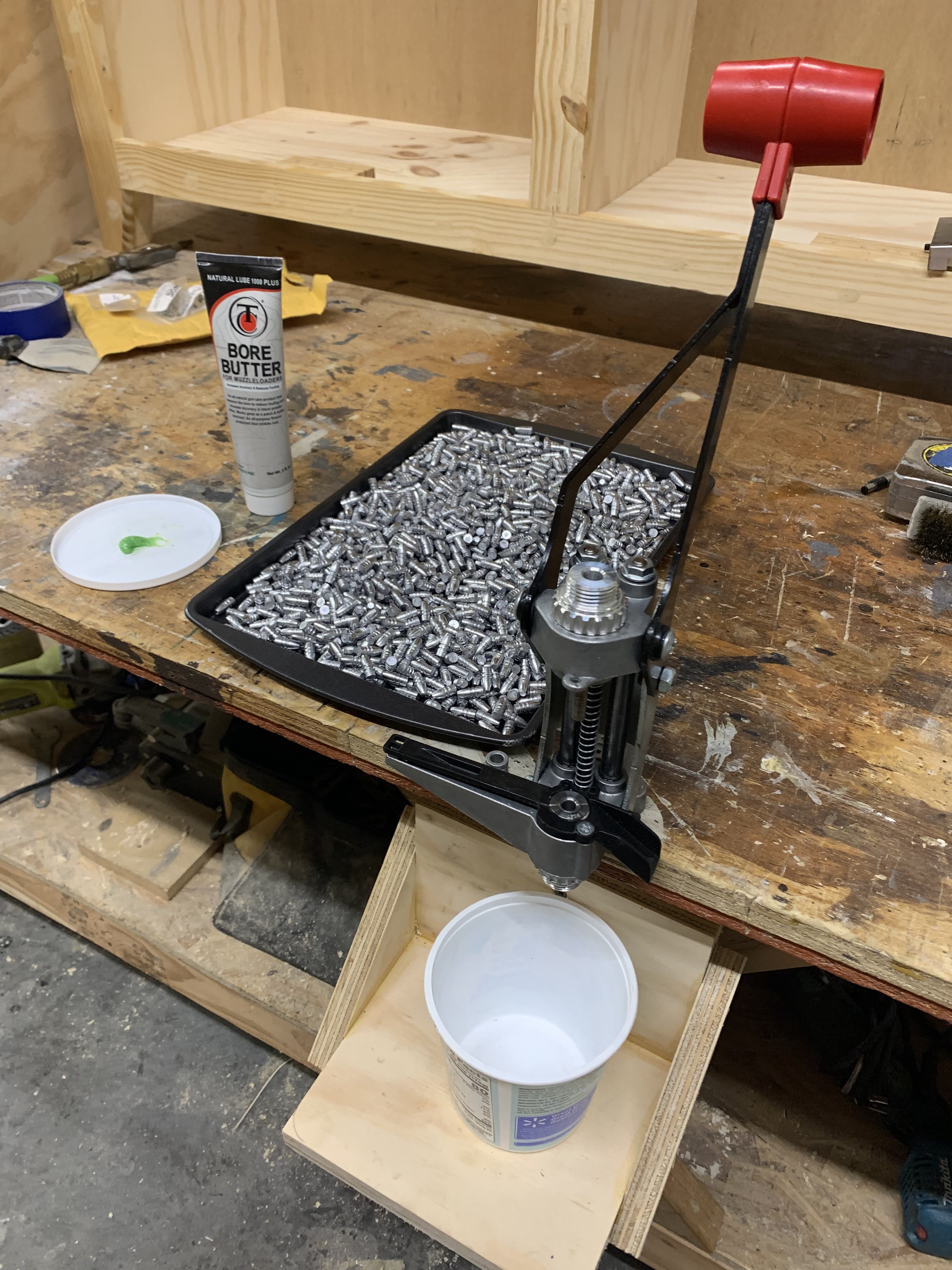

I've been using this Lee press since I started casting myself. NOE's sizing system fits it and of course Lee's sizing dies. Works very well
Reactions: Airgun-hobbyist
Lee APP press and NOE sizing bushings.
