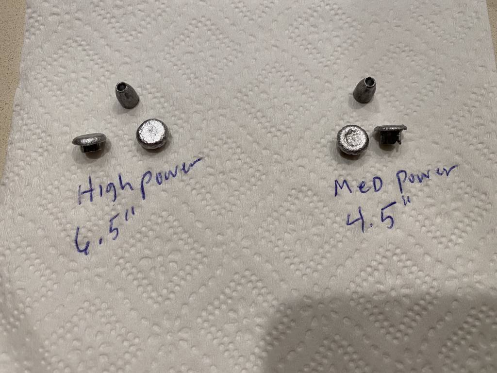

Daystate Safari .25 cal on High power, AVS 34g .2513 dish slug. I use this on collard doves and pigeons at the dairy for pest control ... More DRT’s then other slug I’ve tried.10 yards into ballistic gel.

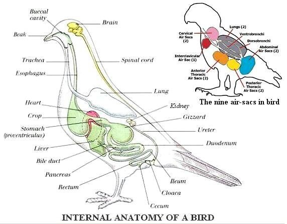

It is all about shot placement-beware of a side presentation chest shot. It seems the bony bend of the wing is some kind of vortex that draws the pellet. A hit at the bend of the wing will knock down the bird but it will revive and take off on foot, NOT what you want to have happen! My Marauder is low tuned to around 22 ft. lbs. it's effective out to 50 yards or so in good conditions. A while back someone posted a cutaway view of a pigeon showing the vital areas-I'll see if I can find it.
Here ya go-

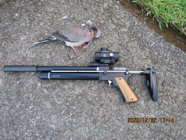

I been taking many Columbiformes with my PP750 (20 in one day), and previously with a Talon P. The PP750 shoots JSB 15.89s in Diabolo and Hades at about 16FPE. I stick with crop shots, as that will mess them up dead. I have seen a couple profile shots bounce and skid right off the wing primaries with terminal energies of 13-14FPE. These imported doves carry avian pox viridae to which our native birds are naive. The virus eats away at keratinous tissue, so a native bird without toes or a beak is not so uncommon.
