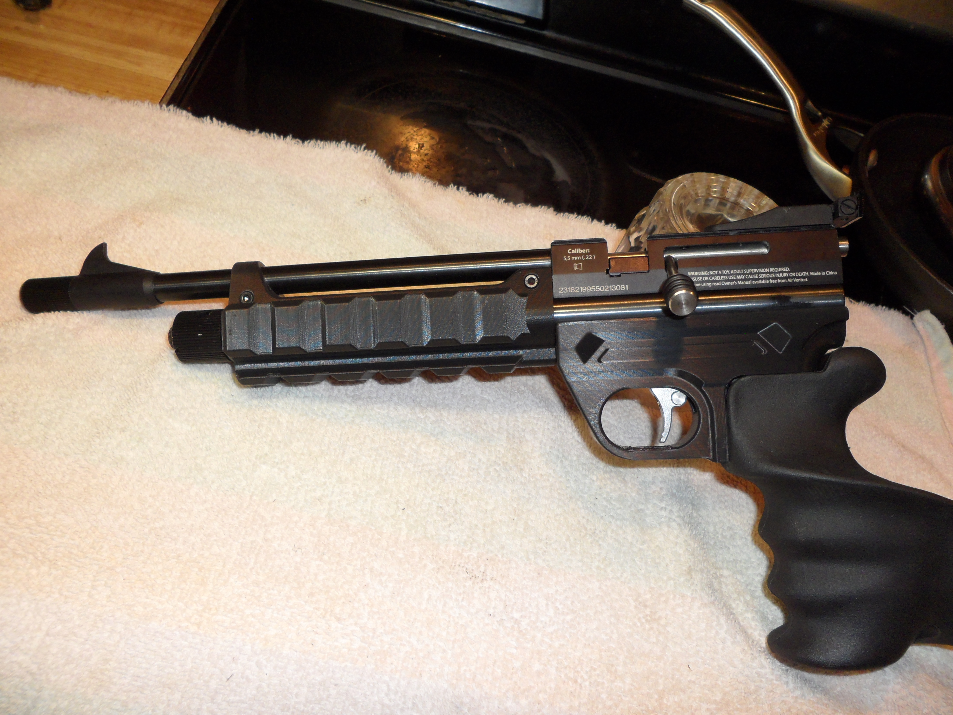

I like my Diana Chaser .22. Has great iron sights that are usable with a Buck Rail surpressor that screws on to the built-in barrel accessory threads. I supplement the iron sights with an under-mounted laser red dot (requires add-on Buck Rail barrel band).
Is very versatile as it accepts an optional seven shot magazine, stock and alternate rifle length barrel.

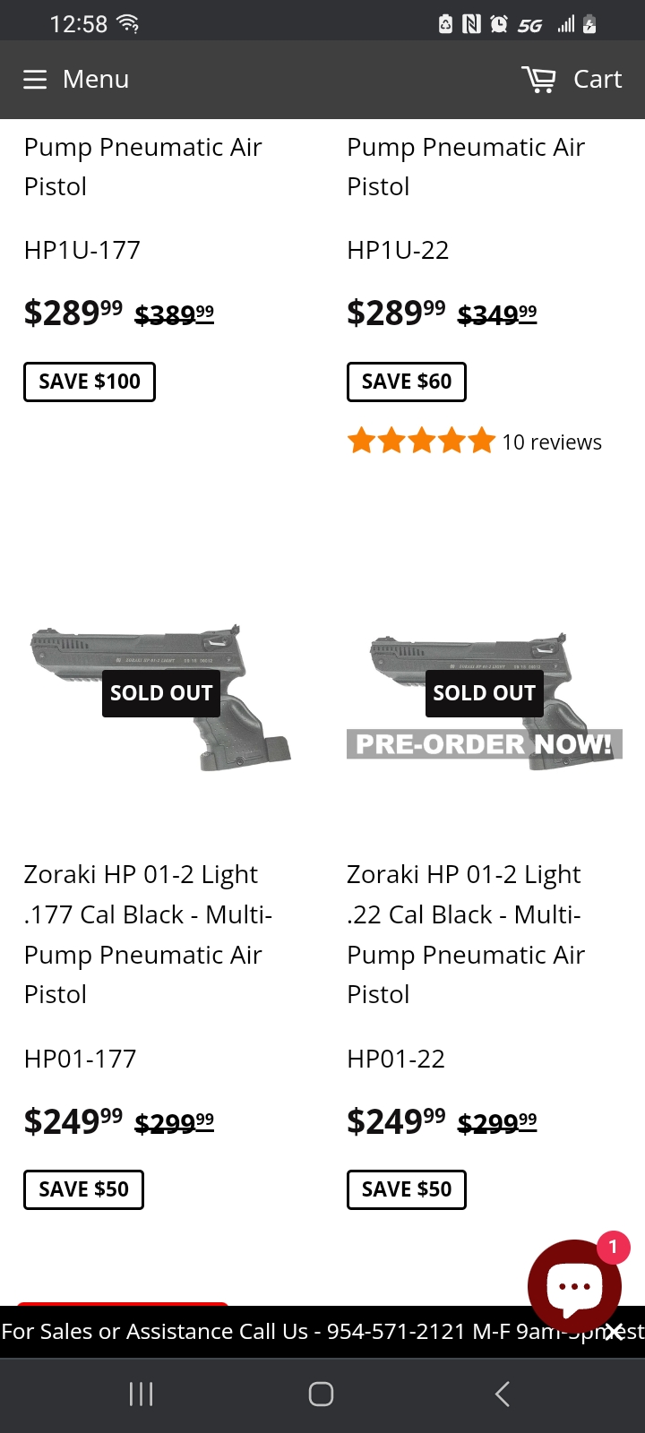

On the large side, but accurate, and powerful. Not a spring piston, but a pneumatic. So, recoil is non-existent
Also have short barrels and other calibers. Some are available for pre order. These guns are very good and any time a shipment comes in, they sell quick. I've seen a number of shipments come in. These guns used to be discontinued, but there was such a demand and market for them, they were brought back. I'd buy one myself if I didn't already have so many pistols.

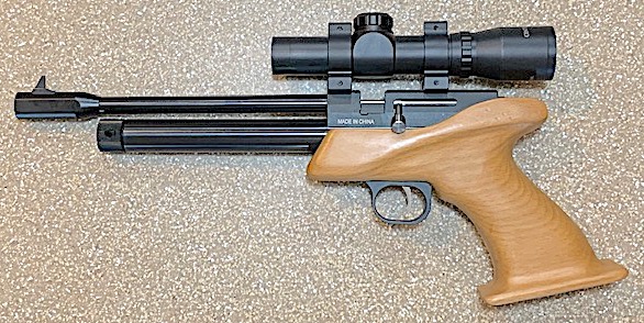

Considering "I don't want pcp", your wants virtually dictate a Co2 pistol. And assuming you're not experienced in airgunsmithing, your best choice is the Chinese-made Diana Chaser or other-branded equivalents in (less loud) .177 caliber. Those are also inexpensive enough to include a supply of Co2 cartridges.
Mine-

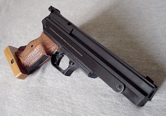

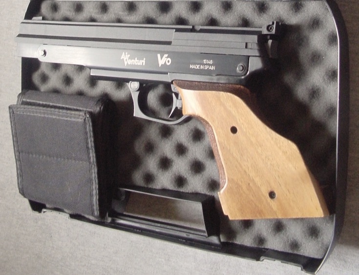

The Air Venturi V10 is sold as an entry level 10m pistol. It's a single shot single stroke pneumatic. Easy compression stroke, excellent adjustable trigger, adjustable sights, and under $300. Plenty accurate and relatively quiet. Love mine-

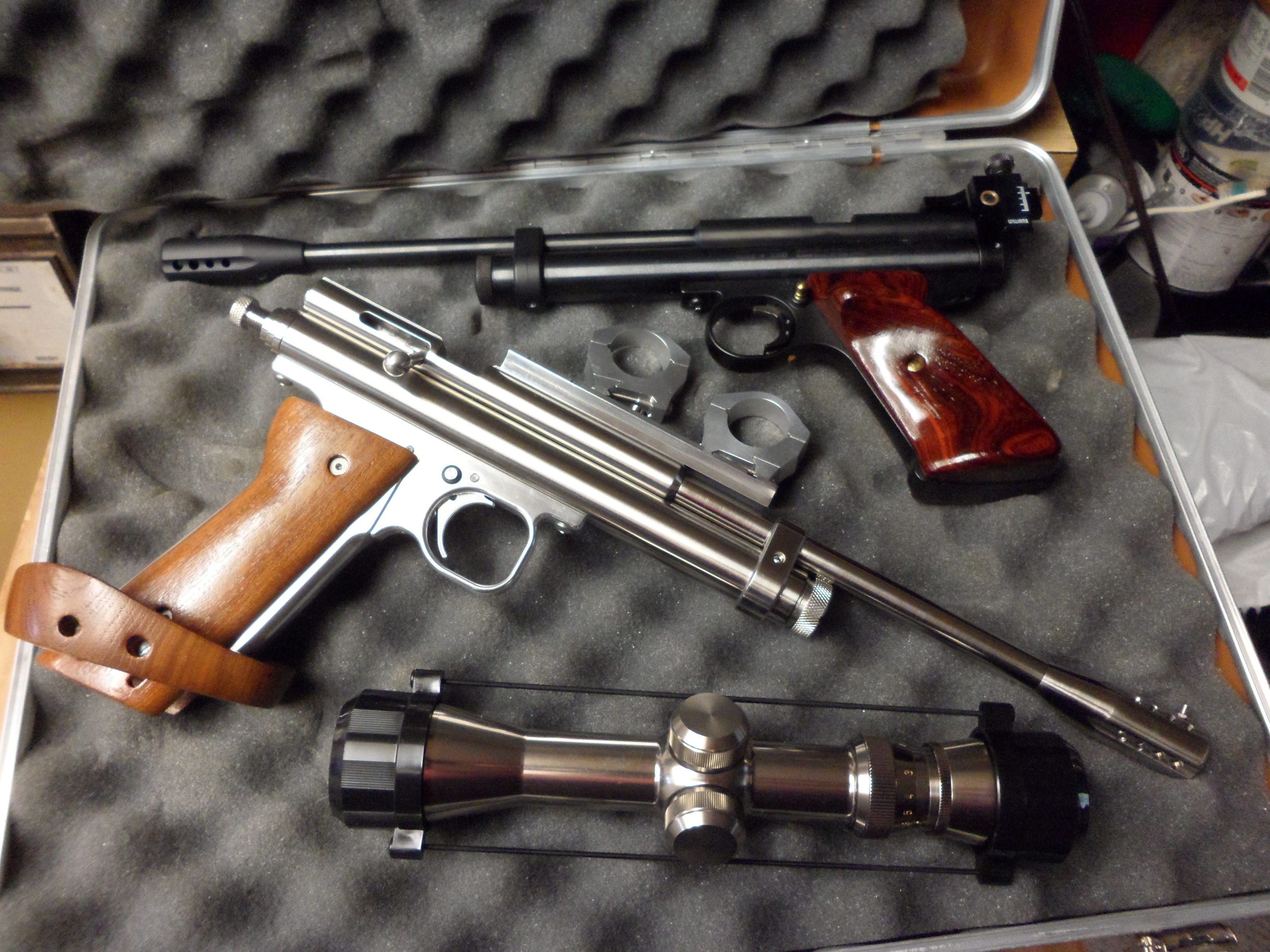

here is a custom Chaser i have 2 one in each caliber
then one that is a little different
and a 2240 that is lets say silver
a HW45 or 75 with and Alecto
so, the best pistol right now, best bang for your buck is the Chaser and get the kit

View attachment 396315View attachment 396308
View attachment 396306View attachment 396307
Weewow thats some cool looking pcp pistols

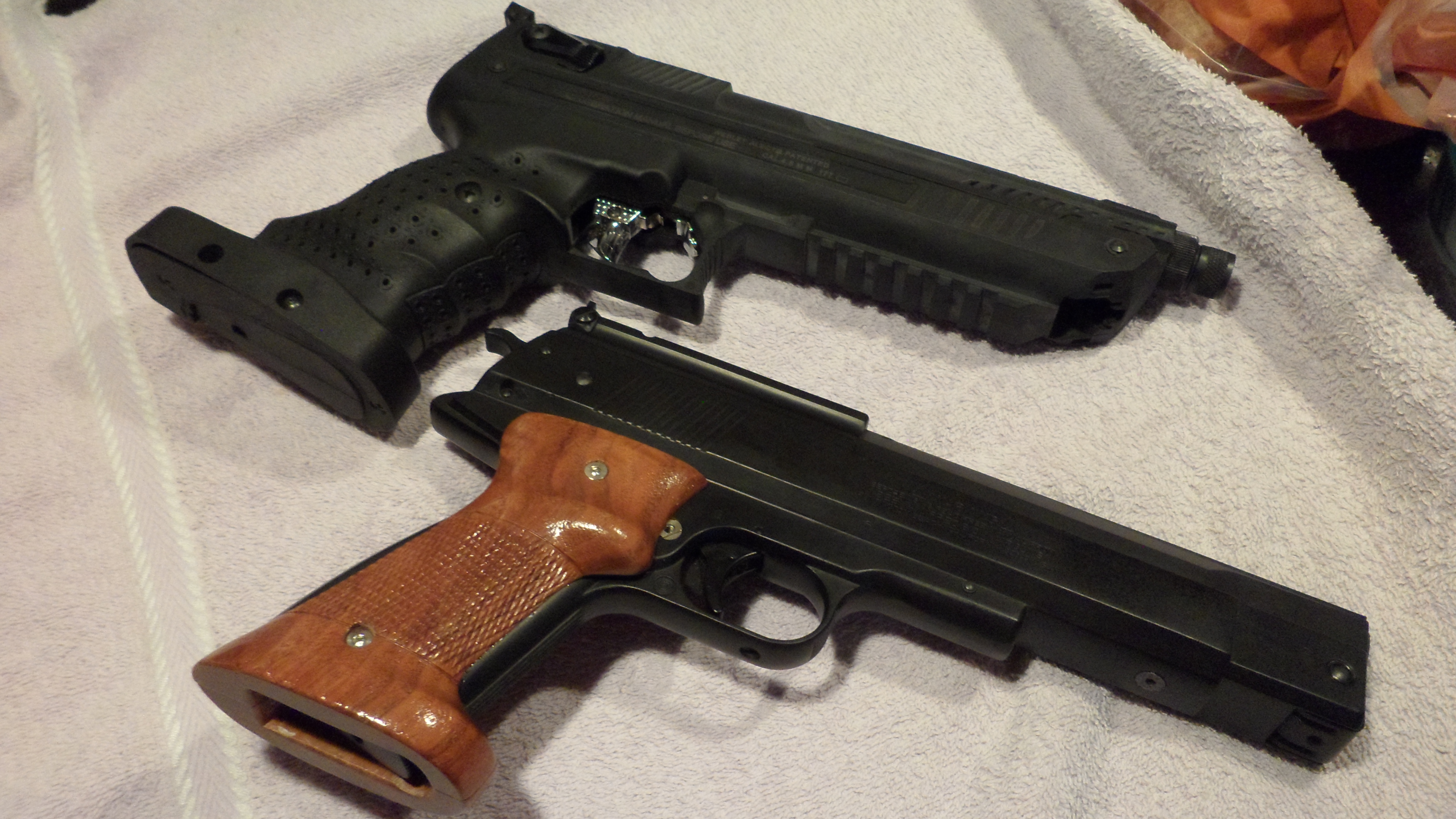

I have the P17 as well as the V10. As mentioned, they use the same type of SSP power system. The P17 has a much harder compression stroke than the V10, and is tiring for me to shoot. I prefer the V10 over the P17 for that reason. Tom Gaylord did a fairly thorough 4 part review of the V10. It may help you with your decision. The parts come up in reverse order, just scroll down a bit to get to Part 1-
