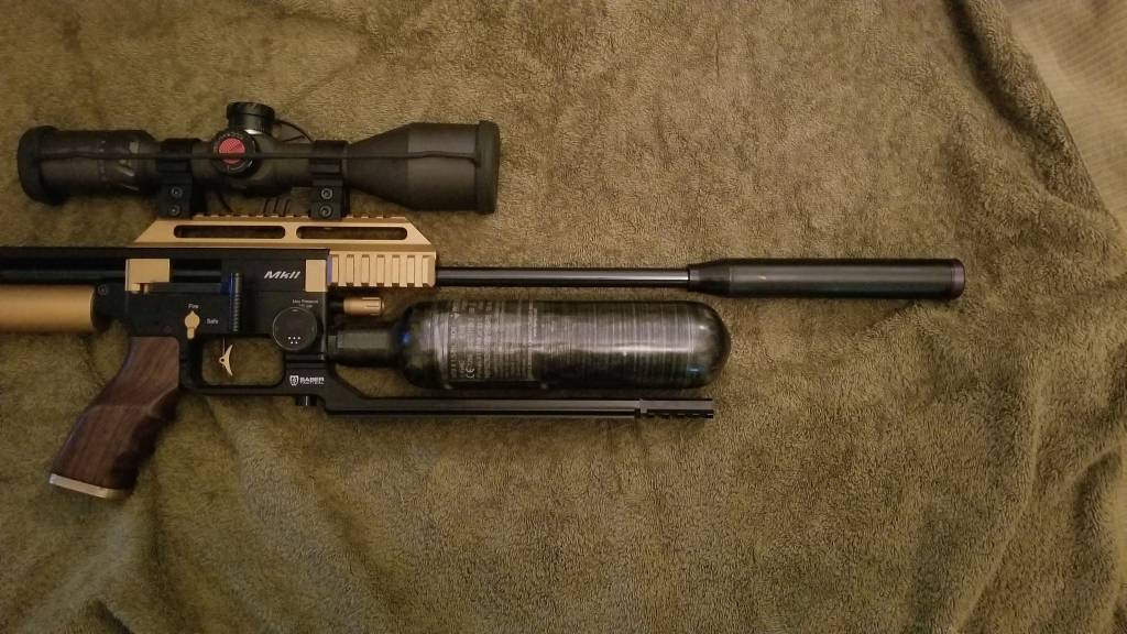

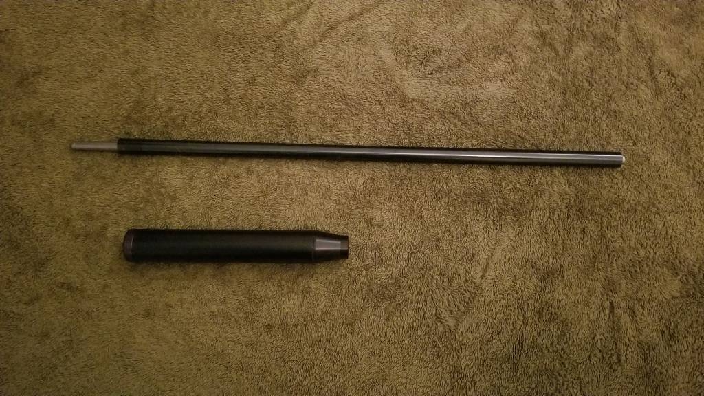

The plus side is once you have these parts in the calibers you want, to change from a 700 to a 500 all you need is a 500mm barrel house, and if you have a second shroud you can make one 500mm length. I got lucky and found a used (new) 500mm barrel house and got a "compact kit" for around 100$
Like such
Sure thing. Lucky you though, finding a cheap 500mm kit. I wonder, how does the 500mm housing with the 700mm barrel work as you said earlier? Im sure it looks weird...
I mean like putting a 500mm shroud on a 700mm barrel looks funny. And the only thing I bought for the 100 was the barrel house, got a .22 slug liner and cut down a .25 and .30 pellet liners I wasnt using to work with the 500.
